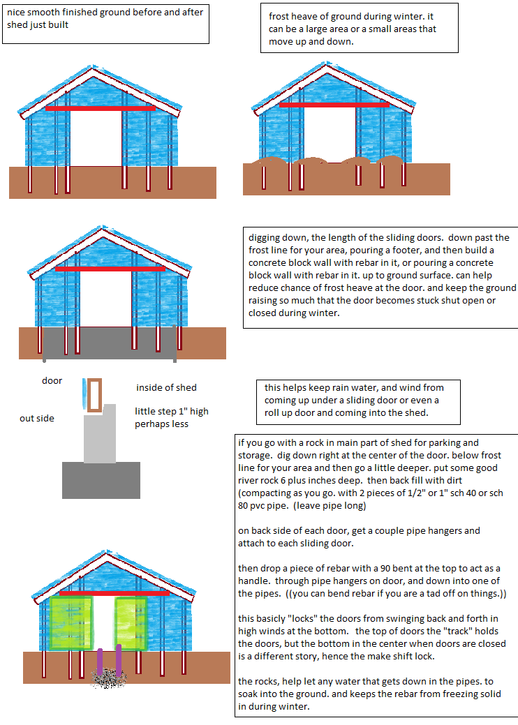

In your area due to snow/freezing, sliding doors are not a good option unless you plan to use them on a lean to area where they can be at least 4" off the ground to keep the ground from swelling up & grabbing them.
*ughs* i hate frost heave, some places i get zero heave, other places i can get up to 2 inches easily of frost heave. during winter. if i do not remove snow from doors quickly enough and just let the snow melt and then refreeze, on the sliding doors, i end up having to use a crow bar. across bottom of sliding doors. to break door out of ice. and then have to work the doors back and forth (open close) multi times to break ice away to get them open all the way. and this is with garage up on hill and good water drainage away from shed.
see attached diagram.
