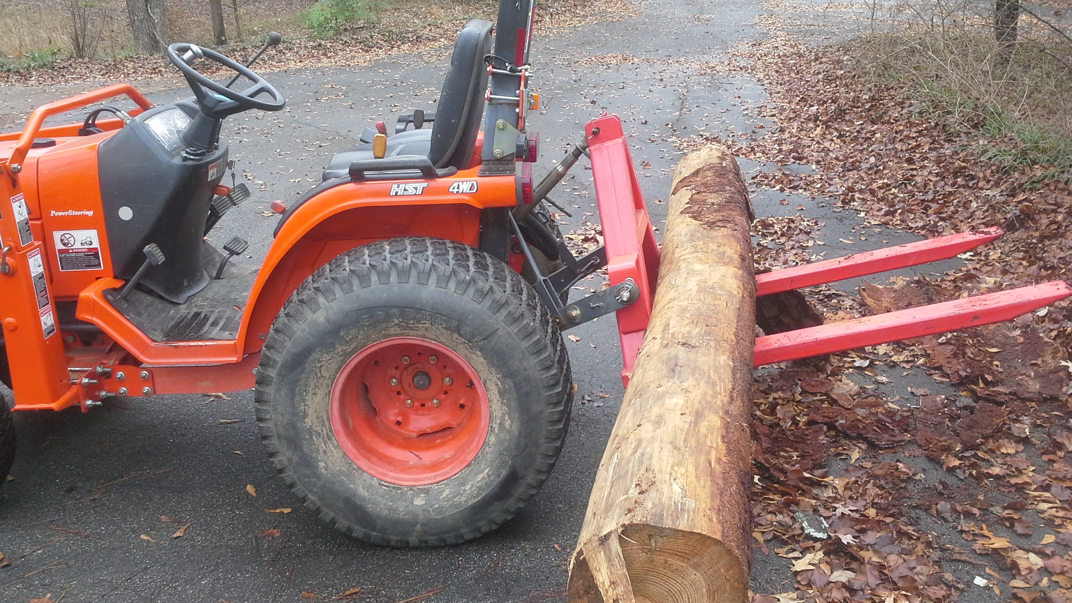

However with a log arch they could all be dragged in sections by my 23HP B7610. A grapple will definitely come in handy for cleaning up the tops, but a pair of $150 clamp on pallet forks and a chain can do that also.
Not as quick or nice, but how many trees are you going to cut?

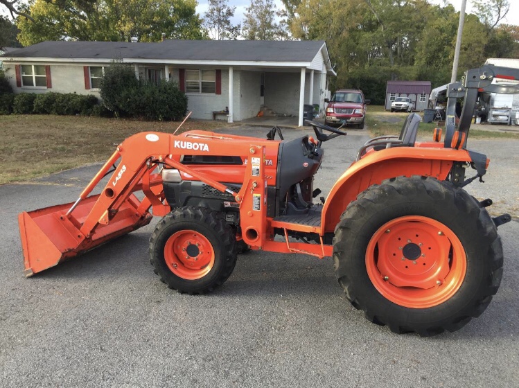

But for right NOW something like NEW HOLLAND TRACTOR - farm & garden - by owner - sale should do.

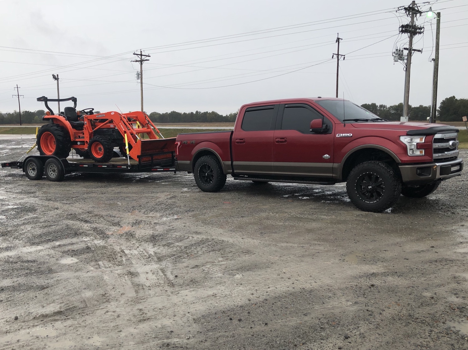

Here is a follow up. Happily found me a tractor!
I found a Grand L3130 shuttle shift with 900 hours, full service record 2.5 hours from me for $13,800. 1 owner before, a military man. He passed and his wife contacted the dealer they bought it from to sell it back.
No implements yet, but plan to get a brush cutter first ( not sure if 5’ or 6’ though) then a grapple and 3rd hydro hookup. I do have to check if the back tires are filled. If they are not I will have to get info on how to fill them.

If that's your trailer and you use if for things other than hauling your tractor I'd recommend a 3pt or clamp on trailer hitch and a set of pallet forks. You can go with clamp on pallet forks if you are not going to upgrade to a Q/A setup right off.
