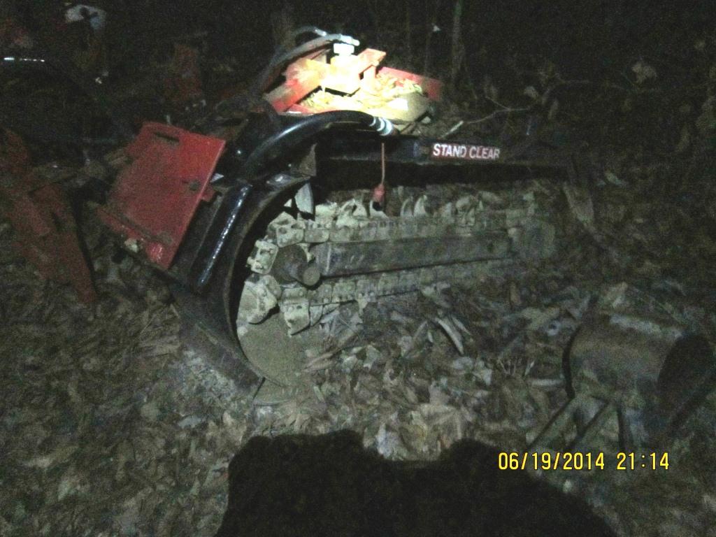

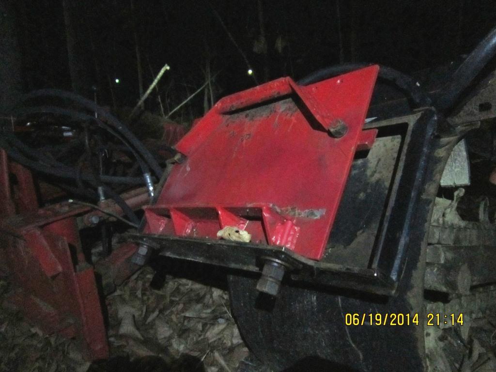

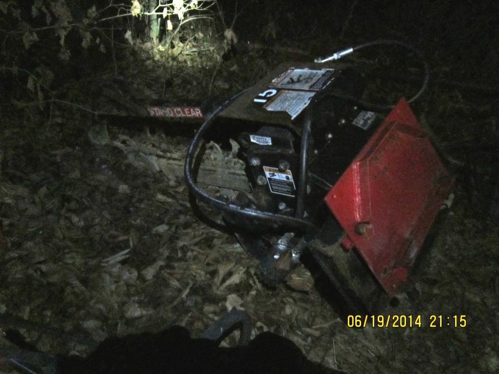

   / Plans (drawing) for 425 Quick Attach plate? #13
The nuts on the bottom don't have to be installed. Two bolts in the top and you would be ready to go.
