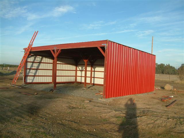

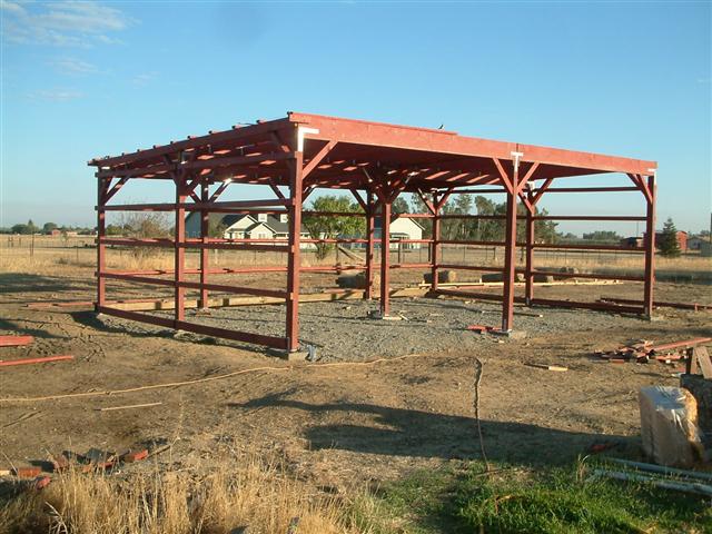

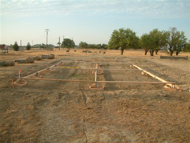

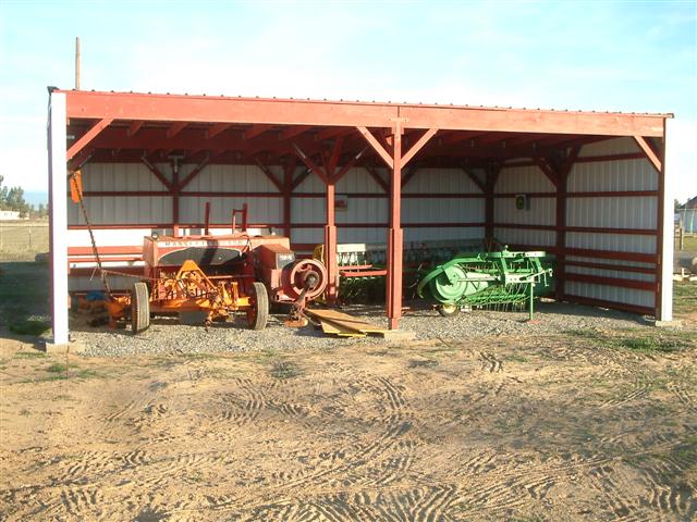

I built a 20 x 28 equipment shed about 8 years ago that's built pole-barn style (posts, beams, purlins, and 28 gauge metal sides and roof). Cost about $2.5K for materials at Home Depot.
Equipment shed posts-1.JPGEquipment shed-1.JPGEquipment shed-2.JPGEquipment shed-3.JPGEquipment shed-4.JPG
Foundation: 18x18" x 24" deep concrete with rebar and embedded Simpson post supports.
Posts: 4x6 Douglas fir
Beams: Doubled 2x12 and 2x10 glued and nailed
Purlins: 2x4 Douglas fir
Rafters: 2x6 Douglas fir
Knee braces: 4x4 Douglas fir with 1/2" lag bolts
I prefer to paint the pieces before assembly. Hate to stand on the ladder with a paint brush in hand.
