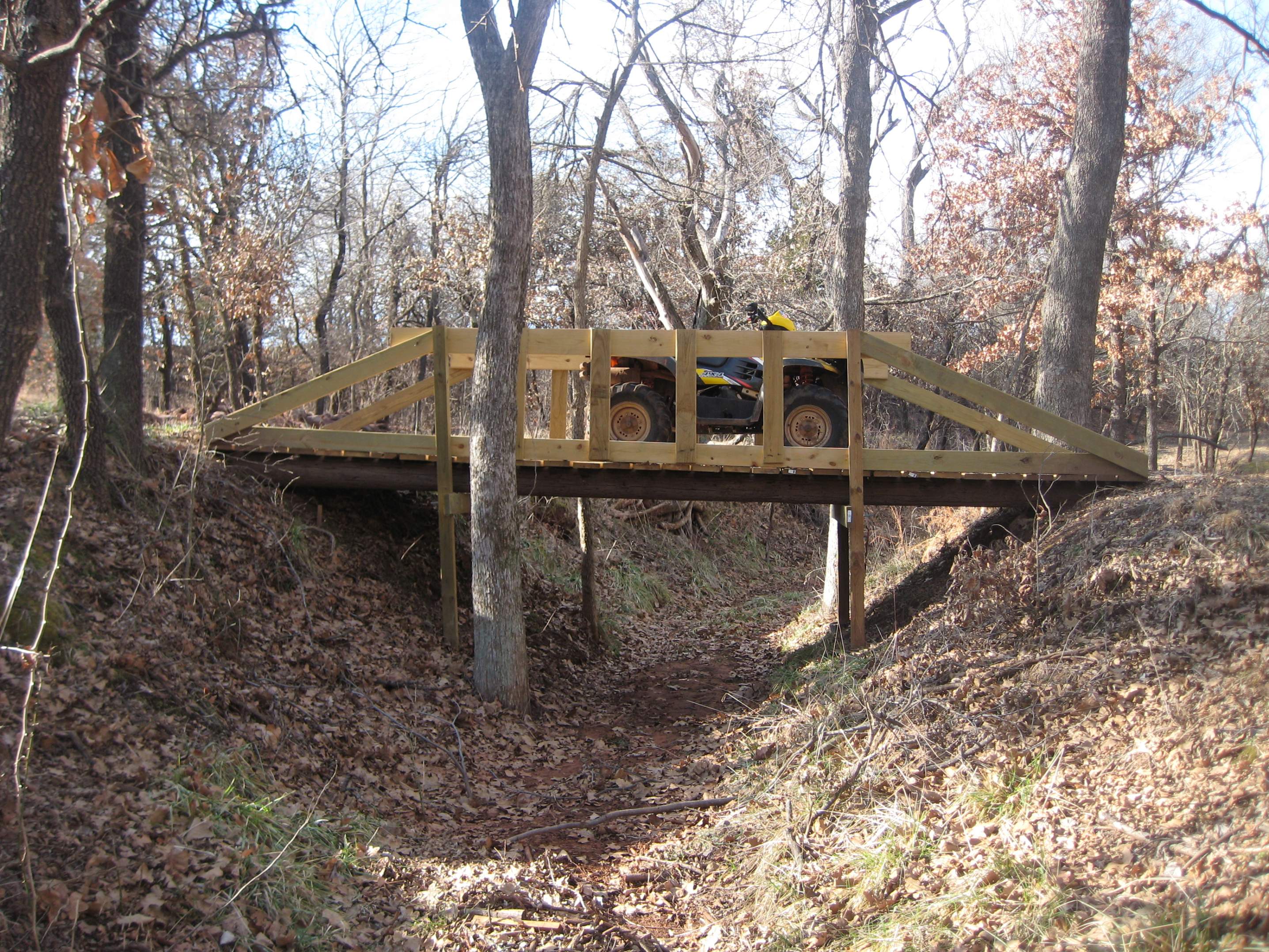

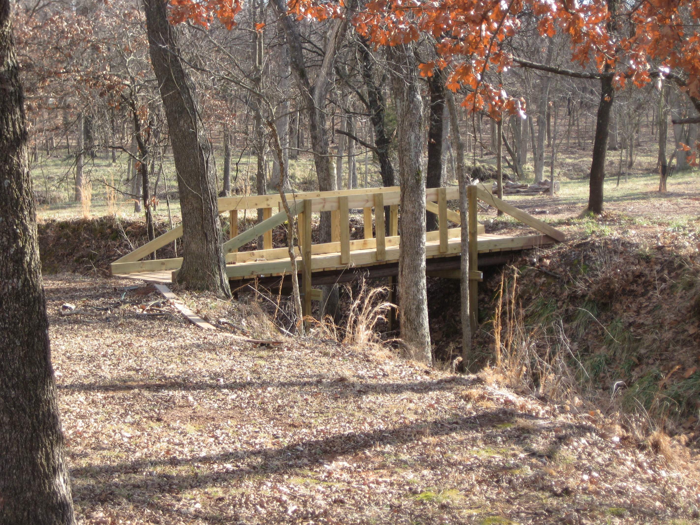

I built a wooden bridge across my "feeder stream" finger last summer. It spans about 22ft. I managed to snag 4 electric poles from a guy on Craigslist who only lived about 15 miles away, who delivered them for $100. They were about 16-20" diam at the butt-end and about 30' long. I just wanted to be able to drive my Polaris Sportsman over the bridge to my future barn-site, so I elected to only use 2 poles (the other 2 are currently being used to build a foot-bridge over my main creek). I spanned them about 4' apart to match up with the vehicle width. I decked the bridge with PT 2x8s and used counter-sunk lag-bolts to secure them to the bridge beams. I secured the beams to the banks by burying them about 15 inches down. I dug a trench under the end of each pole and filled it with several sacks of quick-crete and then ran some re-bar through the utility holes of the power poles. On either side if the bridge I secured PT 4x4x12' posts into the creek-bed then ran lateral supports the either side with PT 2x12s. This all me be over-kill for only needing to support a 800lb ATV but I bet it might support significantly more. I've debated whether to drive my JD tractor over it, but as my wife puts it, " Your not driving that tractor over anything that YOU built, at least while we're still making payments on it!"

Okay, so I snuck away this afternoon to take some pics of my bridge. The first shows the decking and overall length. The second is a shot while in the creek-bed showing the power poles which provide the main support.
