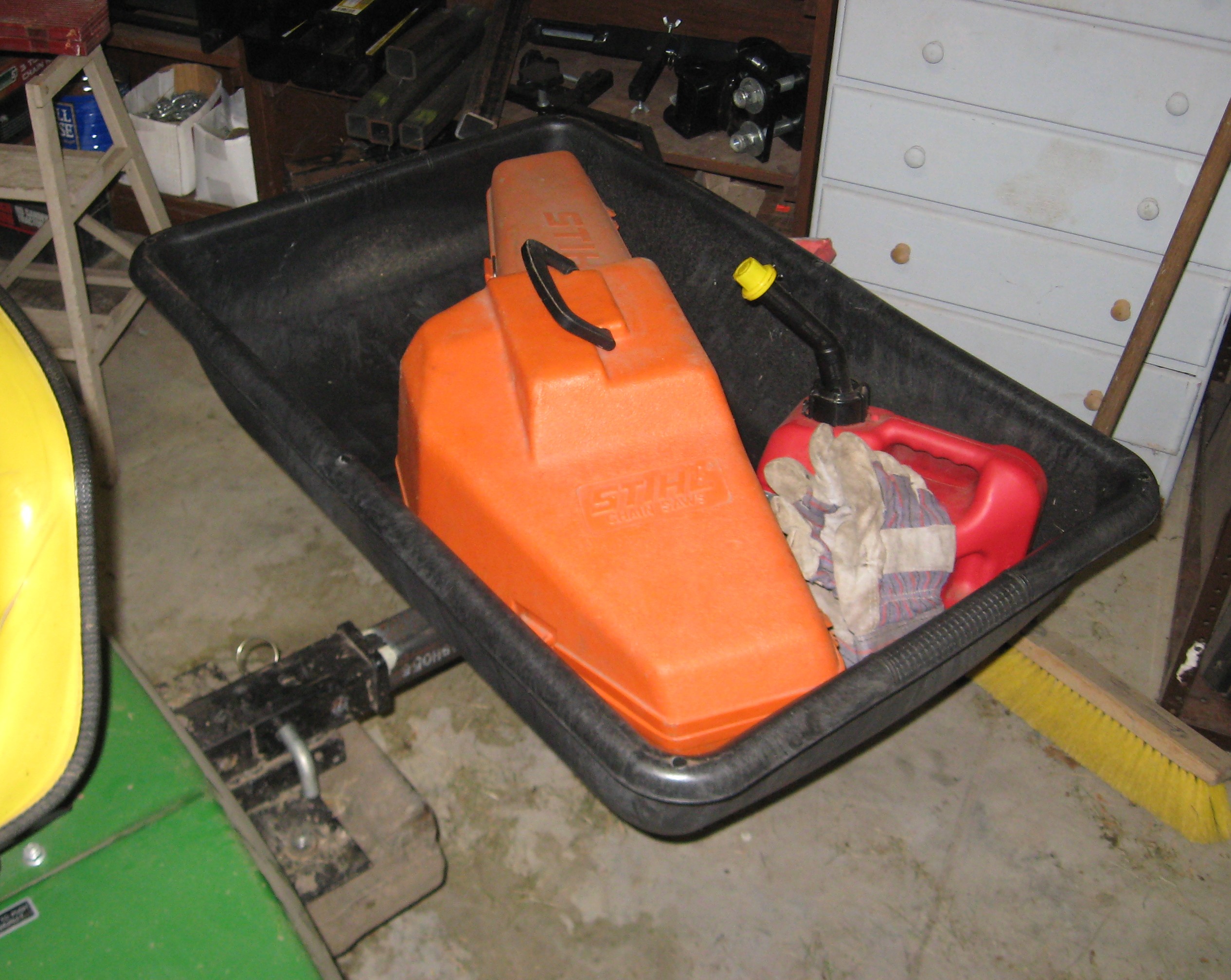

I like your idea, opens up quite a few possibilities.
I built a kind of mini-carryall to hang on the back of my lawn tractor or CUT to thow trash and what-not in while mowing, or to carry small tools, etc. I call it the tractor tub.
