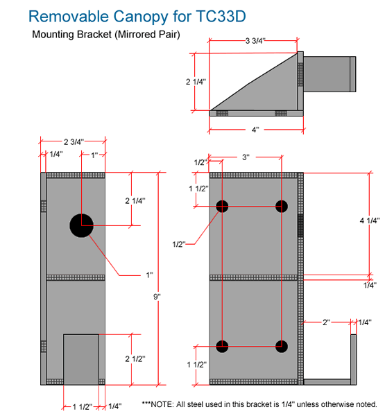

Attached are the plans for the mounting bracket.

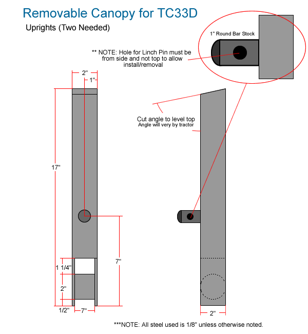

here are the upright plans

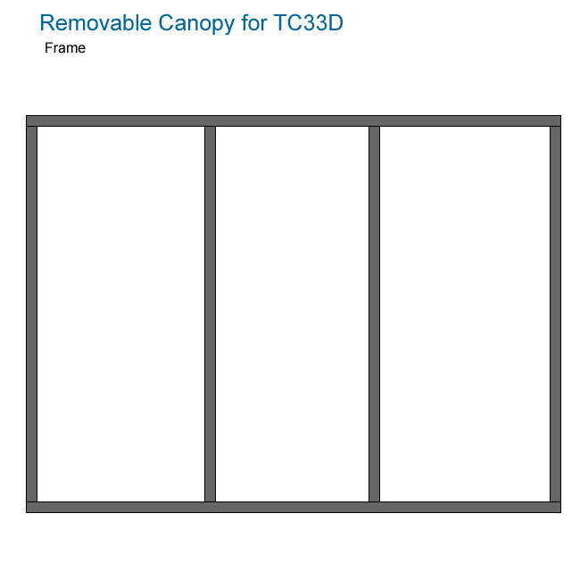

Here is the start of the frame but need some input.
Thanks again!

I'd suggest going with 1" square aluminum tubing but if you're determined to stick (pun intended) /forums/images/graemlins/grin.gif to mild steel I'd consider 3/4". either way I'd go with one cross brace instead of two.

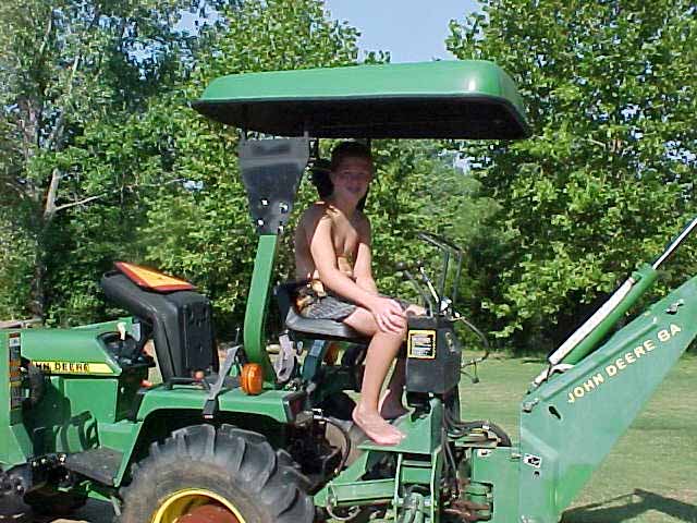

Trees are a problem to mow around here, too. I mounted my Bucktop canopy on a frame with sliders to help get closer to trees when mowing. Here's a pic in standard position.

To mow around trees (I have a MidMount Mower), I just slide the canopy back. That let's me get much closer than when it's forward.

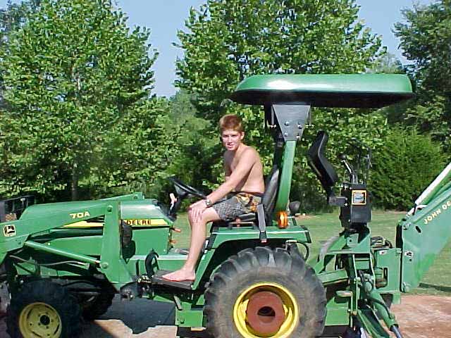

Finally, for backhoe work, I raise the canopy on risers. Lynch pins on the risers keep the canopy from lifting off the ROPS framework. To remove the canopy, I pull the lynch pins and lift the canopy off.
From your posts I can't tell for sure if you are trying to make your canopy moveable or removeable. With your canopy hinged back, if it's still too high, sliders might let you lower it some.
OkieG

Well I picked up the steel today. I decided to go with 1 1/4" 16 AWG square tubing for the frame. This will give it the strength that it needs without too much weight.
