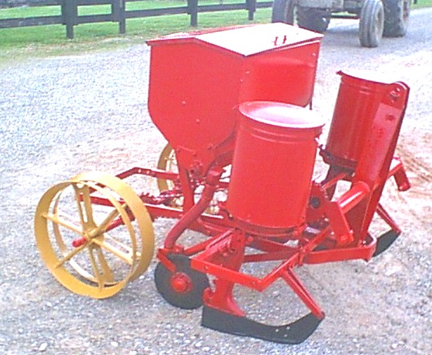

Here is a Nice Ford 309 for $1300 and a Sharp 39 Massey For $1100. Ken Sweet

That looks like a 295 International planter--I have a 1 row #295 for $595. I also have 2 JD planters coming out of the shop this week, 3 Massey Ferguson #39's, 1 Case 2 row and 3 Ford 309's. Also stock the New 1 row Covington TP46 for $1395 with fertilizer and cultivator and 4 different seed plates. Ken Sweet
