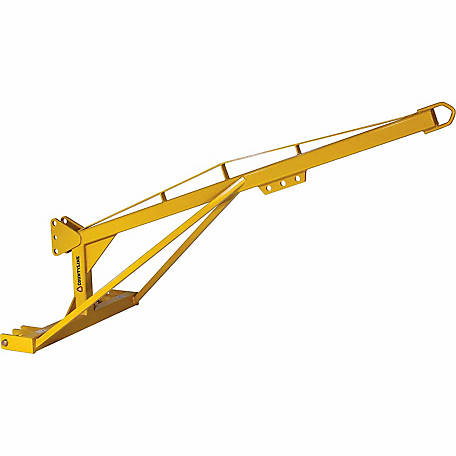

Here is the frame work to lift the chain.
I think what some people are telling you in not so many words is not to spend very much $$$ on something that is not what you really want-need.
For an interim thing to get by, maybe a few hundred $$$.:confused3: But other than that, you are simply throwing money away.:wink:
Save up and get what you want-need. Don't throw good money away . :thumbdown:
Good luck. ;)

Ooh, you just gave me a good idea. A 3-pt carry all frame could also be rigged with chains to suspend a section of chain.
For those of you that have pulled chain-link or drag-harrows over gravel before, how well does it work? Does it accumulate much material, and spill any over the front/sides? Does the chain section squirm and dance around, or stay pretty well planted straight behind?
   / Poor man (ok, cheap sob) wants a land plane grader/scraper #26
Maybe hang it from a boom pole? They start under $200 new. Used even better.
