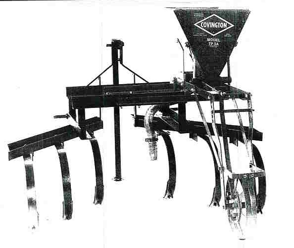

Here is a picture of the sidedresser I was talking about. Would of had it posted sooner, but had tech difficulty with my lovely computer and scanner. Imagine that! Anyway, picked up a copy of Heavy Equipment Trader the other day and found an add for the exact single row Covington planter I had discussed for $830. This is the first time I've ever seen one advertised. The Two row is going for about $2,100. Hope this helps if you're interested.

   / planting corn 101
#45
It doees. Thanks!
If everything goes ...within reason... this year I's like to add something like that to help me with things next year. I may go larger garden, too.
