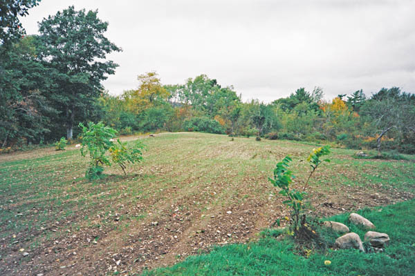

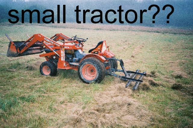

An acre isn't really that much. You can spread that amount of seed just by hand broadcasting with no trouble. Follow up by harrowing and you should be good. :D
That is the method I've used out at the Play Farm for a few years. It's worked for me with a minimum of expense. :D
My harrow is a home built contraption made from pickup teeth.:eek:
I do have a pull behind spreader but it seems to be more of an inconvenience for seeding than help.:confused:
Pictures show harrow being used for raking and a small plot that has been prepared and seeded as described above.
