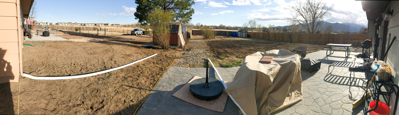

I got a 22,140 square foot (123' wide x 180' deep) lot w/2 small houses on it, and a nearby 7382 square foot (70' wide x 105' deep) lot with 1 small house on it.
Planning to plant some grass seed in the backyard in a chunk that's about 93' wide x 50' deep (~4650 square feet). If that goes well, I may do another ~5000 (123' wide by 40' deep) square feet out front and ~2500 square feet at the other site. Also a some touch-up in a couple other spots and 1-2x ~100 square foot gardens. I do have a little electric tiller that's good-enough for the gardens.
I've got a 2016 Kubota BX2370-1. I've been planning on getting the tires filled, add wheel weights, and purchasing a Land Pride BB1248 box blade.
I've been reading about planting a lawn and the articles tend to recommend a rotary tiller.
So... assuming I can't rent a 3pt hitch tiller for the BX2370, I was thinking...
Is it likely I could get something roughly equivalent to tilling by just using the BB1248 box blade on the BX2370?
Would it be significantly better (better results planting a new lawn) to purchase something like the Land Pride RTR542? I plan to purchase some good dirt and work it into the existing dead sod.
Just to complicate things -- since I'm in the initial cleanup phase of repairing the "deferred maintenance" of these properties, I've been wondering if maybe I should have gone larger than the BX2370. Maybe a B2601, or B2650.
I might be able to bundle similar implements for a discount and do a 0% deal on a larger tractor. The larger (and heavier) stuff would be great for this project, but I'm not sure how much they'd really be required to maintain everything once this initial work is done.

A larger tractor will only speed up the process so that's up to you. I'd go for a 3pt tiller to work up the ground then use a harrow drag to smooth and level the area. You may want to think about holding off on the loaded tires until after the job is done to reduce ruts left in the soft soil. However, if you are going to move a lot of dirt with the loader then get them filled for extra ballast.

What is growing on the existing lots.
Perennial weeds can be multiplied by rototiller. You want to kill them first
Do the lots require much grading
/ Planting grass
Last year it was pretty much all weeds across more than 1/2 of it. The rest is new fill dirt about a foot deep.
Nothing growing yet this year.
I wouldn't say a LOT of grading, but I've added about 15 yards of fill dirt to address a negative-grade issue and have been trying to smooth everything out by back-dragging the bucket on the BX2370.
Thinking grass from slab to slab, and out to the red shed, then as far back as the disturbed dirt on the right (about 1/2 way back).

Use box blade for final grading.
I would skip rototiling
Seed and mulch the area

I rented a pulverizer with a gear box connected to the roller (not a harley rake) you do not need a rear remote for this attachment. I did a half acre in my front yard around my garden. It worked like a champ. All I had to do after running the pulverizer over it and leveling everything out was throw the fertilizer, seed, and straw to it. I have a rotary tiller and it will do the job but nowhere as good as that pulverizer I rented. It cost $ 180.00 for the weekend. I would also consider waiting until September to plant your grass. The fall and winter will give it time to really set roots well. If you plant now with summer soon coming your grass seed might not take root as well and die off.

The objective of PTO powered roto-tillers and disc harrows is to mix and smooth/level soil, leaving a seed bed ready or almost ready for planting.
You cannot obtain this objective using a Box Blade or Box Blade scarifiers.

Could I maybe substitute a pulverizer instead of a box-blade and rotary tiller?
PERHAPS you can, but a roto-tiller would be a better choice.
No suface/subsurface soil mixing with a Pulverizer.
