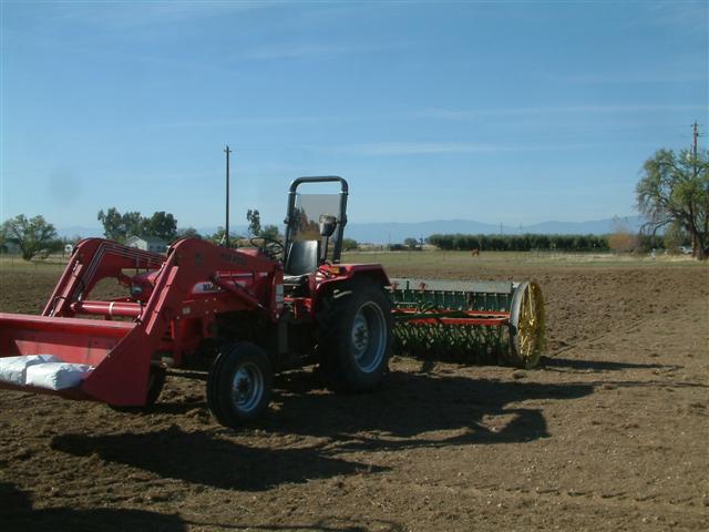

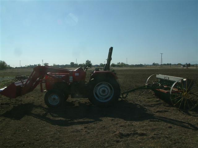

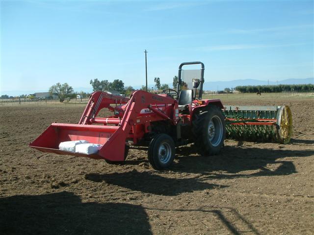

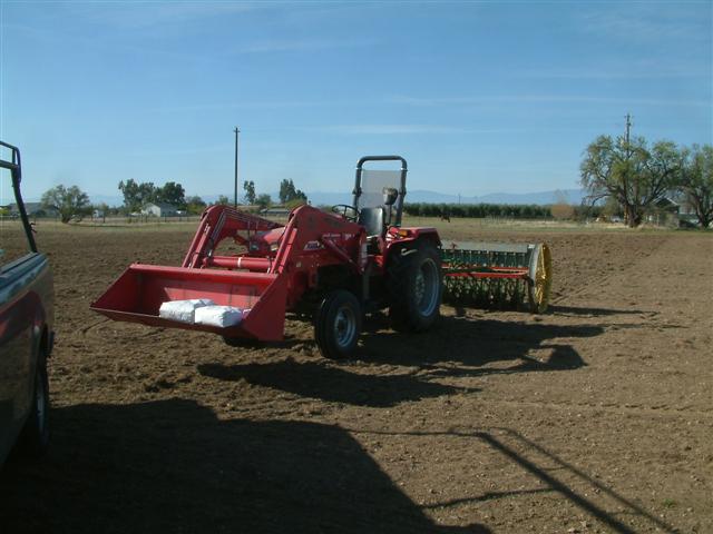

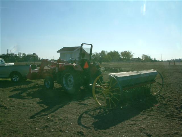

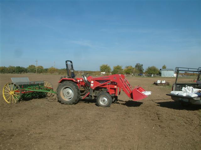

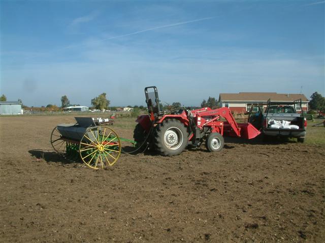

Planted about 5 acres of Kanota oats today using my restored 1940s Minneapolis Moline P3-6 grain drill (10 ft wide, 20 drops, 6" spacing, single disc openers). Amazingly, that drill worked like a champ. Pulled it with my 2008 Mahindra 5525.
Next year I hope to pull it with a 1951 MM BF tractor that I'm restoring now.
The only modification I made to the drill is adding a hydraulic cylinder (2" dia, 12" stroke) to raise and lower the openers and operate the drive gear engagement/disengagement mechanisms. Otherwise the drill is in original condition with original parts (except for replacing the square head fasteners with hex head bolts and nuts).
I spent about 4 hours seeding 5 acres, taking it easy on that old hunk o' iron. No failures to report.

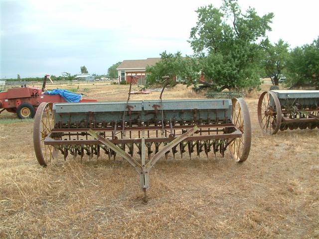

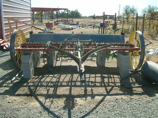

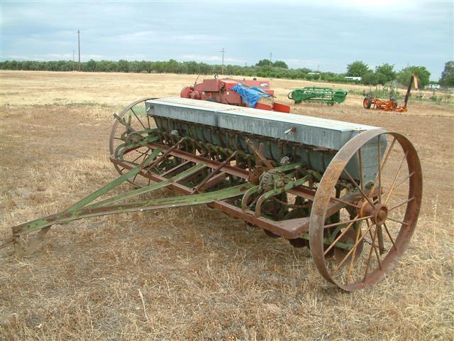

I bought two of these MMs about 18 months ago from a neighbor for $275. They had been sitting in her corral for 15 years or so since her husband passed away.
The drill were in pretty good condition on the outside (no rusted holes in the boxes, all the parts were there).
There are two axles each about 3 ft long. One axle drives the 10 feed cups on the left side, the other axle drives the other 10 feed cups on the right side.
This particular drill has a trip clutch on each axle. The operator seated on the tractor pulls two ropes when he wants to raise or lower the disc openers and engage or disengage the gear drives to the feed cups. I was going to use this drill as my primary unit but the left wheel/axle had a bad wobble. So it became the parts unit and is now a lawn ornament in front of my house.

So I decided to use the other drill which has a different mechanism and no wheel wobble. It has two long levers that are used to raise and lower the disc openers. The operator has to stop the tractor and operate these levers by hand. Pretty inconvenient.

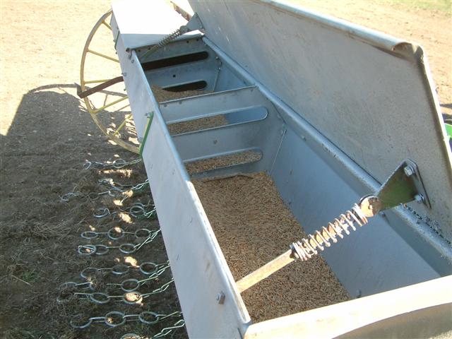

So I removed those long handles and added a hydraulic cylinder to operate the openers and gear mechanisms from the tractor seat. Much more convenient. You have to raise and lower the openers at the ends of each row on the headland to do a pivot turn with the tractor and drill without damaging the openers.
The 20 feed cups mechanisms and the openers were disassembled and cleaned. The feed cups in the larger fertilizer box were pretty rusted due to the corrosive action of damp fertilizer left after incomplete cleaning and took a while to free up. The feed cups in the two smaller grass boxes were in better shape since the grass seed left in the feeds is not nearly as corrosive.
To keep the rust from building up again, I sprayed the feed cups and the fertilizer and seed boxes with cold galvanize spray paint. I use a Red Devil battery operated dust buster to vacuum the seed out of the feed cups after use and spray the cups with WD-40 to keep the mechanism lubricated. Diesel fuel works also for this job. The drill is shedded between uses.
So it's ready to go for another 70 years or so.

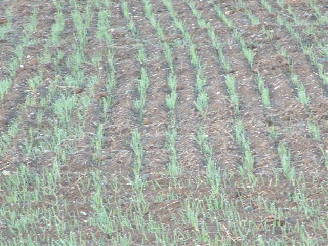

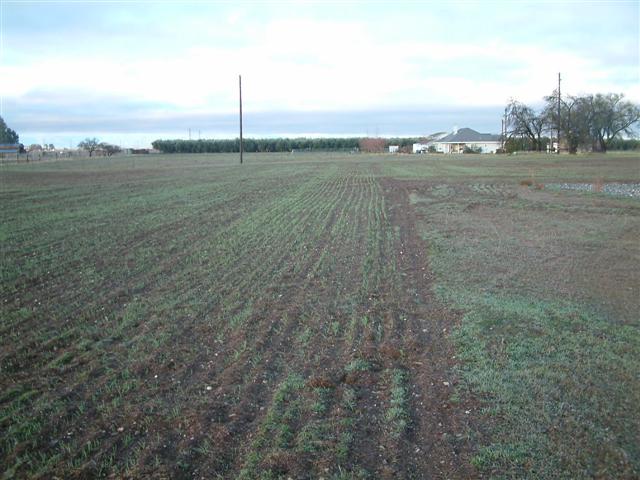

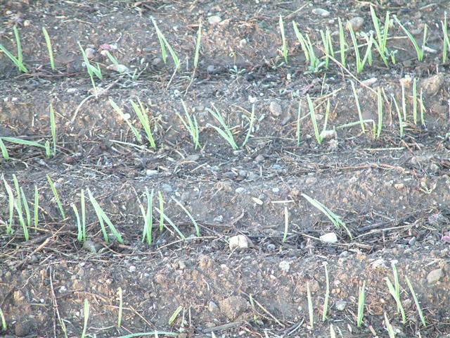

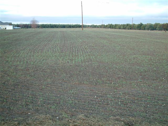

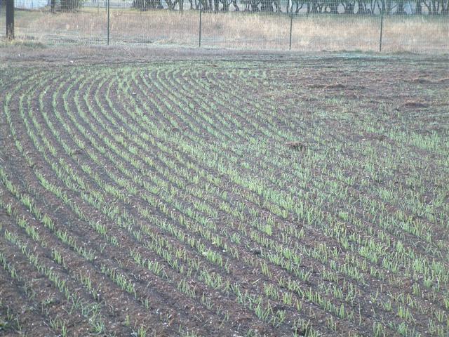

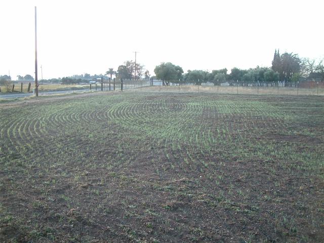

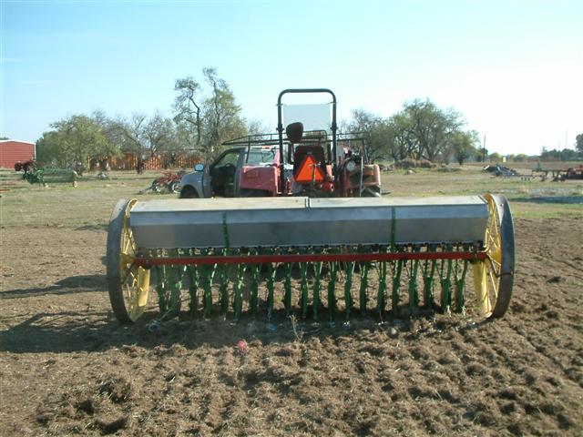

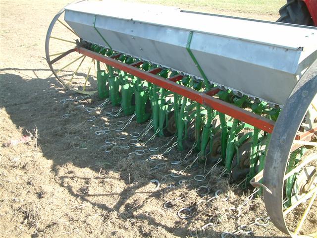

Got an inch of rain yesterday. It really kickstarted germination of the oat seed.
Looks like that old MM grain drill did OK.

I used feed oats to calibrate that old MM grain drill last Aug. I did a germination test on those cheaper feed oats--about 50%. The Kanota oat seed I planted is guaranteed 90% germination, less than 1% weed contamination in the sack. I get about 90% in my test planting.

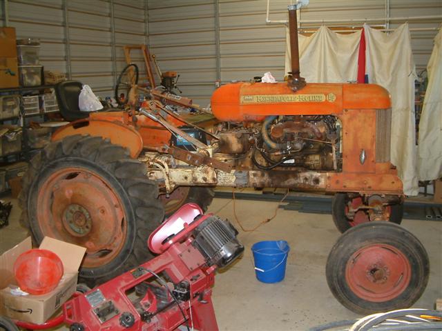

Next year I hope to pull that MM grain drill with the 1951 MM BF tractor that I'm restoring right now.

I like wide front high crop tractors like the BF. I grabbed this one as soon as I saw the front end in the craigslist photos.
This BF is a 1951 B.F. Avery model R (MM bought B.F. Avery in 1951).

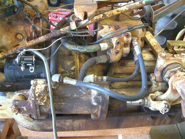

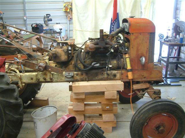

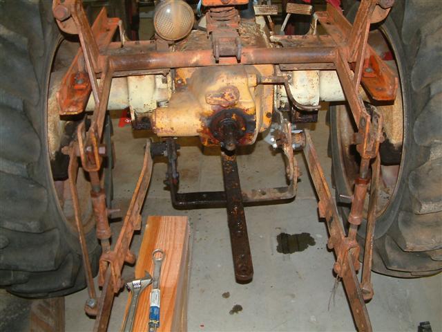

Another reason I grabbed this particular BF is that it has a 3pt hitch that's powered by the HKG hydraulics unit (pump, hyd cylinder and reservoir). All this 3pt stuff is bolt-on parts--nothing integral to the tractor like modern 3pt systems. Makes it easy to fix when the 3pt acts up.
Here's the 3pt hitch-rear view-a real Rube Goldberg contraption, but apparently it works

The hydraulic ram on the left side of the tractor
The ram and the reservoir
The hydraulic pump on the right front part of the tractor. The pump is gear driven off the timing gears on the front of the engine. The governor is attached to the same gears that drive the pump.
