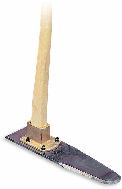

There are two specialized tools for planting bare root seedlings -- a dibble dibble.jpg
and a hoe dad 6636_69087_p1.jpg.
I guess the choice is one of personal preference, but all of the crew members that planted my tract in March used hoe dads.
