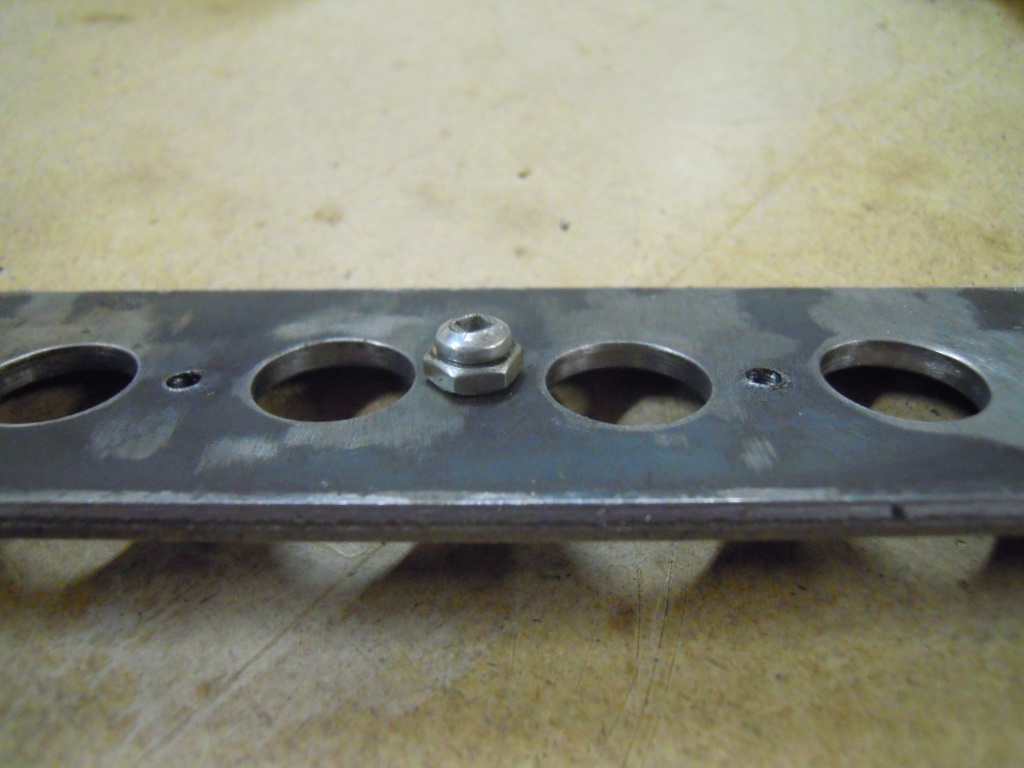

I had a need to cut some 3" and 6" diameter circles in 1/2" and 3/8" plate so I scribed a perfect circle on a piece of plate and tried freehand. Won't do that again ------ I suck at freehand. So I googled circle cutters and found one that looked like it would suit my needs and made it. It will cut from about 1" to 12" diameter circles and does a great job. While making my first practice cut (no power) I quickly discovered that if I my cut involves the circle cutter hanging over the edge of the plate it will drop off the edge of the plate and hang up when it gets back to the following edge. I resolved this by adding tapped holes between each of the torch holes so that I could put a screw on the underside of the cutter and have the head rest on the plate, behind the torch. Worked great.

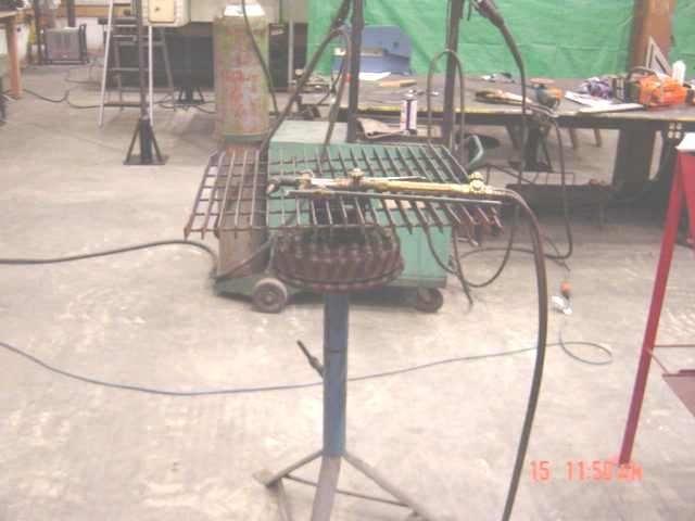

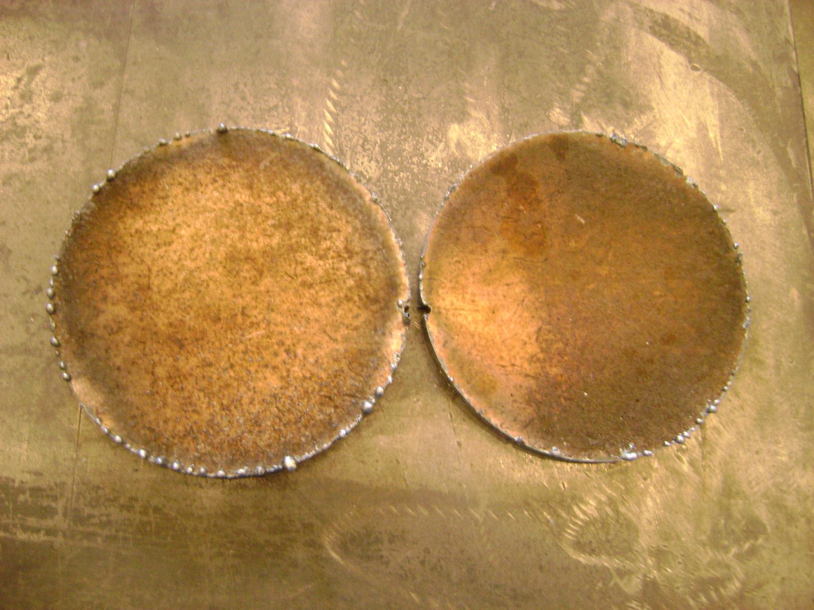

If you're going to be burning a lot of circles, one thing that is very handy is a rotating table. Take an old car or truck hub, mount it on a stand. And place some grating on top. It is amazing how accurate you can cut circles with it.
/ Plasma Circle Cutter
I got the idea / info from post #18 on this link.
Has anyone made there own radius cutter?
There are better systems but I made this because I had the required parts on hand. The center pin needs to be held in place which makes it awkward to try and walk the cutter around the circle. Your table would have made that a breeze. Alternatively I tried to stay stationary and swing the cutter around the cut, that way I would have to stop to move the hand I was using to hold down the center pin and once the pin slid out of the center punch mark when I was doing it. That is how you get an ellipse.:eek:
I really like your rotating table and that would be perfect for smaller pieces of steel. I was cutting my circles from a plate that was 8' long so rotating the plate would only work if I cut it down into manageable pieces first. If I find an old wheel hub I am definitely going to grab it and make one of those.

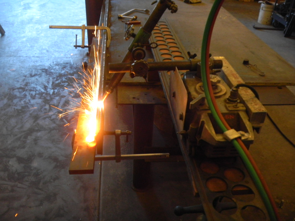

/ Plasma Circle Cutter #7

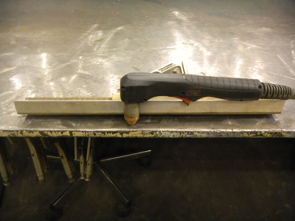

For making straight cuts, these two things work really well.
/ Plasma Circle Cutter #8
Here are my home made and store bought straight edges. Pictured in between them is my "fine adjustment" tool. :)
Terry

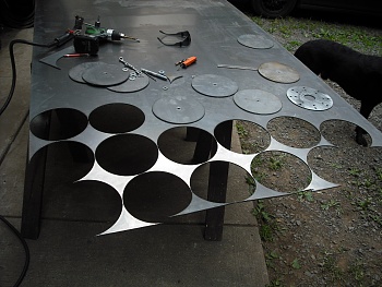

#13
You mean like these? ;)
I like that. If I make another one it will have a bearing in it like that or maybe I will make something similar. The only issue I had with the center pin is that it has to be held down with one hand while operating the torch. A good magnet might be better for larger circles and free up one hand.

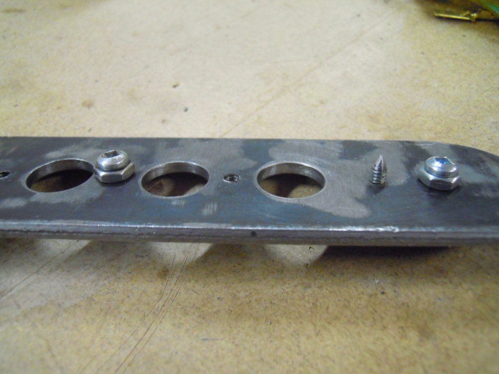

I have made a few different setups. For most stuff I use one of my handy auto torches but for large circles I use the magnetic one at the top with plasma (the tape was left over from the last circles I cut that were 36" in diameter and held an extension rod in place).
The two made from set collars, using sharpened brass screws to prevent slag buildup, I use on stainless steel and aluminum. The angled one it to allow weld penetration with minimal grinding.
The handy auto is also good for cutting other shapes and straight lines as well as bevel at the same time, using different attachments. If the project is too big to fit in my pantograph or not big enough of a job to get out the track torch.
