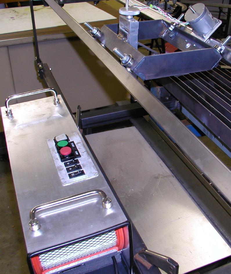

First few small parts produced. These are all cut from 14 gauge sheet steel (0.078" thick). The shapes were bent after plasma cut. The squares on the floor vinyl are 6", for scale.
I am out for better software now. Can't import files to Dancad3d/Danplot. Looking at a couple others. Hope to make the import possible, instead of drawing everything in DANCAD3d. Here's the pic...

   / Plasma cutter, automation project #25
Looks great!
Are these for a particular project or were these strictly for test? I have about a year to go before I can build my shop building. I am definitely looking forward to when I can build a cnc table.

   / Plasma cutter, automation project #27
Those are nice looking ... How did you bend them to get such a nice radius ...

Thanks. The stuff so far has been all for test and expanding the learning, and to progressively work out all the problems. I did just one thing for an actual project so far, actually some frame-stiffening gussets for the plasma table itself. They came out perfect, four of them drawn and cut in about 20 minutes, a little sanding belt time and on they went.
Bending is being done on my Chinese 3in1 sheet metal tool. It aint perfect but it works OK.
1/4 Scale stuff, yea I can see how a couple of those pcs look like truss components on a railroad bridge or something. Triangles are fun to cut, and make for lightened structures still maintaining stiffness, so they seemed like a good place to explore.
