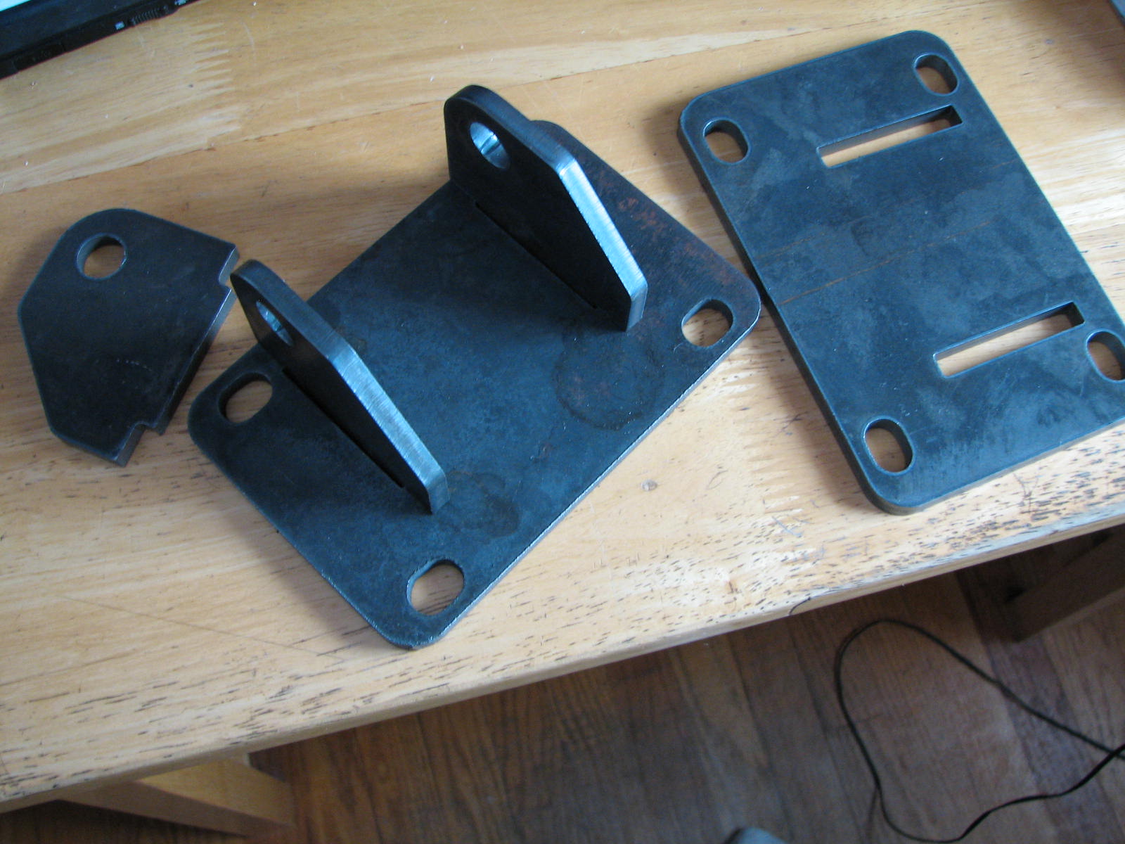

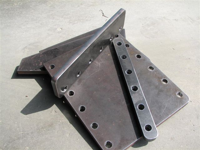

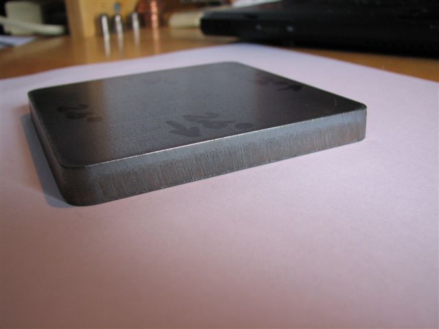

First pic is 1/4" as cut on a low cost cnc machine with an air plasma. Second is 3/8" as cut with air plasma. Third is 1/2" as cut with air plasma. Cut at the correct cut speed and correct cut height with a good quality plasma cutter gets very nice edge quality. Samples all cut on a Plasmacam cnc machine with Powermax85 air plasma at book cutting specs using compressed air. No need for oxygen here!
Jim
Jim
View attachment 388783View attachment 388781View attachment 388782

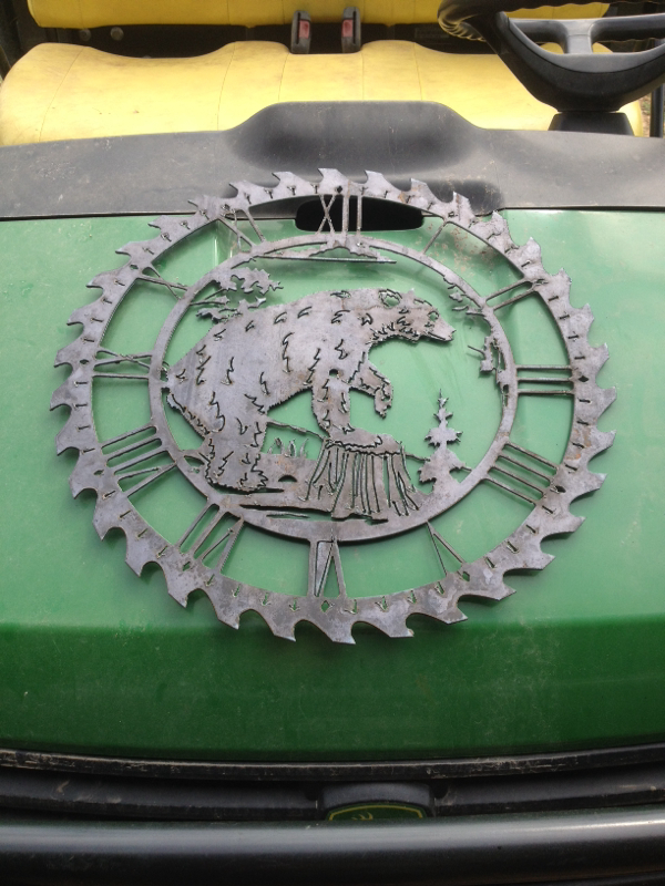

I have 2 ... A longevity 62i that is dedicated to the table and a longevity 80i that's on the welder cart
Another... I cut today ... Just one of many... getting a bunch cut out for a special Amish sale in the area

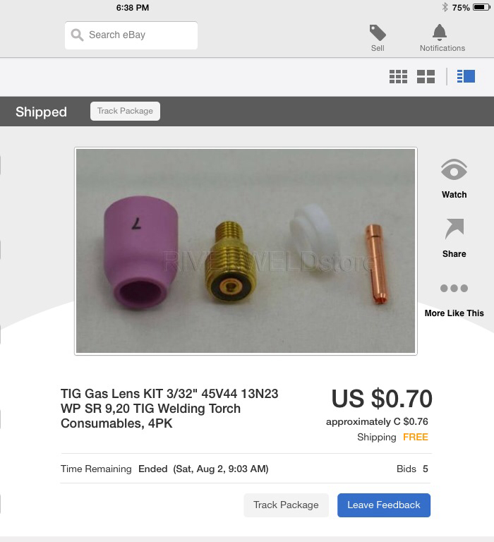

Google River-weld, if this is not your supplier. They are import and in many cases carry OEM parts. China based, but do carry good stuff and shipping is relatively fast.
   / Plasma cutting air mix #20
^^+1. This was a recent purchase for tig consumables I made with Riverweld /eBay. ] Terry
