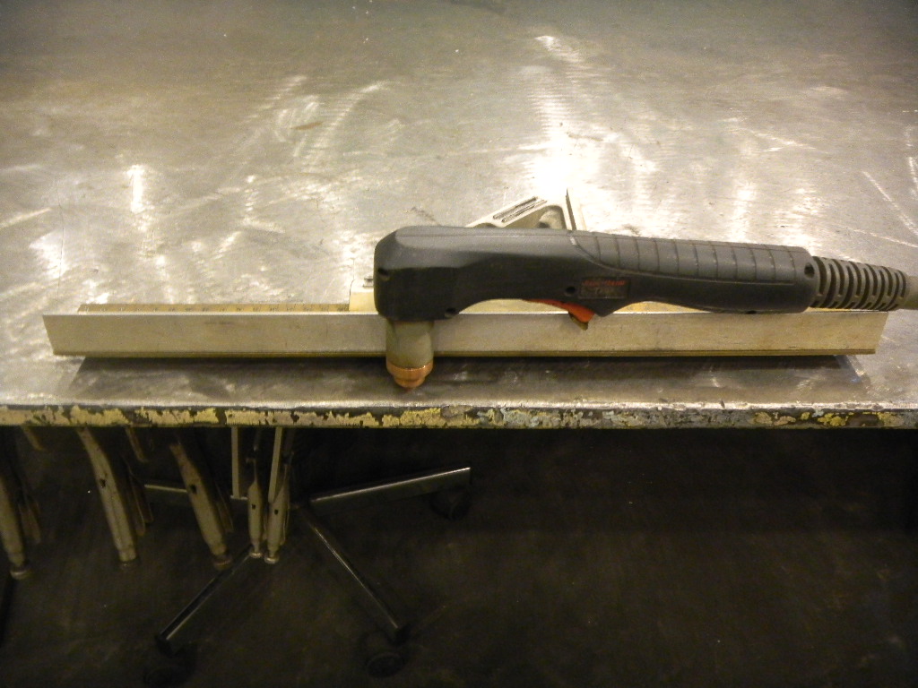

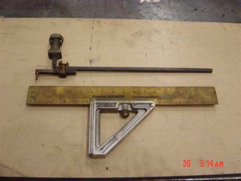

How about getting a burning square to help you?
/ Plasma Questions
Thanks SA. You just saved me a bunch of money.:cool2:
I might as well just stick to the OA for cutting, since I already have that. I rarely work with steel so I don't have much experience, although I'm getting a little now that I'm fabricating a grapple. I am using a straight edge to guide my cuts but I still don't get the speed right. Getting better but still get those nasty restarts. Between those points I'm pretty happy with the results.
Is the speed square used as a guide or to mark out square cuts? I use a square now for marking and a piece of angle for a straight guide. Is the other tool a circle guide and is it made by you or bought?

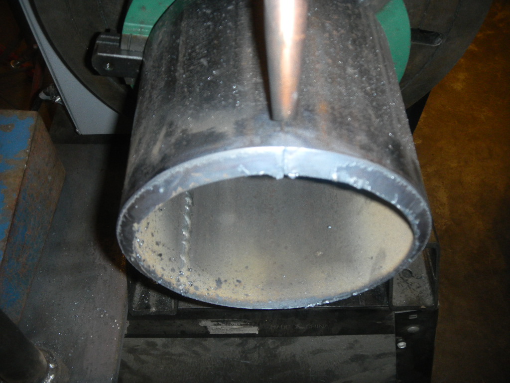

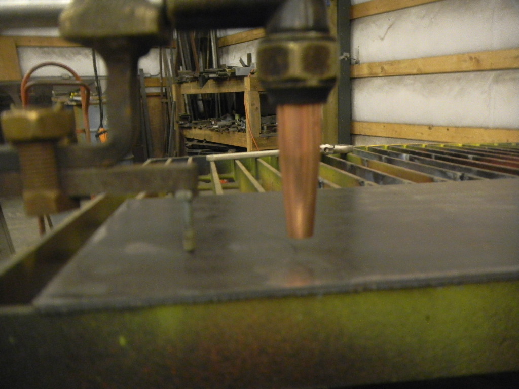

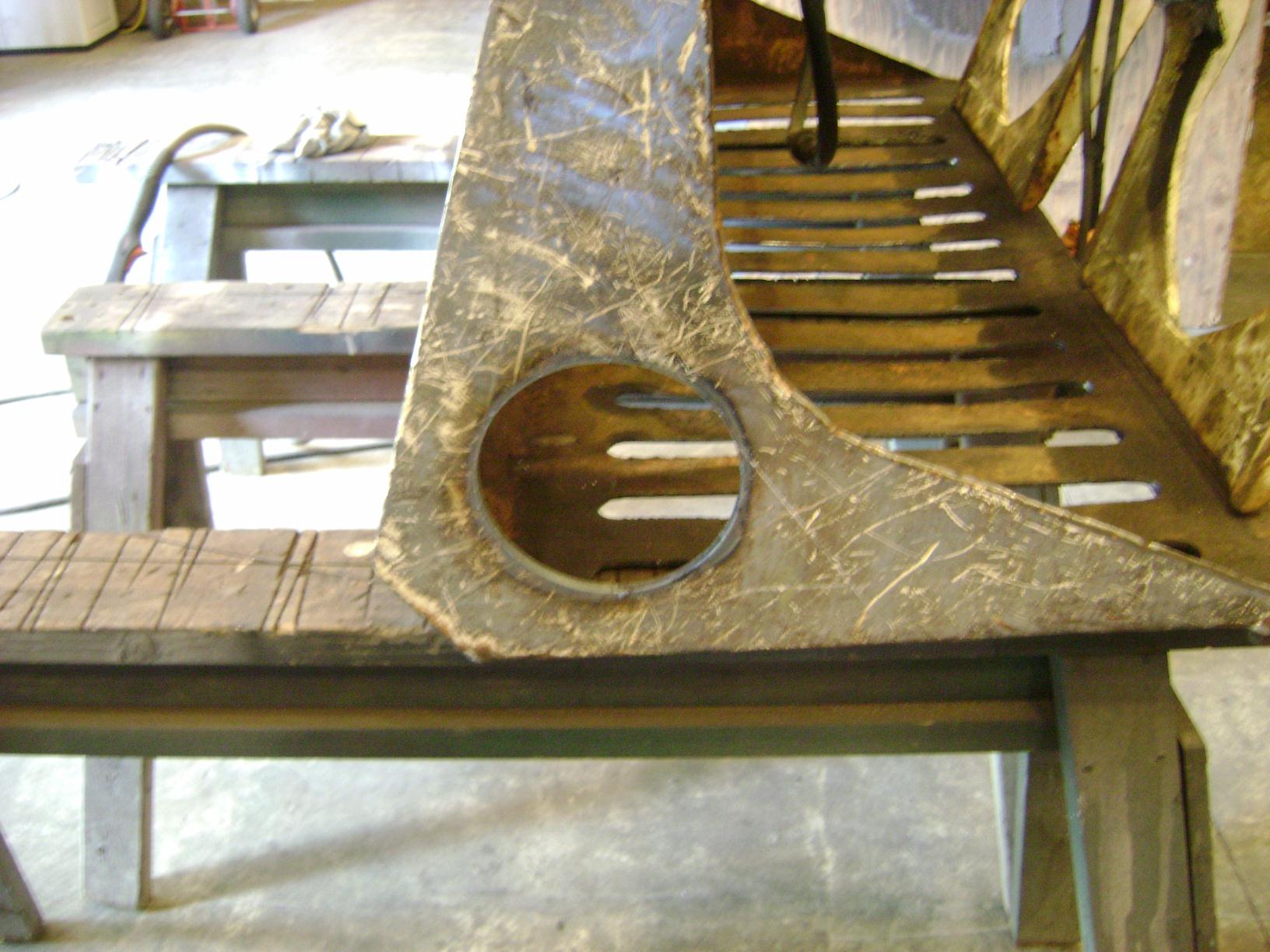

Oh I forgot!:eek: Yes I made the circle burner. I have a rotating table, I can make some nice circle cuts with it. The burning square I posted a picture of is used to hold the torch steady while burning. I added the aluminum angle for the plasma torch.

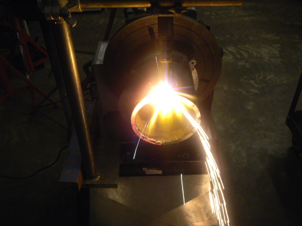

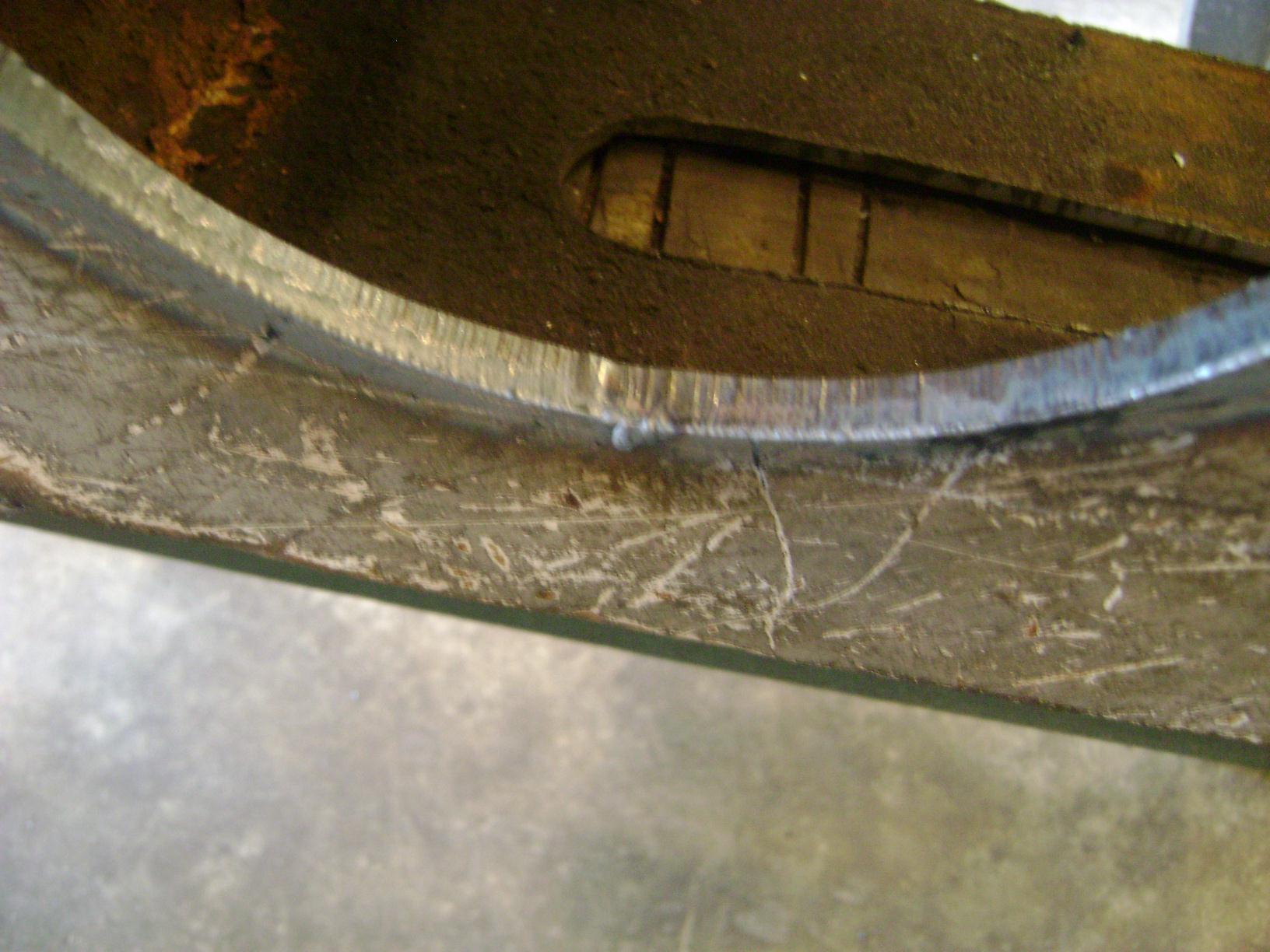

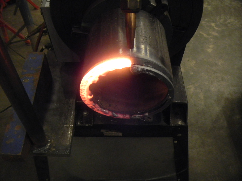

Propane does make some nice cuts.
