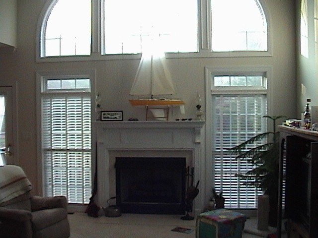

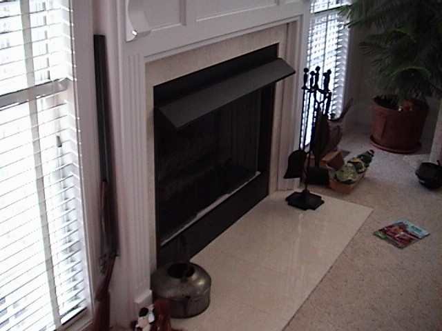

We bought a new house that came with a ventless fireplace in the living room and I installed the log set myself. After reading the directions on the log set I realized the builder did not follow the safety guidelines for the distance combustables should be from the opening. The underside of the wooden mantle was getting quite hot. What I did was install a metal hood above the top of the fireplace. Now, you can't imagine how hot this thing gets.....I accuidently leaned to close and just touched my forehead to the hood and it instantly left a burn.
In my case, the combination of the metal hood and the mantle deflects just about all of the heat away from the wall where a TV would be. In fact, I've been to a couple of houses in my sub where the builder put a TV over the fireplace. I think it looks goofy but that's what he did. I imagine a TV at that height would make more sense in the bedroom. Oh yes, I also installed a carbon monoxide detector and I never run the fireplace unless we're right there in the room with it.
My advice is to find a fireplace shop with some functional units on display and see exactly how much heat there is right up against the wall.
Jeff

And I really like what the ventless fireplace allows you to do architectually. Windows surround our entire unit.
Jeff
