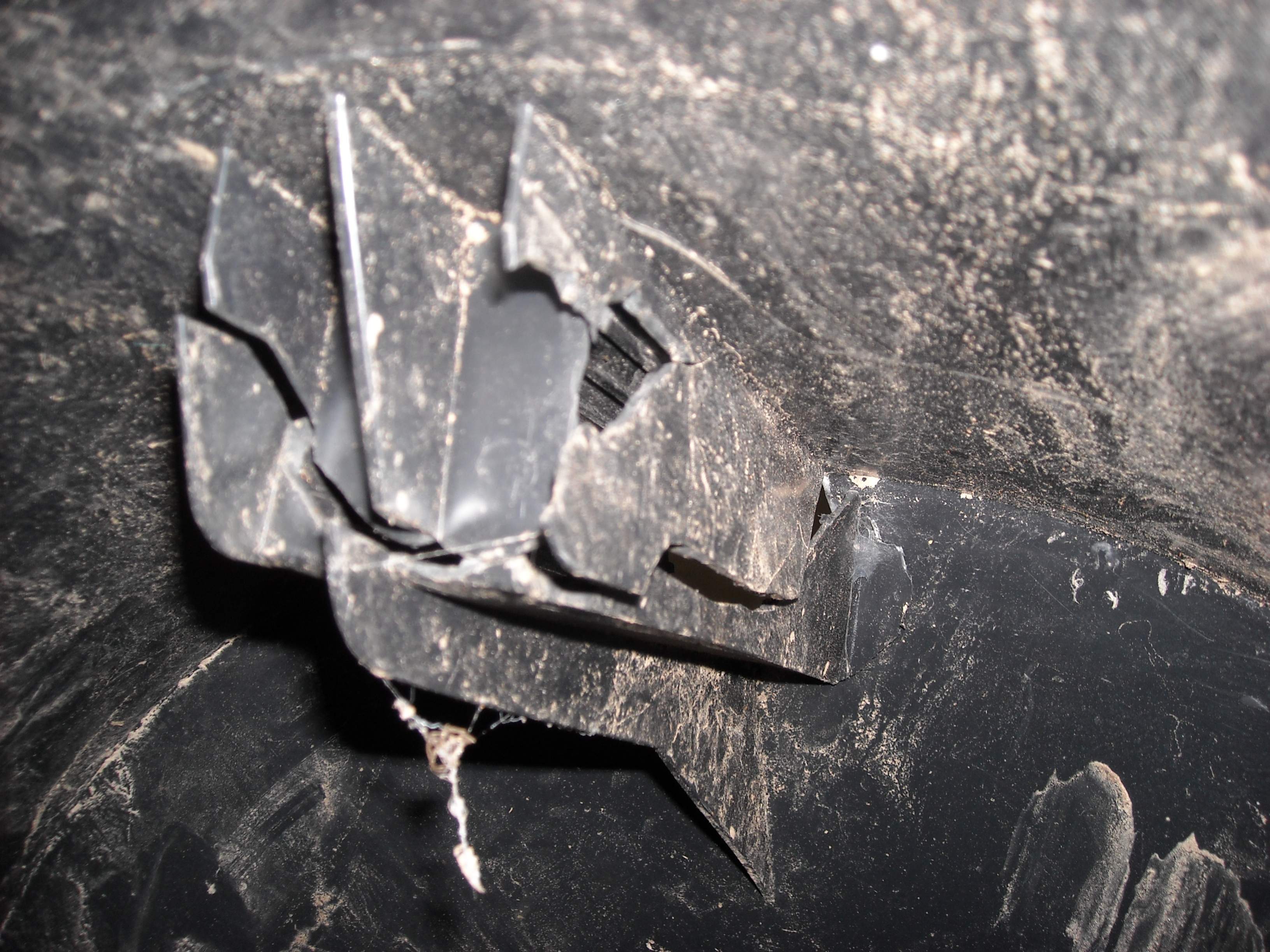

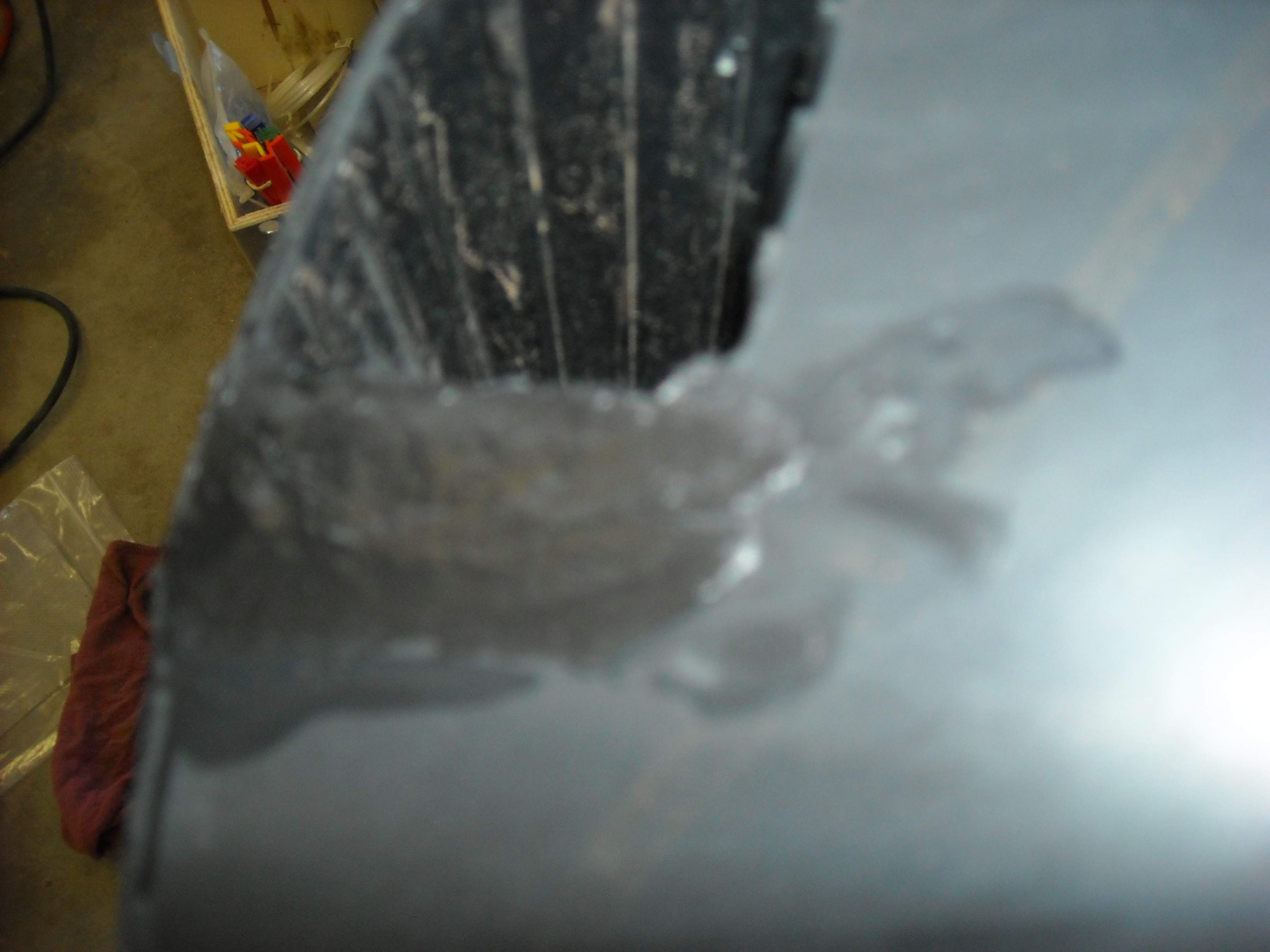

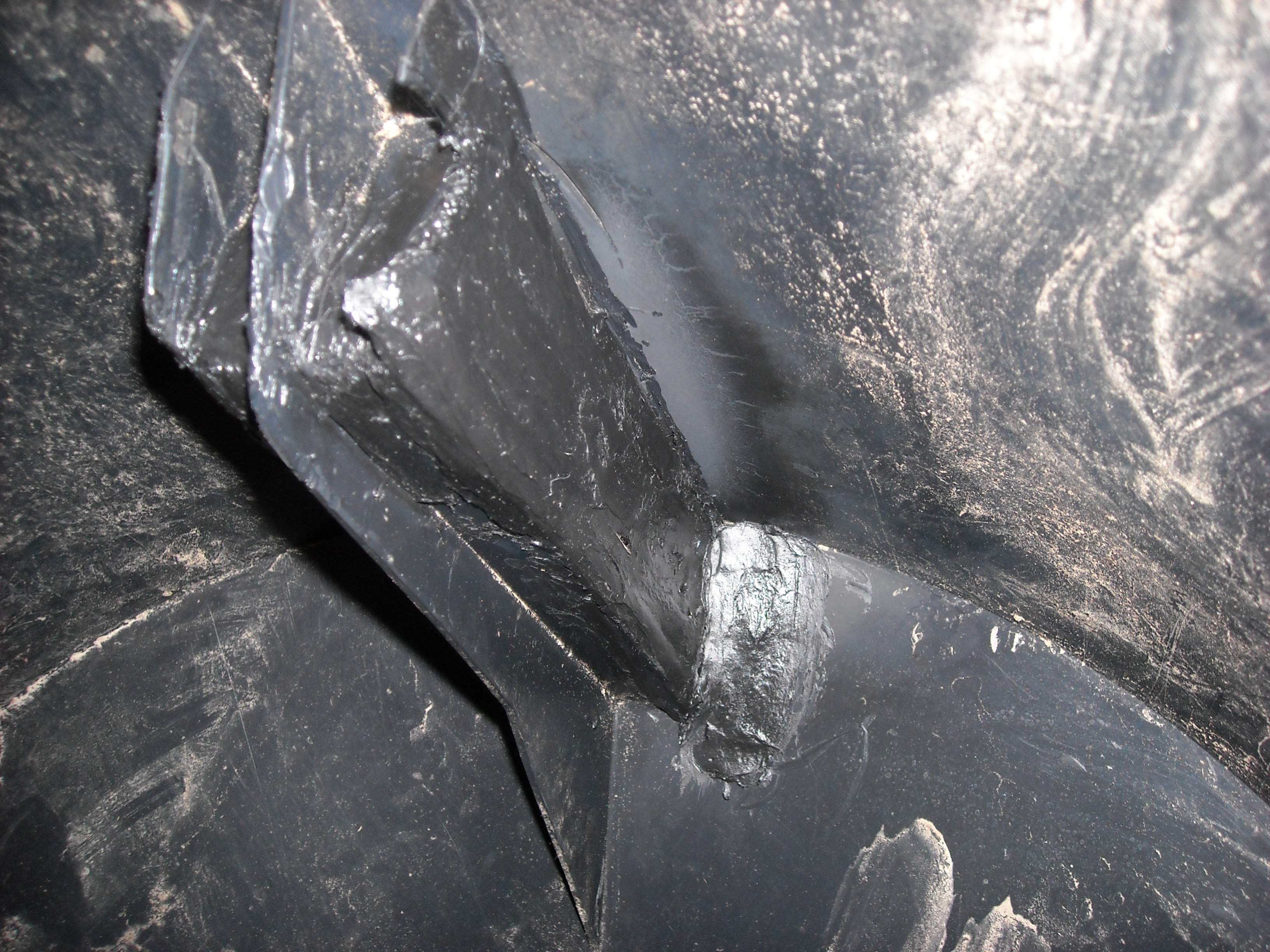

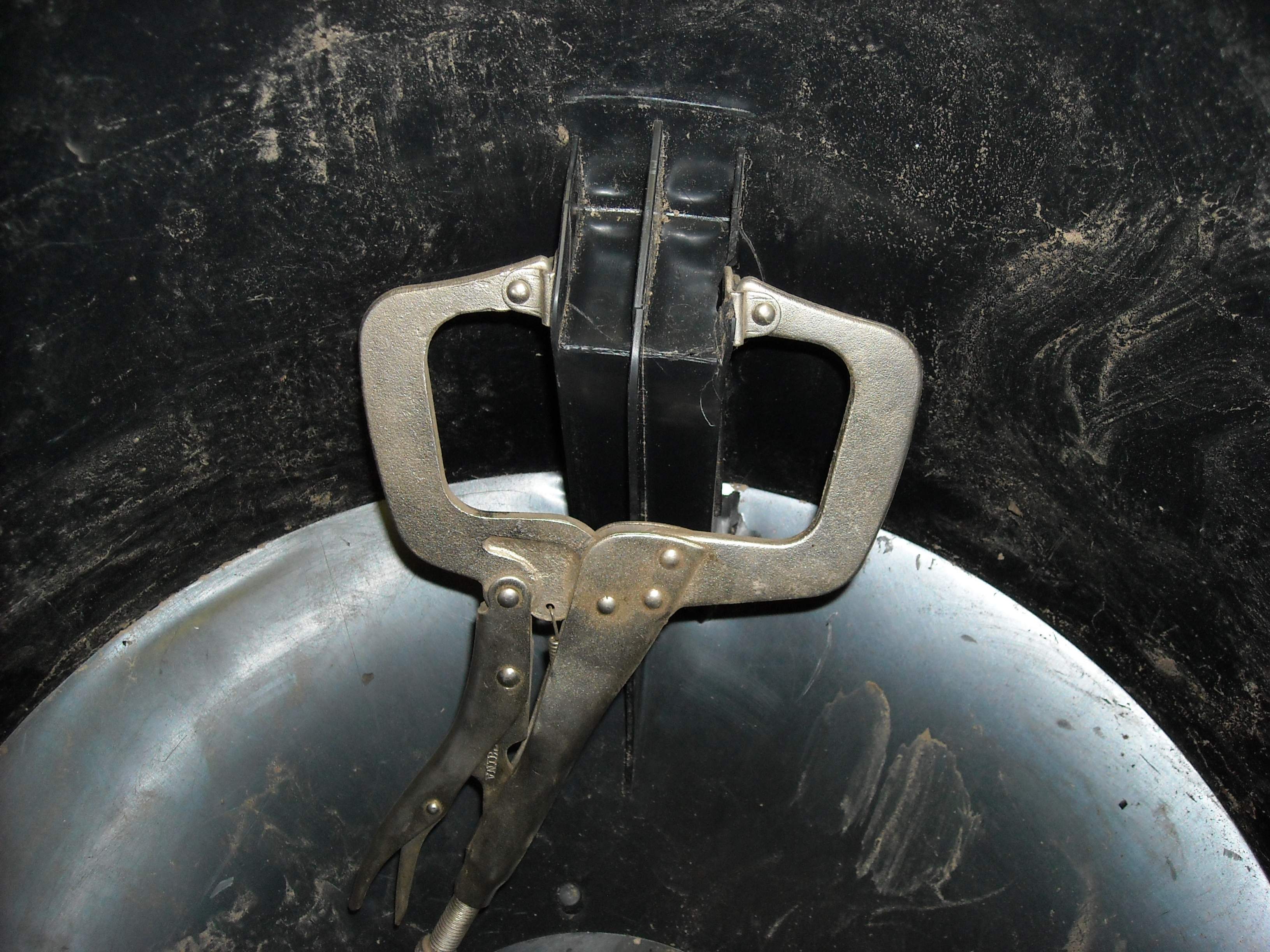

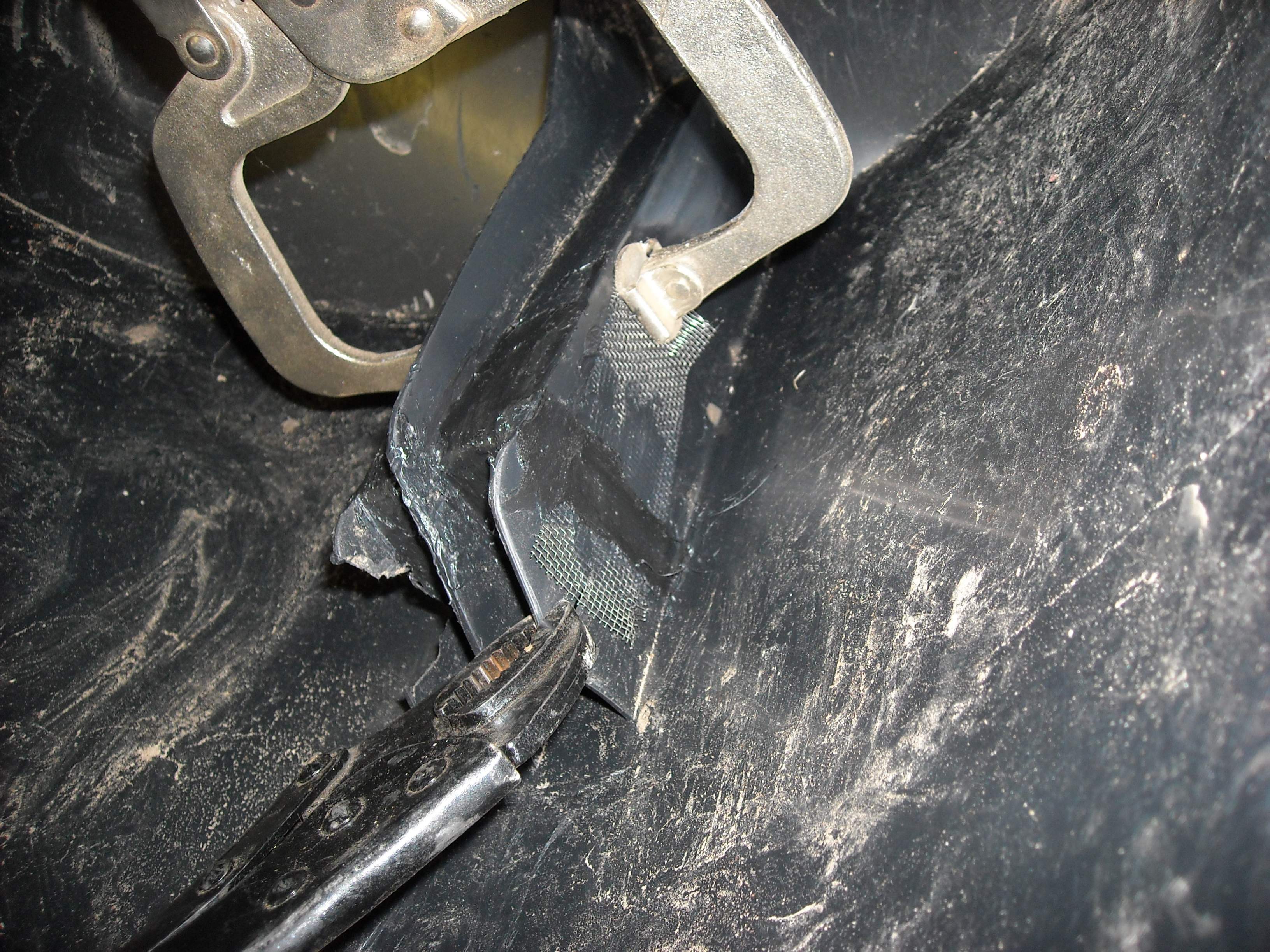

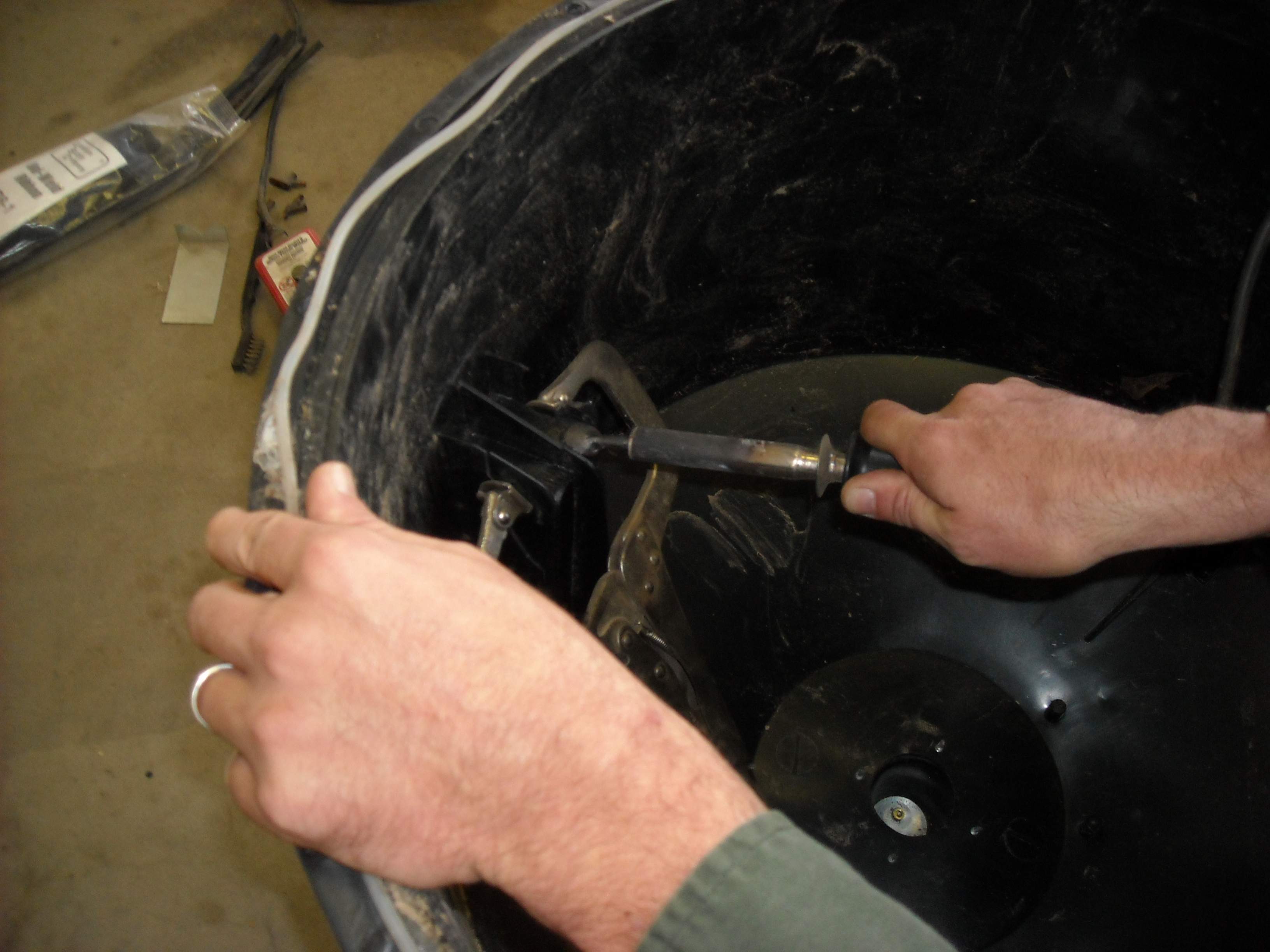

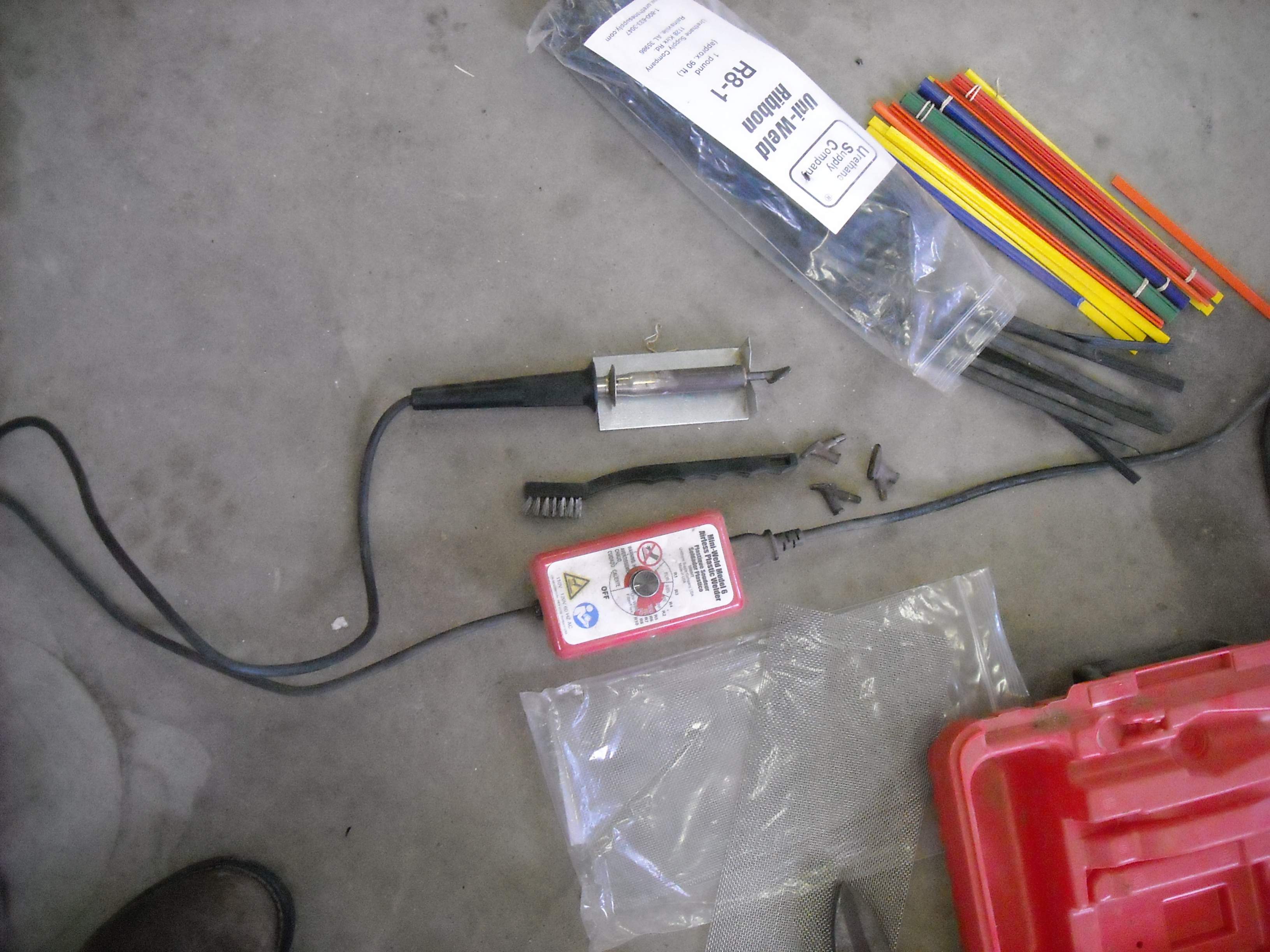

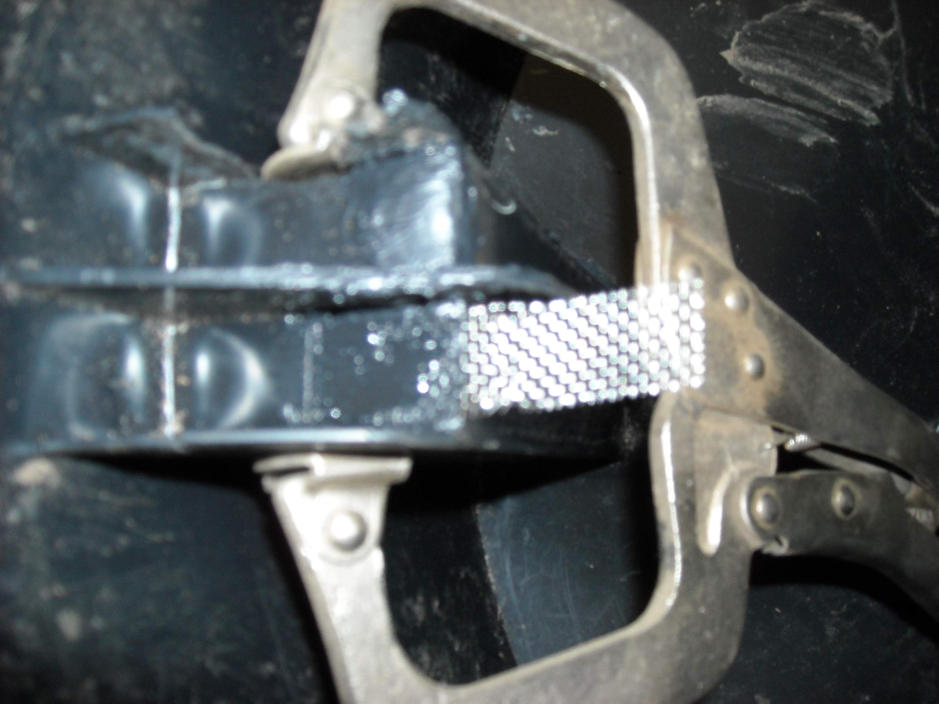

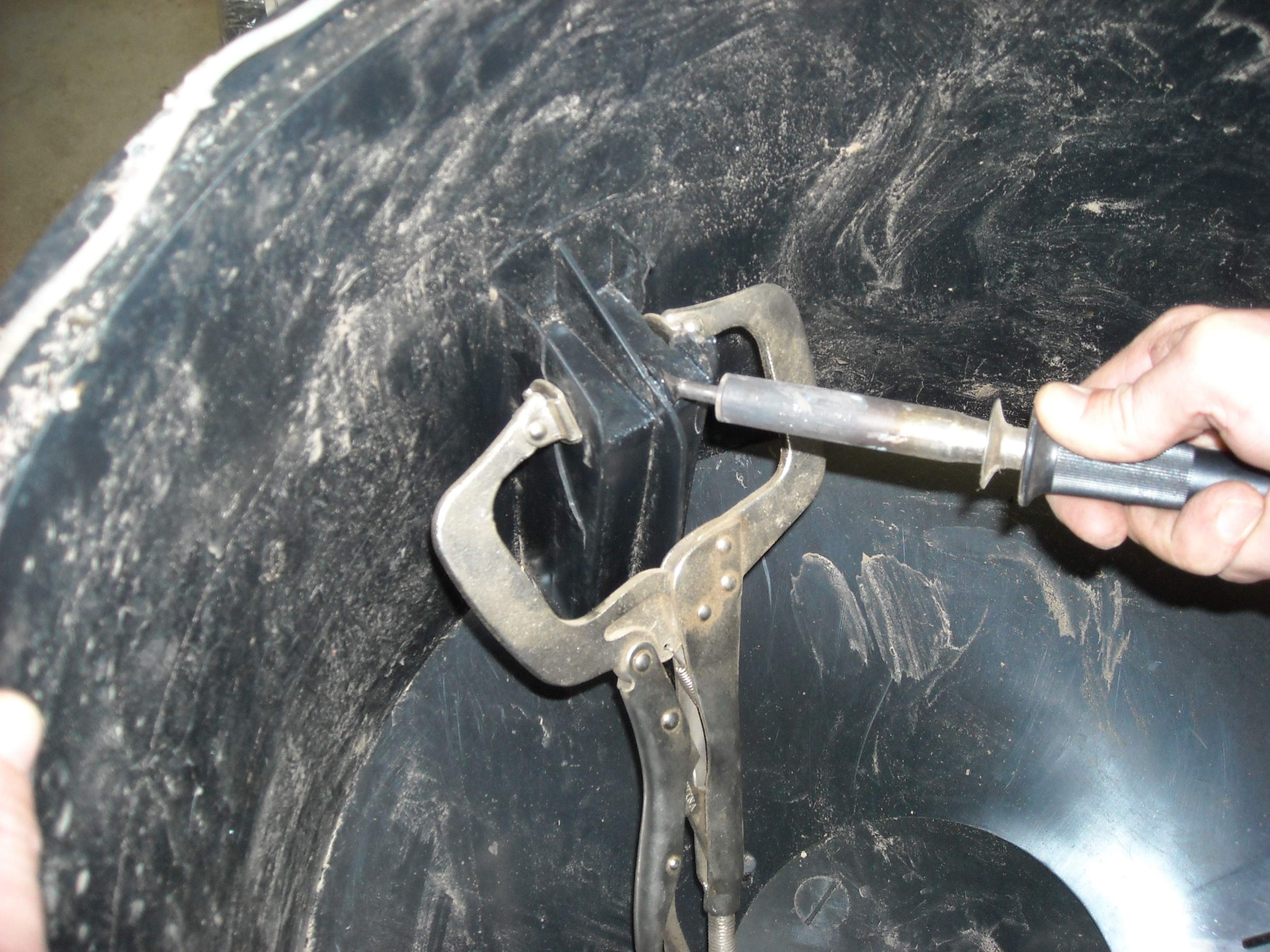

Here is a feeder i just fixed. Not verry pretty but i was in a hurry to get in the woods.

   / Plastic Fender repair #15
heres a few more. hope yall enjoyed :thumbsup:
