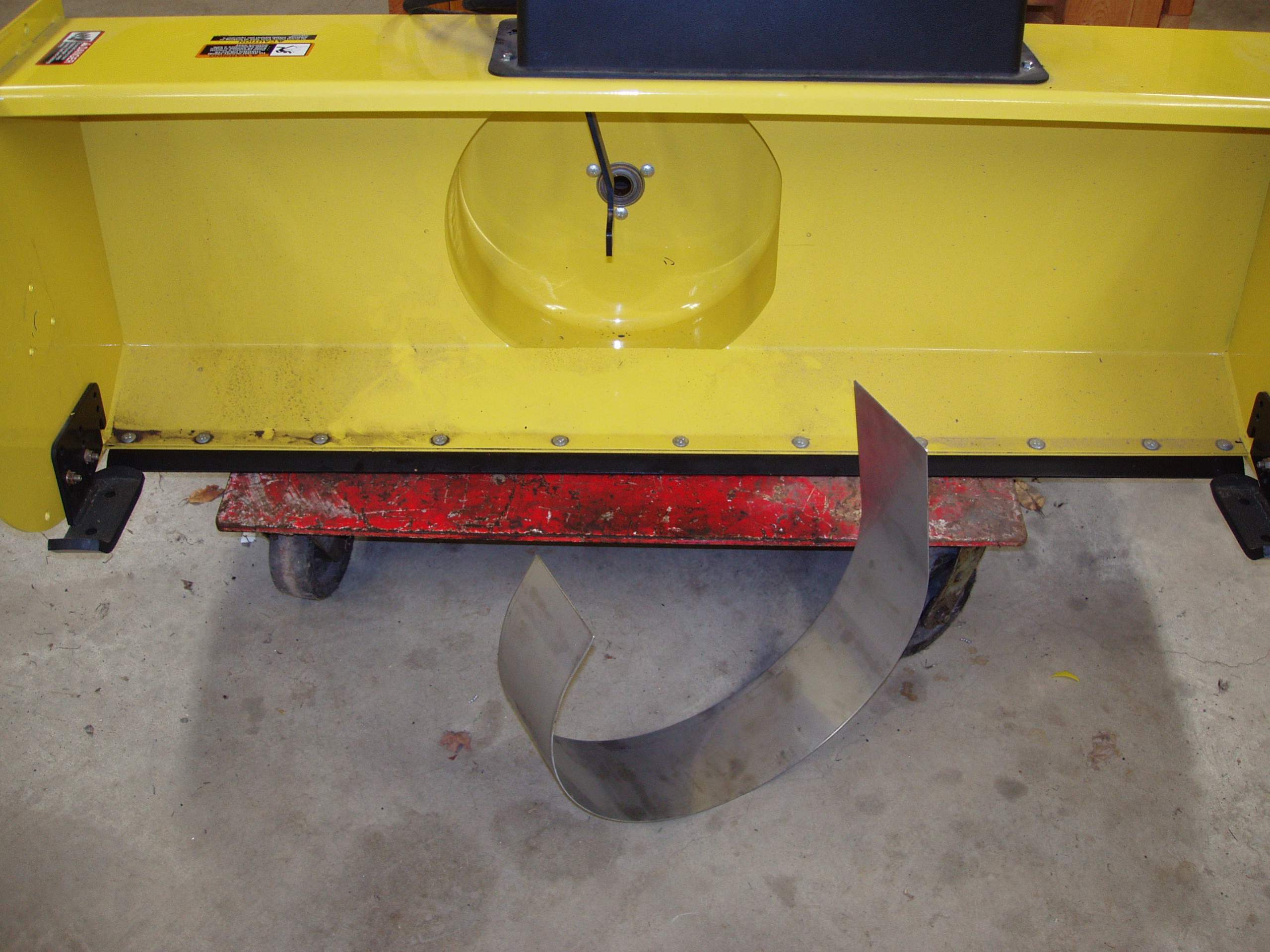

Unless I misread Mercmaniac's post, he is not having a problem with snow plugging his chute and he is not having a problem with the distance the snow is being thrown. He is having the same problem I had--gravel is being fed into the impeller housing along with the snow and the gravel gets wedged between the impeller and the housing and is roughing it up. That is why I added another layer of heavy sheet metal to the inside of the housing. The housing should have been manufactured with a heavier metal originally, but alas, the designers probably all have concrete or blacktop driveways. :)

Thanks for all the input. I am having a metal fab company roll a piece of 16 gauge stainless steel for the impeller housing. It should be done tomorrow.

#14
Here is what I ended up installing in my new 54" blower. 14 gauge stainless. I had 2 made and am putting one in my 47" blower as well. I used 8-32 SS truss head machine screws and nylon lock nuts to fasten it. I will keep an eye on the screws heads for wear. They can easily be replaced as needed without pulling the auger and impeller. A local metal fab business charged me $30 to cut and roll the SS.

   / Plastic liner in snowblower impeller housing #15
Make sure you drill your weep hole out. Those fans freeze easy enough, no sense making it worse.
