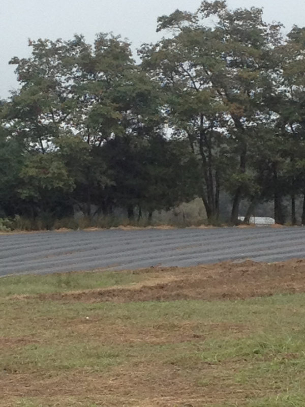

How did you get your beds to look so straight? Is it the buckeye equipment?
Yes it is a buckeye. DFB is telling the truth. You have to look straight, and it so tempting to look back. Those pictures are many adjustments ago, beds are much better now.

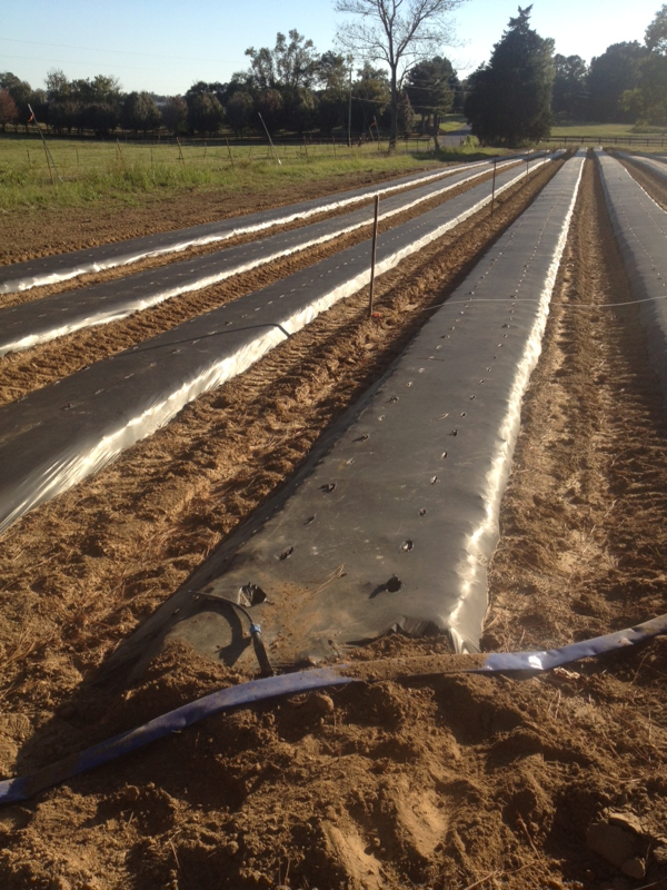

The curved bed too.
I would rather have straight rows but drainage was problem in this spot. Curves drop at each end does not wash and drains great.
