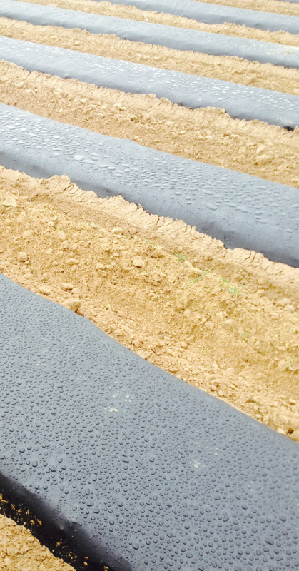

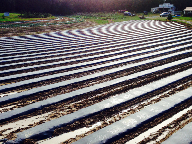

How did you get your beds to look so straight? Is it the buckeye equipment?
Yes it is a buckeye. DFB is telling the truth. You have to look straight, and it so tempting to look back. Those pictures are many adjustments ago, beds are much better now.
   / Plastic mulch layers and raised bed equipment #12

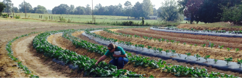

The curved bed too.
I would rather have straight rows but drainage was problem in this spot. Curves drop at each end does not wash and drains great.
