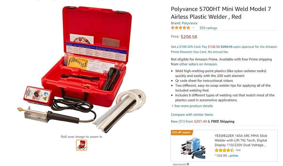

I use a plastic welder often to attached segmented 3D printed parts for an automotive company and I've found that it comes in handy for other things as well.
