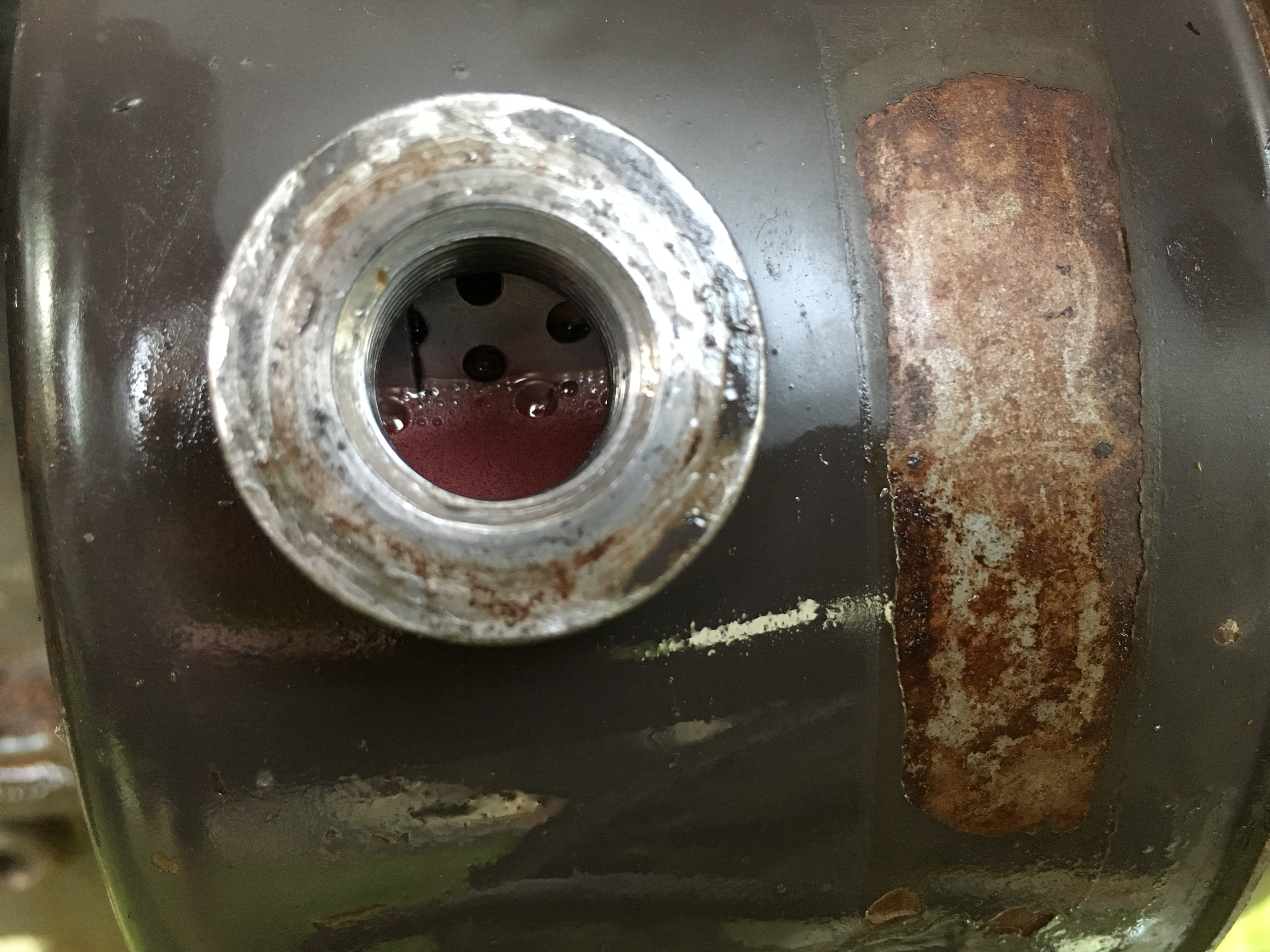

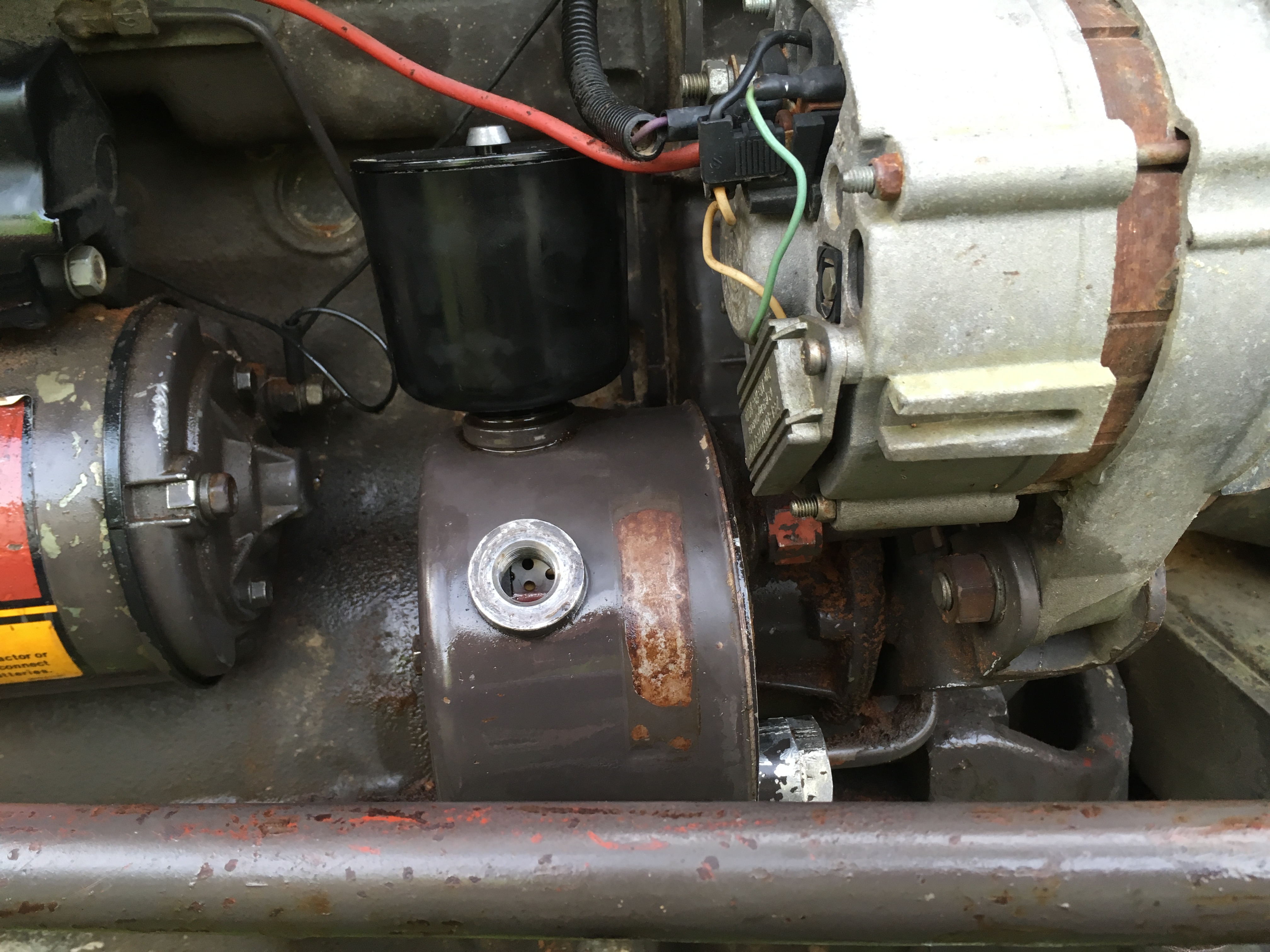

Also, I think I'm seeing air bubbles in the power steering pump. Trying to post a couple pictures...
   / Please Diagnose: Power Steering Problem
#16
Pump & bubbles
2 Pictures right here hopefully...

if memory serves, when i was looking at agcopartsbooks. that tank directly above the steering pump. = your fill location for steering fluid. and not on the steering pump itself. (((if this is the case))) i would say you are low on steering fluid.
and looking at the location on the steering pump were you have taken pictures, looks like there was an "0-ring" or something there for a nice tight fluid tight fitting / cap or what ever was connected there. leading me to believe you are low on steering fluid and you are getting air into your system due to low fluid.
   / Please Diagnose: Power Steering Problem #18
Don't know what the tank on top does but the lower opening is the correct level for fluid. I think you may be on the right track with the control valve movement or lack of 😎
The fluid is not low. There was a sticker there that read "cold fill line do not fill above bottom threads.", or something along those lines.
The "tank" is just there for a vent when too much pressure builds up or too much oil is in it. It will force fluid out the top. The metal piece on top is spring loaded and I guess it's set for a certain pressure relief from the factory.
