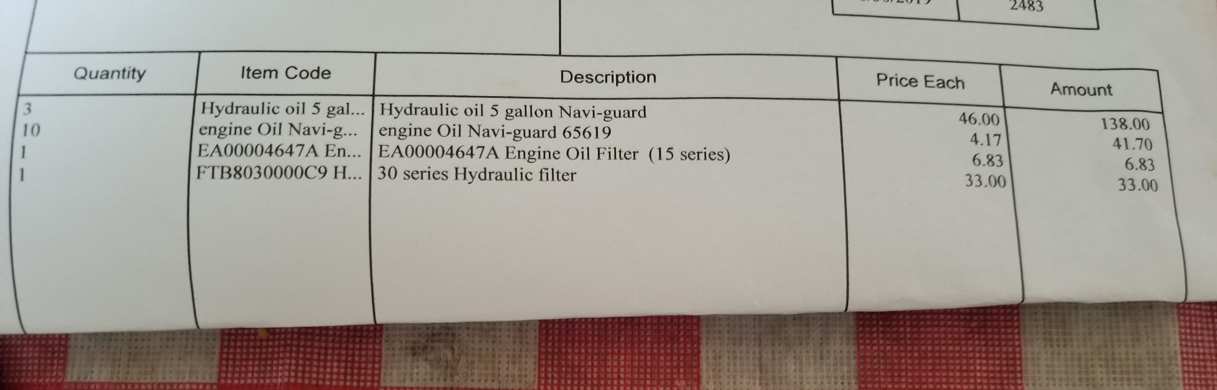

Not sure if that will work. This is all the stuff I got from the dealer for service. I only need 9qts oil, they gave 10. Not sure if that pic will work, it been a while since I've done the forum thing
Interesting choices of oil, hard to even find information about that brand,especially anything hydraulic/transmission.
