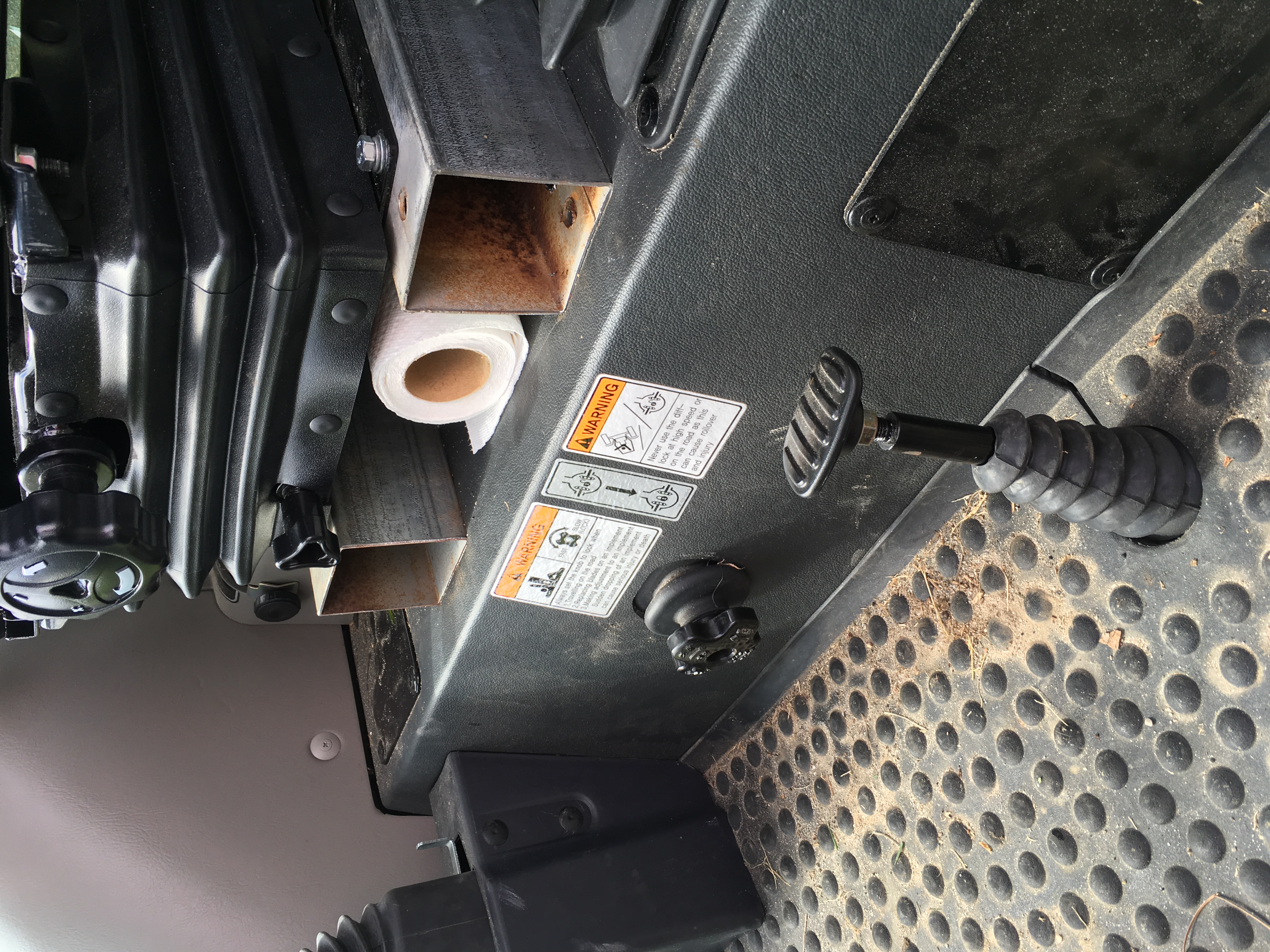

I'm not as tall as you 6'1" but have long legs and size 13" foot, my smallest tractor is a 3016 Mahindra and my knees would hit the dash so I did a little alteration on the seat and no problems now you might have to do the same going with a compact tractor.
