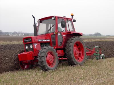

If it has Kimco front axle do not think of putting a front loader on the tractor. I had a tractor with Kimco axle and have never encountered weaker hubs on anything I have driven, had to jack up and look over the hubs every two weeks and replace bearings and various parts two times a year on the tractor. The tractor I had was the same front axle and rear end but with a perkins engine and Volvo BM cabin and bonnet. Volvo's latest attempt at tractor production before being acquired by Valmet
