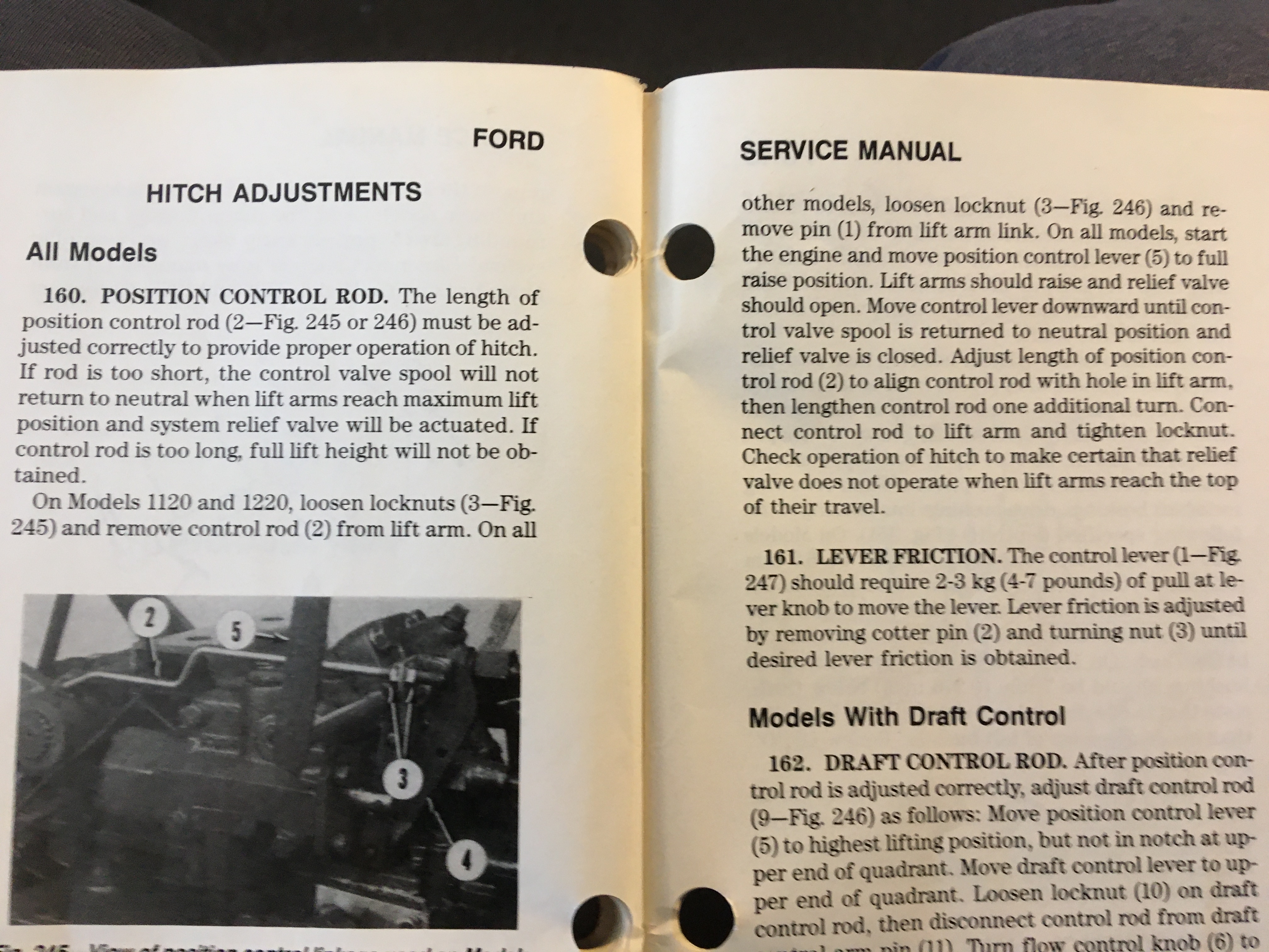

Had/have the same problem on my L4240 HST,the three point is out of adjustment and is going in relief robbing the hydraulic functions.
Mine was to the dealers three times for this( not fixed by them),as long as I leave the three point slightly off full up everything works as designed.
   / Please help me understand what's going on with my hydraulics #5
Position feedback lever should be properly adjusted. (not that difficult to DIY)
When in doubt leave 3PH near middle position and continue testing the rest.
If OOP and causing hydro to go into relief it would affect all loader functions, not just lift or curl by themselves.
   / Please help me understand what's going on with my hydraulics #7
I have attached the 3 pt feedback rod adjustment procedure.
Your loader valve cables need to be properly setup. I have attached WSM pages from a different model loader but most cable operated ones are the same.
In brief, you lock the joystick. Most joysticks have a lock to avoid inadvertent movement when driving. You disconnect the cables at the spool valves (2).
The spool valves with no cables attached will be centered. Now adjust the cables so that the pins connecting the cables to the spools just slide into place.
If a cable is pulling on a spool valve even a little hydraulic pressure will be bled off and downstream hydraulic systems like the 3 pt hitch and remotes will not operate properly.
nybirdman - this sounds like what is happening on my tractor. I will be researching how to make the adjustment, but in the meantime, it helps to know what is going on and how to overcome the issue by simply lowering the 3pt a bit from the full up position.
Old Grind - do you have any info on how to adjust the position feedback lever for the 3pt? I'd like to take this on myself if it is not too difficult.
