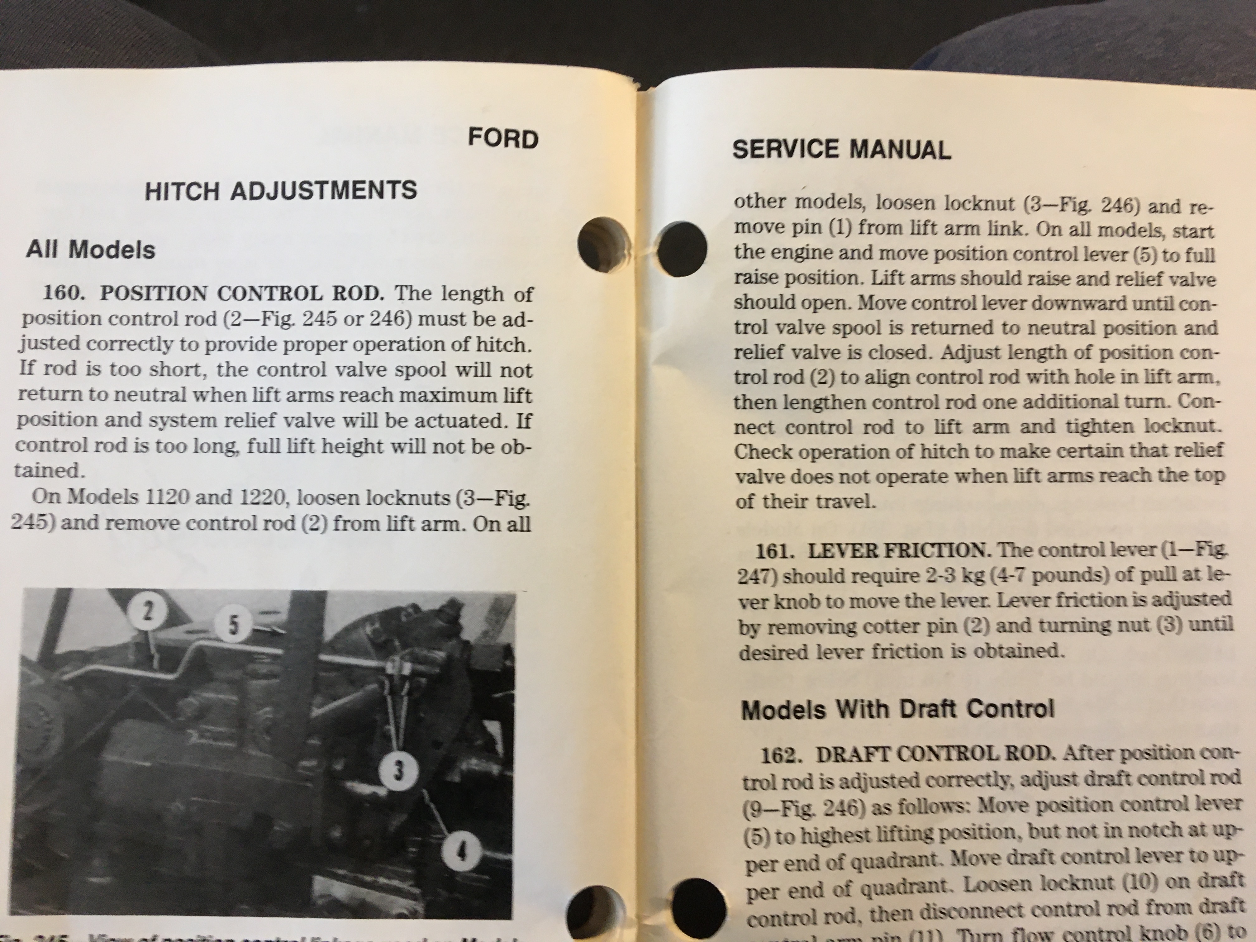

I bet if I described it (someone might have already) from another brand manual you'd find the procedure the same for all. It's pretty much twisting a little adjuster on the rock-shaft arm and listening for the growl you hear, then a tweak so the piston won't top out and go into relief. (I fumbled a bit doing this the first time & it took all of half an hour.)
Just reaching from my desk I found this. Procedure is pretty simple. Paragraph 160 tells the story. :)
You are absolutely correct!! It is/was very easy to adjust. The hydraulic system no longer goes into relief mode with the 3pt all the way in the up position. I greatly appreciate your (and all the others) input. This not only saved me the time and effort to load the tractor and haul it 40 minutes away, but also the dealer service charges I would have incurred for something so easy to fix myself. I am once again, blown away at the knowledge and generosity of this community.
THANK YOU!:drink:
