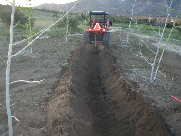

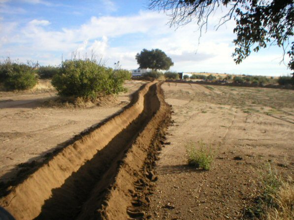

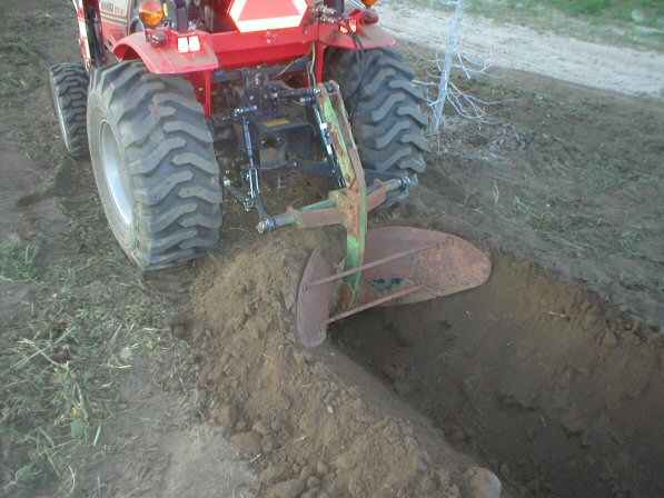

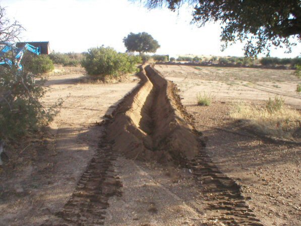

Of the tractors that you have listed, I would get the Mahindra 3316. :thumbsup: Either that or see what you can do on a Kioti CK35. Forget about the hoe, to small to be digging that many stumps and you have too much drainage to put in to be using a hoe, especially a small one. Hire the stump removal out or buy a bigger machine, do the work and sell it, but forget the small hoe. For the drainage you want either a trencher or a ditch plow, with the plow being the fastest depending on your ground and how deep you need to go. (rocks-roots etc) Get a box blade for working your dirt, You will not see a professional grading ground with a FEL. They may fill a ditch, or back drag if the have a backhoe, but you will not find anybody landscaping and using a loader bucket as there main implement for shaping the ground. There is a reason for that believe it or not.
Here is a picture of my ditch plow AKA a middle buster or a potato plow. A ditch plow is a bit bigger that the others though. Mine will dig a ditch 20" deep with one pull. Ground conditions may change that, but with my ground it has always worked with one pull and a second pull to clean it out a bit better. Figure that you can easily do over a thousand feet an hour if you don't have to fight the ground. the 3rd & 4th picture are just under 300 feet long and took me right at 10 minutes to make the cut pass and the clean out pass. :thumbsup: Pretty hard to ditch much faster than that.

This is a whole lot of great advice in only 8 hours. You have all convinced me that I should pay someone else with a BIG excavator to get those stumps out. A number of you said what will I do with them then....I've always burned em...not this many mind you, but I have found the best part of retirement is having lots of free time. I figured putting them in piles and burn em next spring. But I also want to look more into the stump grinding thing. Brian, thanks for the pictures of the plow doing trenches...I doubt my clay would go that easy but the trencher idea reminded me that I started looking for one of those last year and the biggest I could find was like a 4 inch ditch witch at a United Rental. There must be something better available in Southern Oregon. But I can sure say that having the TBN brain trust to tap into is making this tractor search fun....and another big 'thanks' to everyone for helping with the process!!

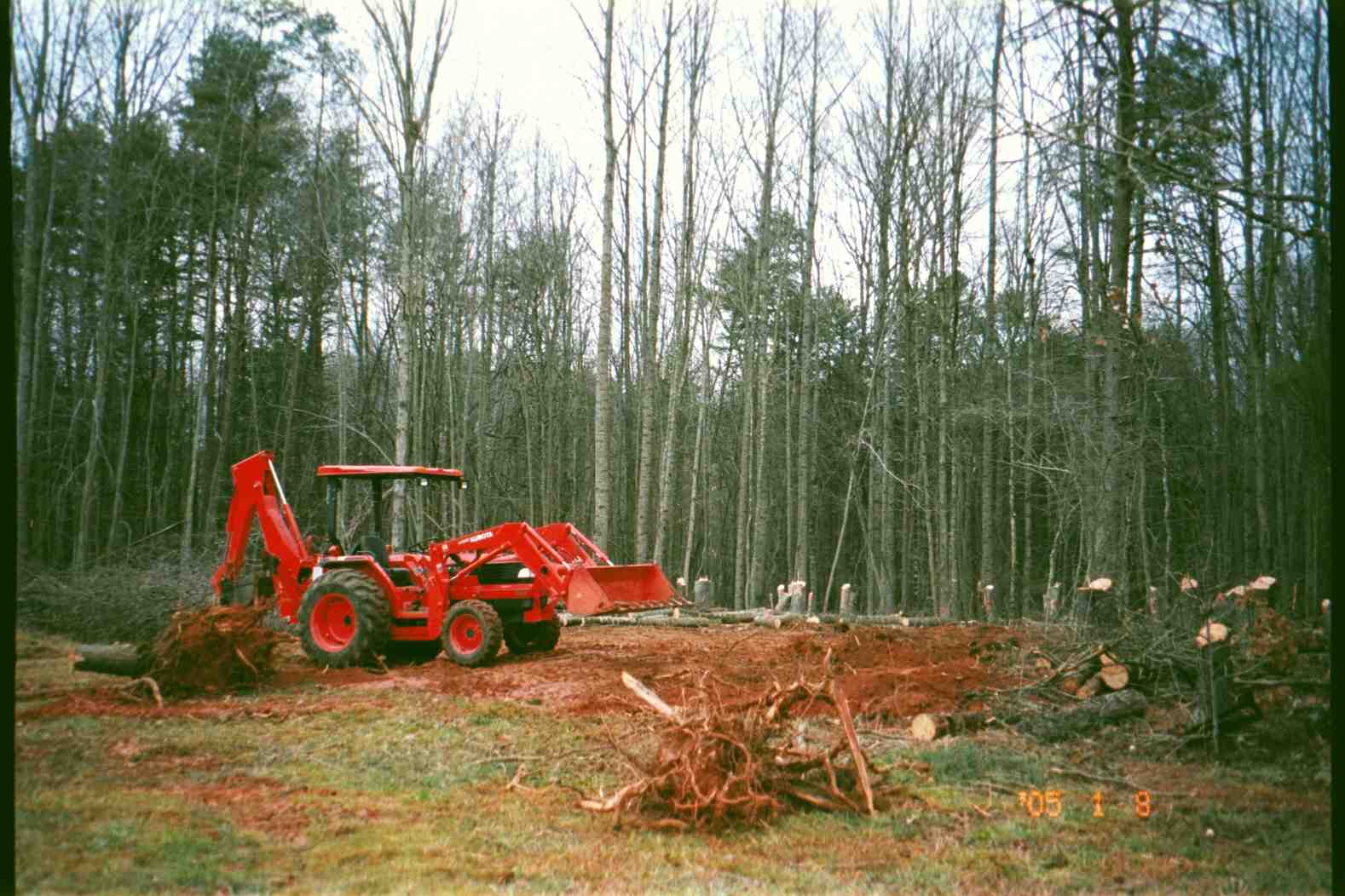

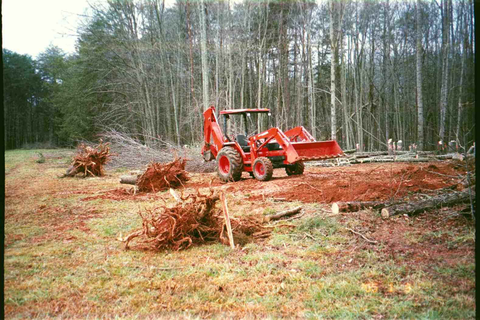

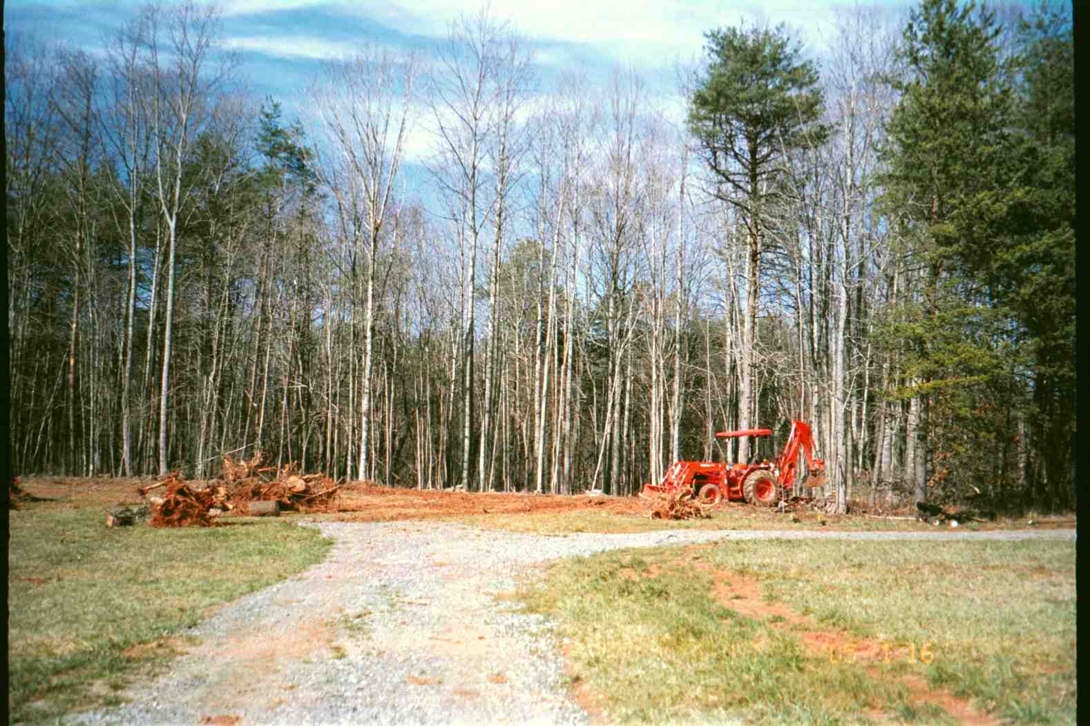

Well, I guess there has to be at least one person to speak up for using a backhoe just so you don't get the idea everyone is against it. I did essentially what you are planning to do and it worked out just fine. We were putting up our shop building in 2005 which required clearing something like 100trees of similar size to what you describe, of mixed pine and hardwood. I've attached some pics taken at the time.
We chose to add the backhoe to our tractor because we couldn't afford a separate mini-ex and we also knew this was only one of many projects requiring excavation, so the backhoe made lots more financial sense than repeated rentals or hiring someone to do the work.
The tractor is a Kubota L4610 with a Kubota 4560 backhoe. It handled the job without any problems. I won't kid you... it takes some time to take out a large stump... I define large as anything where the stump and rootball can't be lifted out of the crater once it's loose. The last photo shows one like that, which required digging a ramp and pushing it out. Smaller stumps take less time.
So it can be done. Whether that's the best choice for your situation or for anyone else's is beyond my pay grade, as they say.
Words of advice if you decide to go in this direction:
Get enough tractor and backhoe for the task.
Do it when the weather is cooperating, if possible.
Have time available when you can work at it.
I wouldn't disagree with any of the other comments about mini-excavators, excavators or contracting such work to others... all are probably quicker and less work. I would add to the list buying a used full-size TLB for the grubbing work, then selling it. Depending on circumstances, any of these routes might be cheaper than the backhoe, but not in every instance. But doing it with a backhoe is possible, can save money, and can be a useful hands-on experience under the right conditions.
