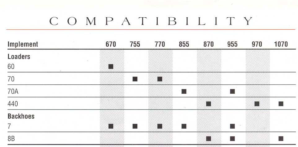

Your loader knowledge is greater than mine. I'd never heard of the 51, 52, or 67 loaders before. At the JD store I've seen two 790's in the same lot, one with a 70 loader and one with one of the newer loaders (410?). So, I know you are right...more than one loader model can fit on a given tractor.
My friend has a 755 with a 70 loader. Attached is a portion of a table from a JD brochure, printed when the 55 series was current. I included loader and backhoe recommendations. The alternative loader models you mention weren't something I was aware of re: my earlier post. Heck, if TJC can't find a 70 or 52 model, maybe one of the newer loaders will fit?!

Good to know that there are other loader models available for those tractors. My loader manual and tractor manual mentions the 70 for the 755, and the 70 A for the 855 and 955 so again we learn. /forums/images/graemlins/smile.gif

The attachment is correct in that the 70A would fit on the 855 & 955. If I remember correctly the 70A loader came out in the '90's. My 755 was an '88 and that is the era my info is from. I think JD is now putting a 419 loader on the 790, I don't know if JD has a new loader for 990 or is still using the 430. I don't have much upstairs but every once in awhile a little leaks out /forums/images/graemlins/grin.gif
