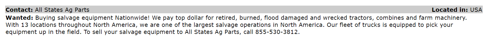

According to Tractordata.com JD 4400 has open center hyd system. So you will need to locate the power beyond port on your tractor. I suggest to contact some tractor salvage yards to determine if they have the used scv kit you need. One tractor salvage yard is shown below.
