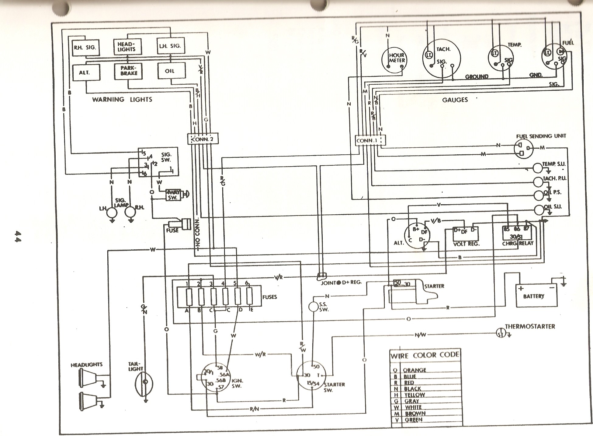

Attached is a wiring diagram for a 2360 that I worked on this past summer for a friend. Looking at tractordata.com, this diagram maybe the same/close for your tractor. The diagram shows three wires coming out of the sending unit 2 black and one brown. I would say the two black wires are ground. One ground the unit to the frame and the other running to the fuel gauge.
With the key just in the on position (tractor not running) touch the brown wire and the black running to the fuel gauge. The gauge should either go to full or to empty. As stated already the fuel sender is a variable resistor. Using an ohm meter and moving the float up and down the resistance will increase and decrease.
NO power should be running to the sending unit.

Thank you all for the help. You are correct JD5210 about there being 2 black wires, however that diagram shows 2 brown wires and a black. To be specific, the thinnest black wire on this sending unit has a green stripe. Here's some updated info:
1) bulb to low fuel warning light was blown, new bulb and now it stays on EVEN when no wires are hooked up to sending unit
2) ran test light to ground and inserted tip into each, got needle on gauge to go to full, turned ignition off and when I turned it back on it was between 1/4 and 1/2 way mark. Once removed, it went back to empty and I could not duplicate this again.
3) around 30 ohms between brown and solid black wire, no readings in any combo with black/green striped wire

On point 1, with the wires disconnected you have no resistance/open circuit, so most likely that is why the bulb is on.
On point 2, there is no voltage on these wires, so a test light is not the correct tool to use. I suggest you test this way, if you can tell which of the 2 wires go to the gauge, disconnect them from the sender and connect the 2 wires together and the gauge should go to full or empty. If you can remove the sender connect your ohm meter to the sender where the wires connected that go to the gauge. Moving the float up and down should change the ohm reading. I you get no change in the ohm reading or it is jumping around replace the sender. Seating diesel fuel all these years most likely it has gone bad.
On point 3, did you connect the ohm meter to the sender or the wires to the gauge? You should be connecting it to the disconnected sender. I would guess you need to remove the sender to be able to move the float.

Well, it has come a turd floater here, so I won't be able to go any further with this project today. Sending unit is difficult to get out. I have the tank cover/dash ready to come off, but didn't have a 30mm socket to remove the steering wheel nut. I'm this deep in this baby now that there's no turning back. I want to have a fuel gauge that works, especially since there is no way to yard stick it (tank has a spout that comes out 90 degrees). I'll connect those wires like suggested. There are only 2 prongs on the sending unit that show ohms. The solid black and the brown and the brown is grounded to the firewall, so the black w/ green stripe and the solid black have to be the wires that go back to the gauge. When checking the ohms between their respective prongs on the sending unit, I get no reading. Once I get the sending unit out, I'm gonna put a new one in it, especially with all the rust in the tank. I may just remove the tank and try and treat the rust problem. Anyone know of a treatment that works for sealing a fuel tank? I'll try and search for your thread or others with similar fuel problems.

Well got the sending unit out. Had to take steering wheel and dash off to get sheet metal off. Inside is better than I feared with rust only at the very top. I think I will just try and knock as much of the rust off in-situ and flush the tank. I'll, then, add another fuel separator between the tank and mechanical fuel pump and any anti rust additives to the fuel, along with keeping it full. Or my **** self will over ride that thought and I will pull the tank an seal it. I, just, hate waiting the 96 hrs. to let it cure and rain is coming again.
The sending unit is a marvel of Romanian engineering :eek: It was all over the place, but it is hard to hold the pins where they need to be while moving the float, which had a hole in it and was full of fuel. I made the hole a bit larger and drained it and plan to use a soldering iron to seal it up again. Haven't had any luck finding a sending unit, yet.
