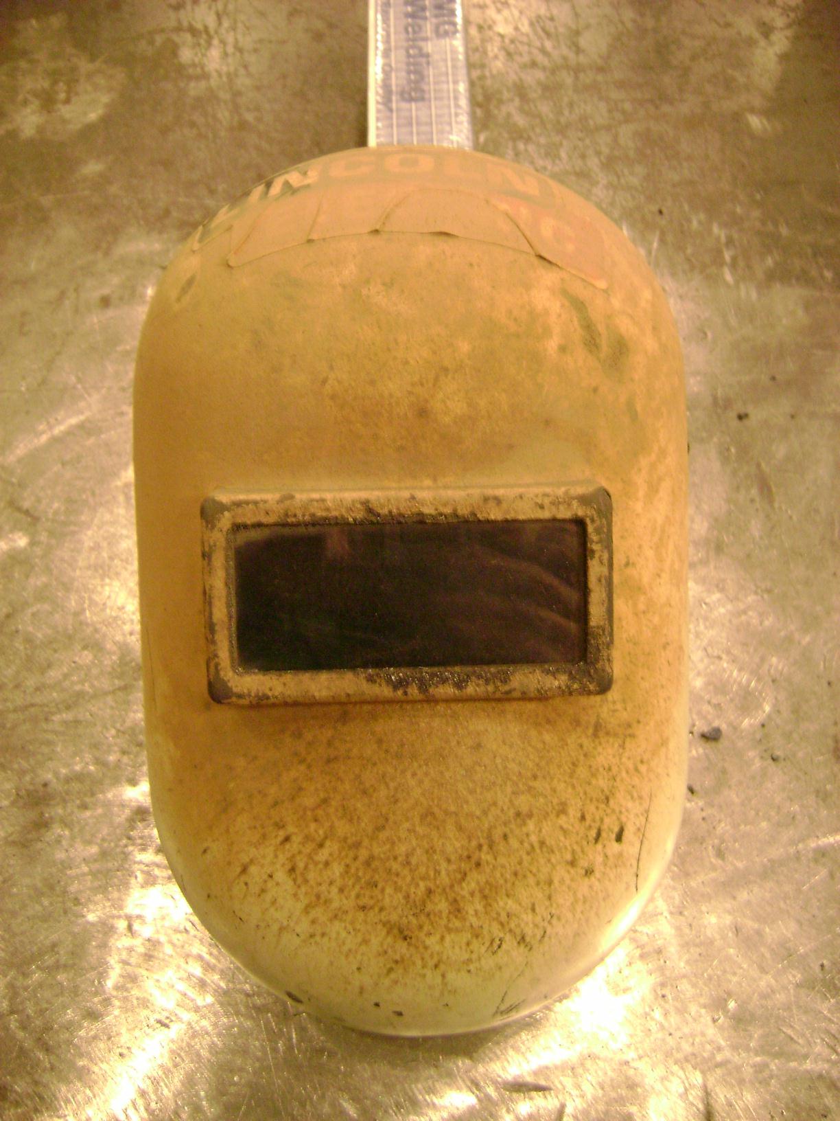

   / Please scrutinize my welds. #17
Yeah I was trying to draw these kids into something, but you beat me to it!:laughing:
I'll stick with my old school hood. I did buy a fixed shade auto lens awhile back, and just today this new Miller fixed shade came, I'll give it a go tomorrow morning. The first auto lens only had one sensor, so I'd get flashed when moving my head around something, this Miller lens has two sensors, hopefully it will be better.
