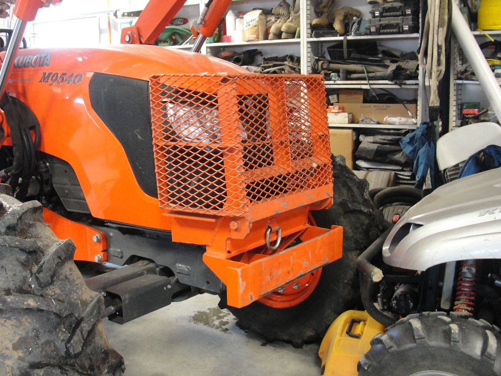

May want to get a brush guard (standard with the loader) & generally armor up a bit. Depending on what you mow.
   / Please try & talk me out of a Kubota L4060 #54
Fallon's post reminded me, must have if you ever operate in the brush.
I got the Kubota grill guard, but I already have plans to add on to it and build some screens like what you posted to help keep the front hood grill cleaner.
