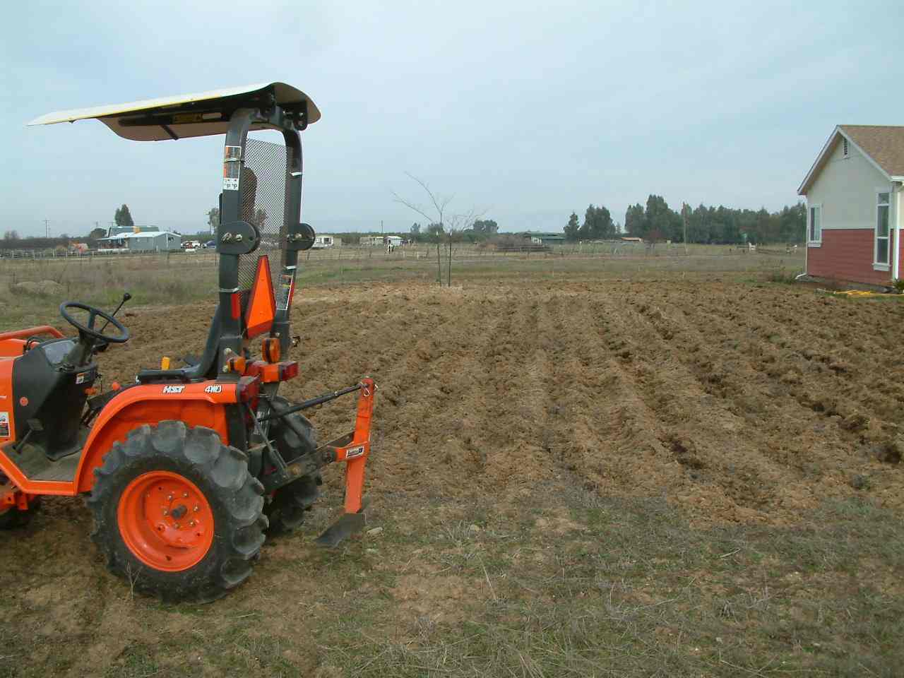

Don't know if a little B7800 could handle a 1-16 plow even in soft ground.
I have a 21-hp B7510HST. Just finished plowing a landscape area around my new house that will be planted in tall fescue. Used my King Kutter middle buster plow since that's all I had available. Ground is pretty soft from Dec rains.
I would plow one furrow. Then move over just enough so the 7510 would run on level ground next to the furrow and plow another furrow. Then I would plow a third furrow with the 7510 wheels running in the first two furrows. I'll rototill the plowed area in late Feb using my Yanmar RS1200 tiller and plant grass depending on the temperature.
Seemed to work OK for me since I just needed to bust up the soil prior to rototilling. Don't know why you're plowing, but maybe my plowing method would work for you.
Got any pictures of your plow?
