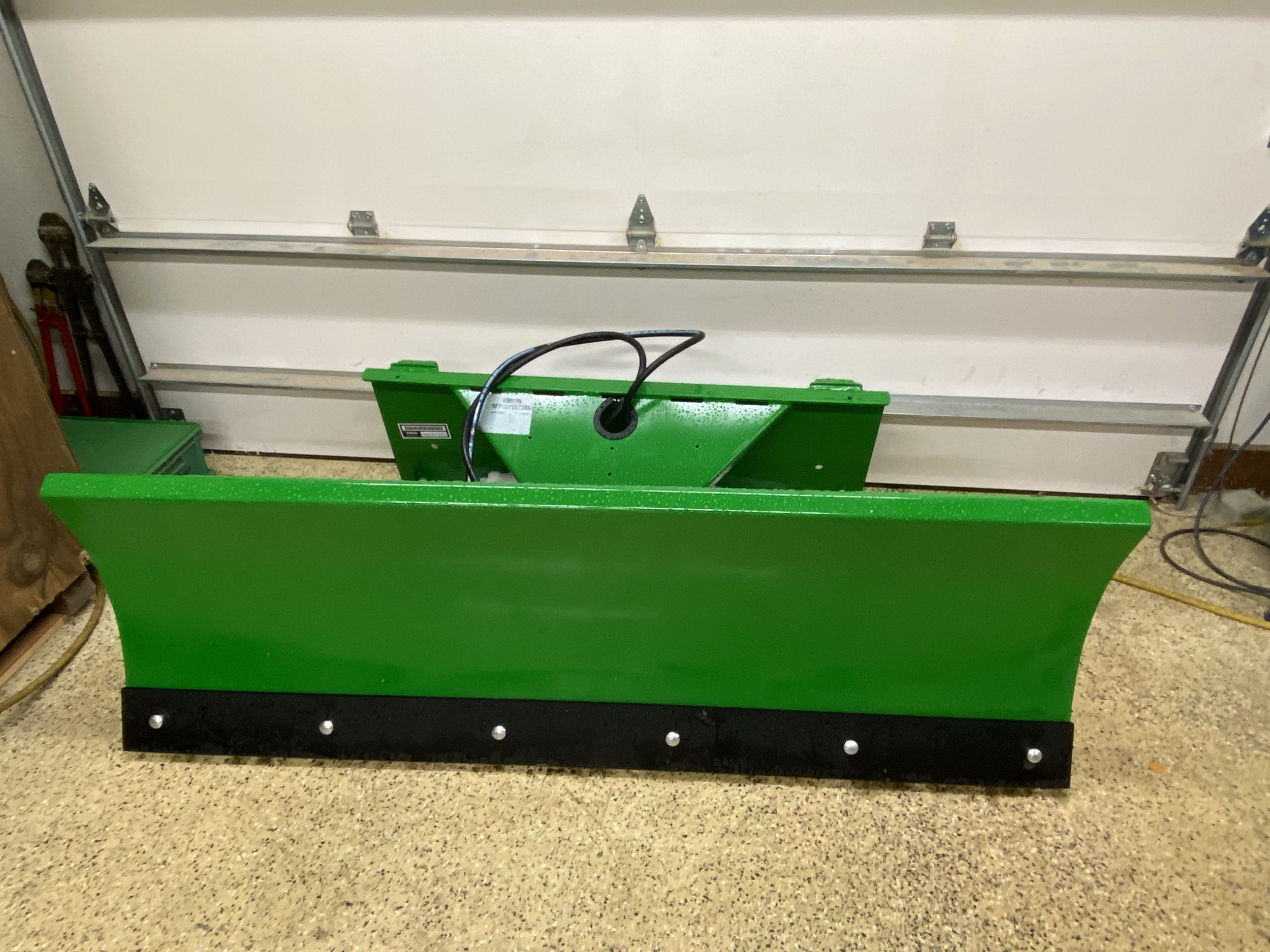

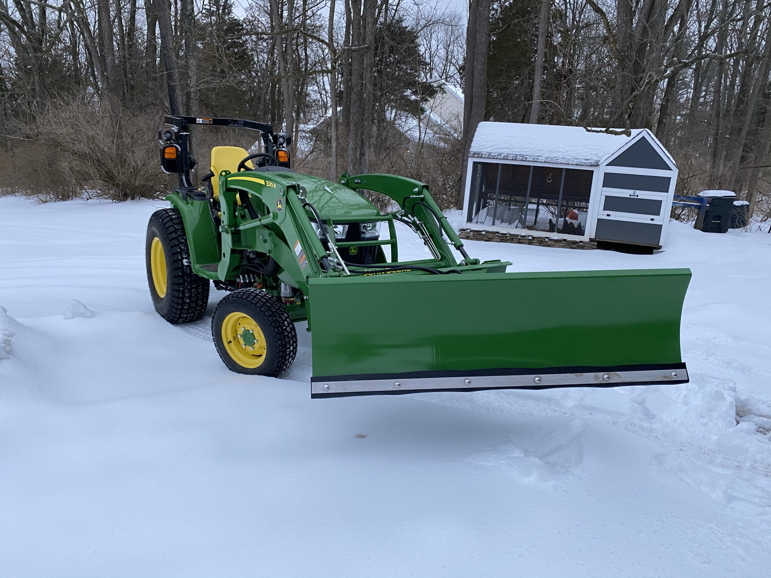

Nice fab work! You definitely have a lot less weight on your plow edge than me, by maybe 3x or more. But I have about 2.25x more contact area with the 50% wider and 50% thicker piece of UHMW, so probably not too bad.
   / Soft snow plow edges for asphalt #22
Oh thank u! Sounds like you have a way more capable plow than my little guy. Mines just for my driveway, I certainly couldn't take this thing out on the road, for instance.

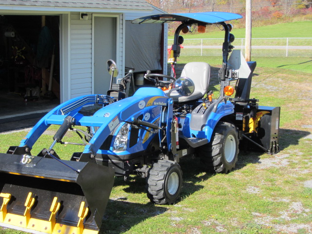

Always options
#28
Always options

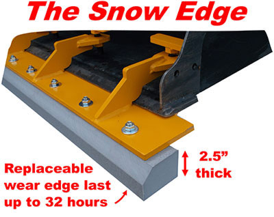

You caught my attention. What exactly is going on with that bucket? Looks like a bolt-on tooth bar, but with a hard cutting edge in place of the teeth? Not sure what those things are that look like mini curling stones, or why one is rotated 90 degrees relative to the other three.
   / Soft snow plow edges for asphalt #29
It's a "snow-edge" by Ratchet Rake that has a "sacrificial" edge to save the blacktop.
What I like about it is it makes a novice operator like me with a FEL much more proficient in that the angle can be ± 15 degrees without issue. ( the one toggle at 90 isn't tightened down yet ) And just to mention ... the edge is advertised to last 32 hours but I'm on my 5th season without much wear at all. ( Kinda makes me regret buying the spare edge )

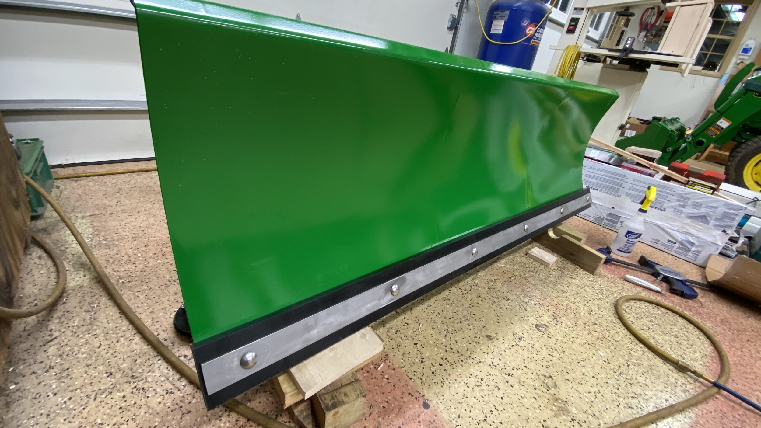

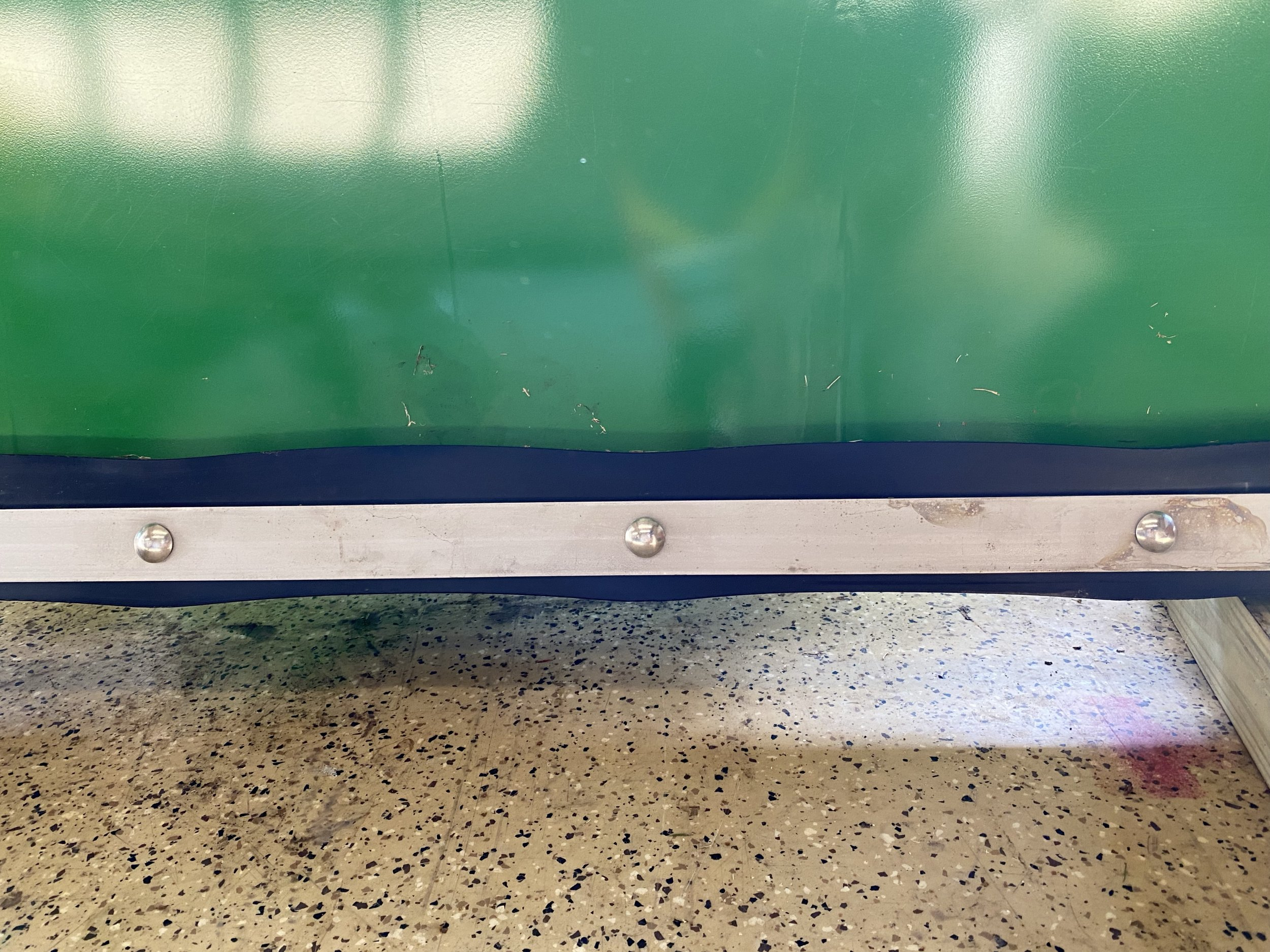

I got my new UHMW edge mounted yesterday, as it was too rainy to do much outside:
Oh I had one of those! Yeh, for 300 bux, it does the job as far as protecting the driveway. A plow is better though in every way for managing snow.
Here's me using it:
