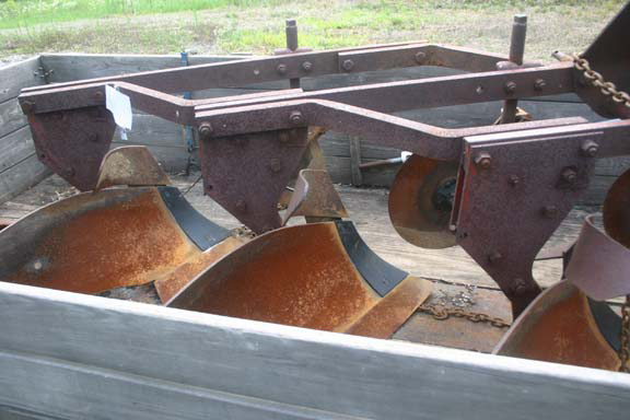

I am needing to replace my plow shears this weekend. I rememmber a thread talking about the bolts holding the shears. I thought these were specific to the shear but doing some searching I found that the term Plow Bolts is just a type of carrage bolt with a thin flat head. So if I need to cut or break the bolts off can I replace them with these generic plow bolts or are there specific bolts I need to find. The plow is a 3x14 Ford 101.

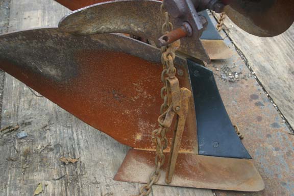

Thanks for all the help. I got the shins changed today. The top bolts came off with a breaker bar but the bottom ones are almost inaccessable so they got the sawzall treatment. Also the old shins had plow bolts but the new ones I got from TSC took clipped head bolts. I found them at my tractor dealer. The top bolts were 7/16" x 1.5" and the bottoms were 7/16" x 1". Here are a couple of pics with the new shins.
