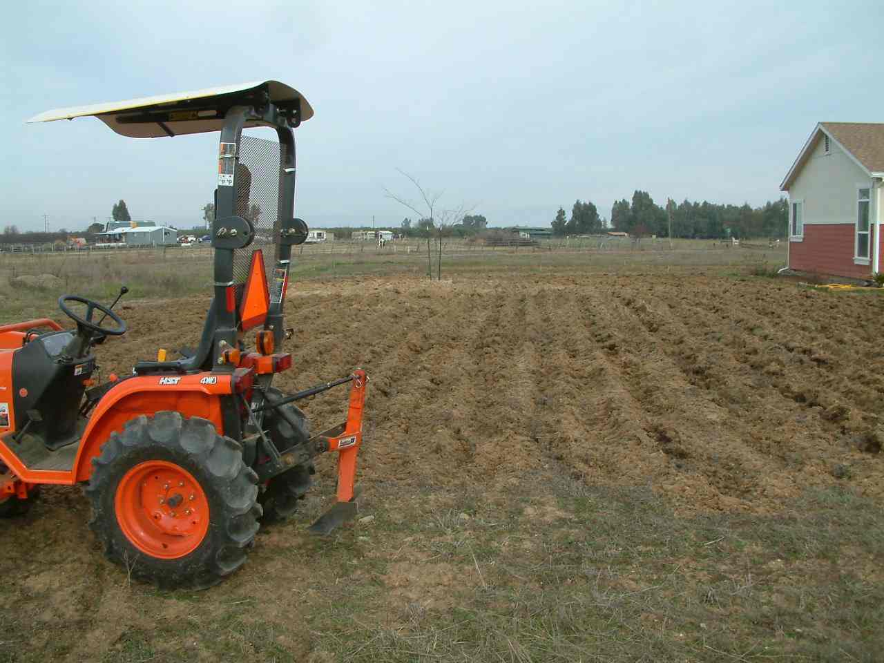

I used a middle buster plow (aka potato plow) with my Kubota B7510HST (21 hp engine, 17 hp pto, 4WD) to plow the ground for the landscaping around my new house. I did this in Spring during the rainy season here when the ground was soft enough for the 7510 to plow to about 8 inches depth. Then I rototilled with a used Yanmar RS1200 that I bought for $300. Total area was about 1/3 acre. I also use the RS1200 on my veg garden.

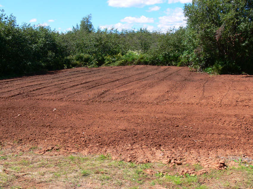

I just went through this, this year. My property is old-time farmland, but had sat for 50 years, growing weeds and brambles and alders :rolleyes: . I had the bigger brush hogged out, then just used a tiller, went over it 2 or 3 times. It came out perfect. :)
   / Plow/Disc or Tiller #9
Dabblam it Ian, where are your rocks.:D
The tiller may be better in larger rocks than a plow and it sure will cut down on time spent cultivating??:D
