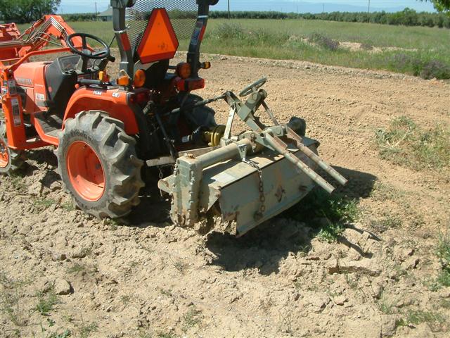

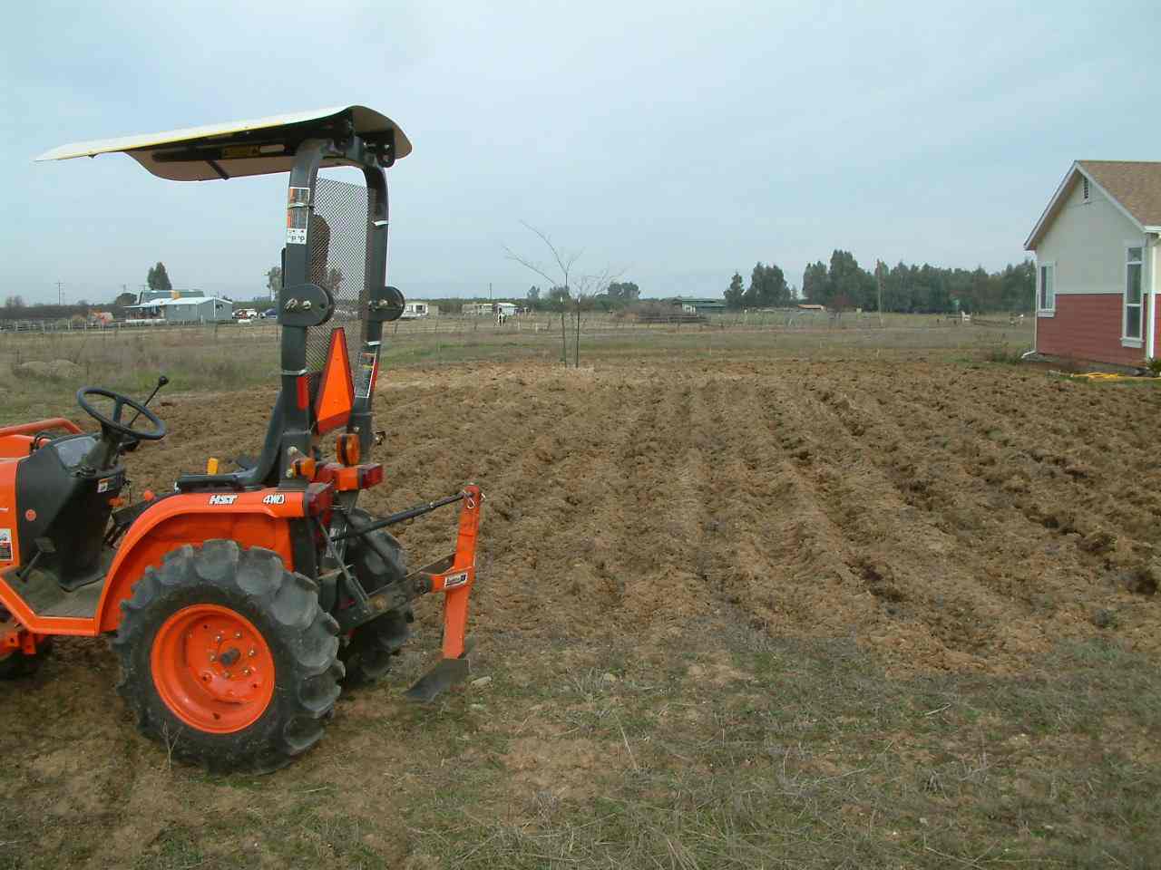

Get yourself a $150 middle buster plow (aka potato plow) from Tractor Supply and use it first. Then rototill (my tiller is a used $300 Yanmar RS1200, 48" wide). Both worked fine behind my Kubota B7510HST (21 hp engine, 17 hp pto).
