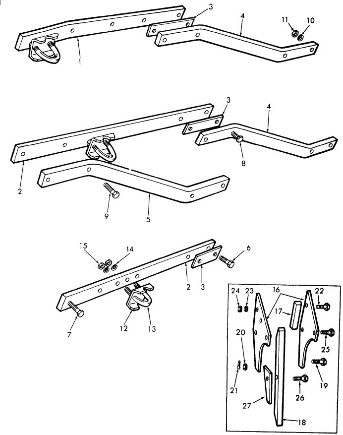

Heat and bend the bar that holds the coulter shank (plow frame...) . Bend it inboard far enough to clear the draft arm. THen simple pivot the coulter shank to where the coulter runs in the proper alignment. I've seen EXACTLY the same situation dealt with in this manner. Makes for a simple fix that allows the plow to operate in the manner for which it was designed.
Making radical adjustments on the plow itself will result in the plow running somewhere other than in the correctly centered on the line of draft. That will cause the plow to pull more on one side of the tractor, tending to cause the tractor to "steer" to one side. You want the plow to operate with the top link running in line with the tractor, NOT skewed to one side.

/ Plow fitment problem #17
Here's a diagram of a Ford 101 plow frame and a picture of a plow with the bend FWJ was talking about. In this case it was designed into the plow and came that way. I'll admit when I was looking for a plow, I thought the beam was bent due to an accident on the first one I saw.
