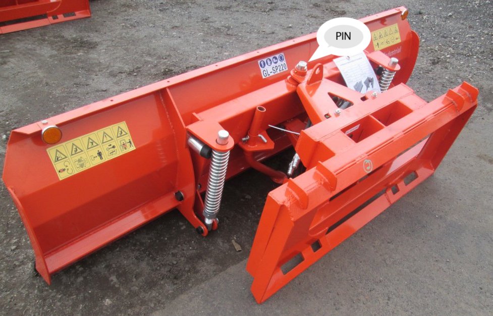

I have a 84" plow on my Kubota l3301, similar to the Titan and is marked SP 220 It goes off level in both directions when I angle it. This is
a real pain as I have a 2000 ft long gravel driveway. I have been keeping it a bit high to avoid digging in
on the first pass and then reducing the blade angle and making a second or third pass. Seems like this is just
the geometry of the blade pivot. Loader arms are square and level and so is the snow blade when it is
perpendicular to the tractor. Any ideas?

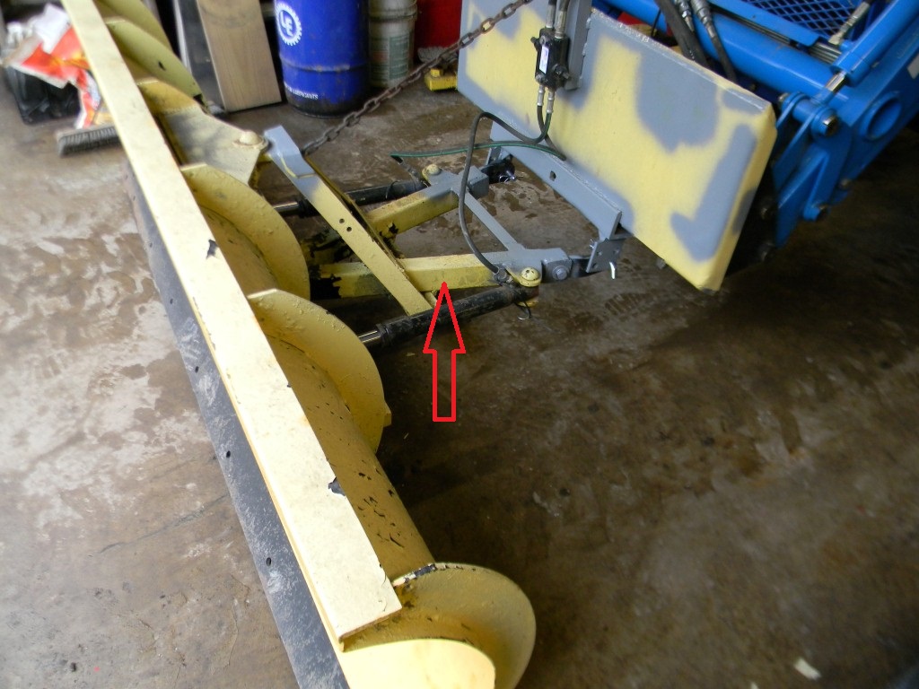

Not sure if your plow connects directly to a QA plate or has arms like mine. If yours is like the attached pic, the arms noted with the red arrow must be level in order for the blade to pivot level. If directly attached then you need to adjust the curl function to make the blade pivot level. Please attach a pic of how yours is attached so a better assessment can be given. Either way I believe a simple curl adjustment can make it swing level.

Yup, what he said. If the push arms aren't level the blade won't pivot level.

I'm thinking the problem is really the design of this plow. If you look at the picture of the plow it simple pivots on a heavy center pin and has no arms or
other support to hold it level. My loader arms are straight and the plow if level in the center/perpendicular position. Most likely there is a slight amount of play at the pivot point(this is just a pin in a hole/no bearings) and when the hydraulics yank in one direction or the other it goes off level. I could free float the plow but it would not be great on the gravel.

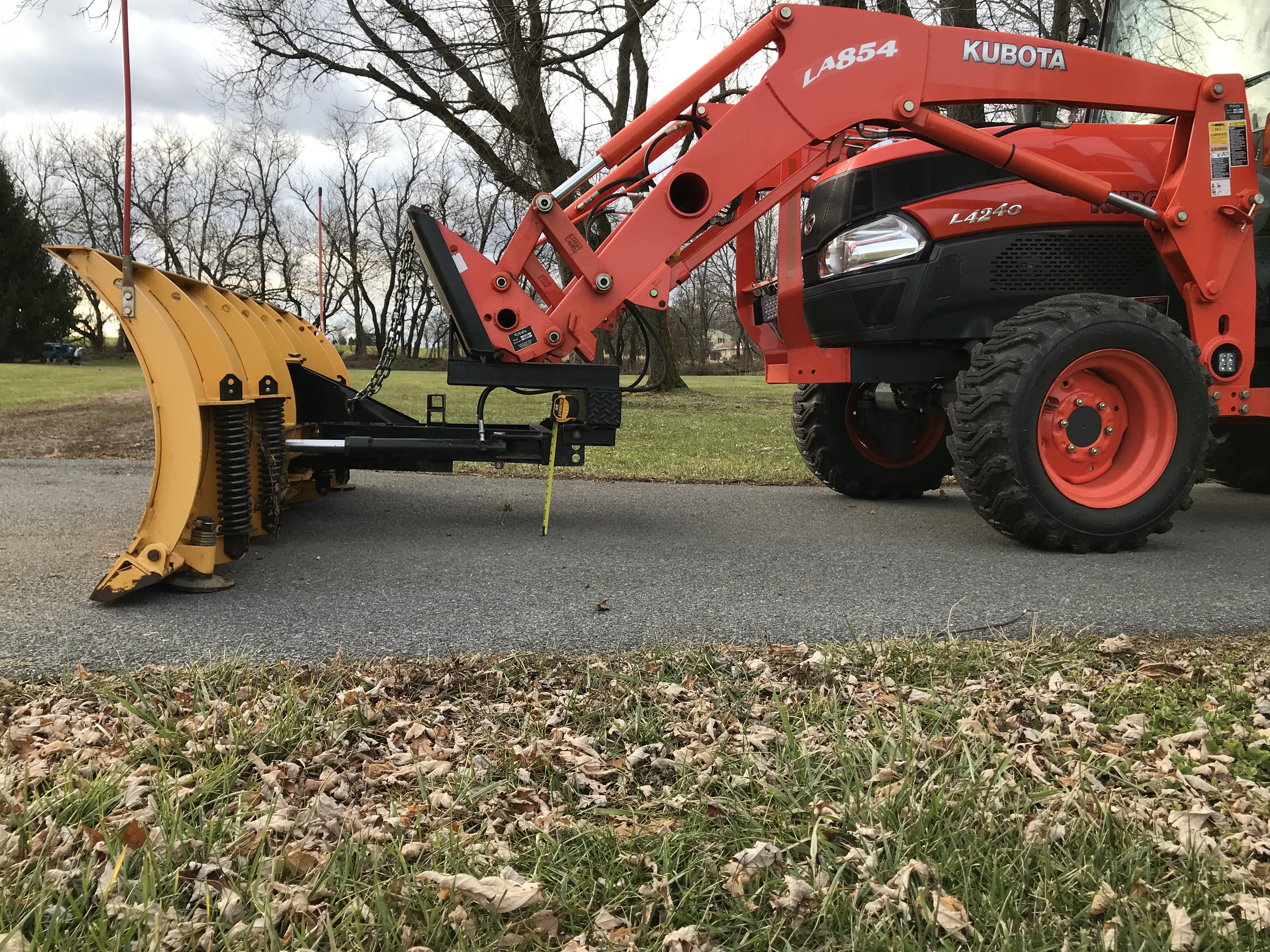

The pin marked in Post#7 above needs to be straight vertical and the ends won't dig in. Make the pin level with the curl/dump function of the loader.
In the picture below the frame is level, like others have recommended. The pin is at a 90* angle to the frame, so it's dead vertical. When the blade is rotated left and right, the entire bottom edge of the blade stays on the driveway.
If I dial some "dump" into the loader, the front end of the blade will dig in regardless of whether it is rotated left or right. If I curl, the rear end of the blade will dig in. Again, regardless of rotation.
In the picture it looks like the SSQA plate has some off angle thing going on.

I think you need some seat time, with patients and practice. Work on getting the plow level (pin vertical) from the seat.
There is nothing wrong with your plow, and a little slop/play is normal. This is simply a curl adjustment that you can do from the seat.

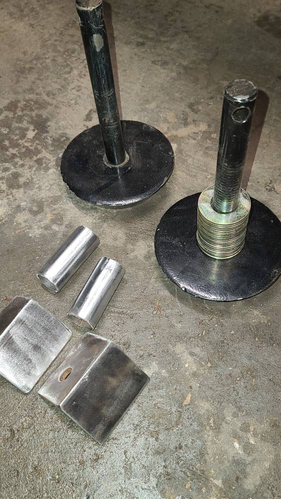

I have the same exact plow that you do.
That being said, I have run snow plows most of my life, Boss, Meyers, etc on pickups and commercial vehicles and I will tell you that this quick attach plow setup on the front of a loader on a tractor like this did take a little bit of getting used to, but after a week or two in various conditions have got it down and am very happy with it. On my Homestead I have a lot of loose Rock and dirt and also 5 miles down an uneven mountain road that we have to plow. One of the problems that I resolved was the fact that it did not have feet. So I was able to buy a replacement feet kit with washers spacers and everything for $53 on Amazon and I fabricated brackets for it until we got a good layer of compacted snow to fill in all of the uneven surfaces and rocks sticking up then I was able to take it off and use that blade on its own.
And now it works amazingly well.20201218_002145.jpg20201218_004017.jpg20201218_013459.jpg20201218_022910.jpg20201218_023021.jpg20201218_023759.jpg
