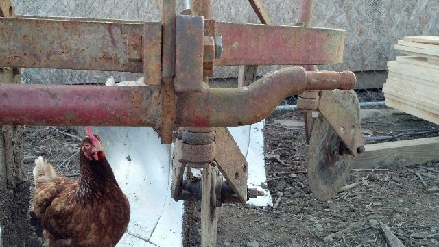

I am looking for bar that attaches to the lift arms on the 3point hitch for an international 309A plow. Mine snapped in half and I am fairly sure it isn't available from the oem anymore. So I need to find a used one or try to fabricate a new one.

I haven't fixed it yet but have a plow to use till I get it fixed. I'm hoping to get home early today and put it in the barn and see what I come up with. It isn't going to be a fun project but I hope it isn't too terrible.
I've considered welding it back together and adding braces but need to look it over closer first.

Probably could cut it back a little and get some bar stock to bring it back out provided it isn't a cast piece. Could also take some bar stock and plate to fan a new bar. Probably add some gussets at the stress points yo prevent the issue.

That is one of the options I'm considering. Will see after I put it inside and clean it up. I have a friend who may have a piece of steel the size I need so I just need to make time to work on it.

Thanks, you can see their both very similar. I still haven't made it home in time to get the plow in the barn and it has been raining the last three days by the time I do get home so I'm not working outside on it. I'll measure it up and if you can compare it to yours I would appreciate it.

The cross arm is roughly 26" long from where the lift arms attach ( about 31" overall). It is about 1¾" diameter through the frame.
