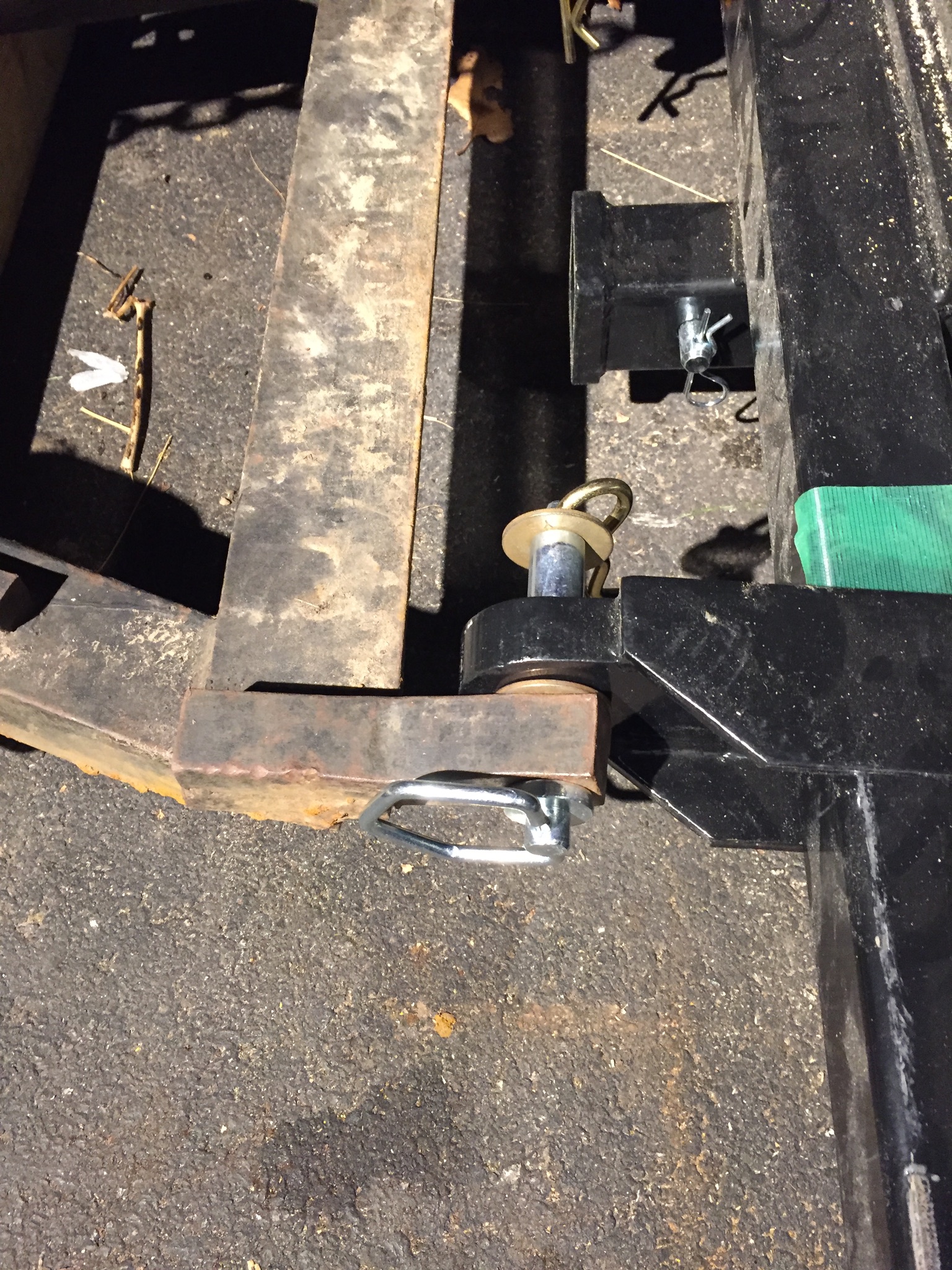

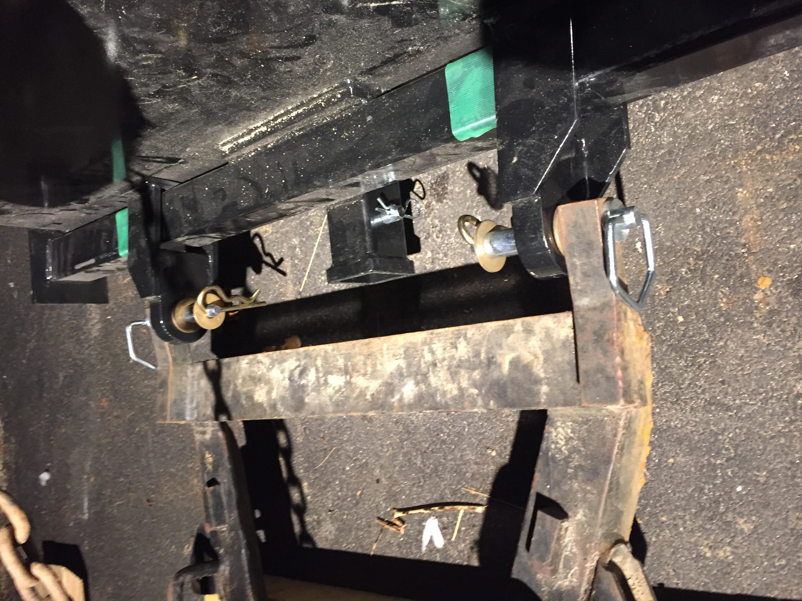

So I gave some more thought to bushings & Various sizes and came up with this. The green tape is just marking the location of the floating 3 point mounts that I need to drill thru and pin to keep plow from sliding on bar (left to right ). Tractor supply came thru ...collar bushings with Allen set screws fit perfect inside 3 pt 1-1/8” bore , then grade 8 washers, and a couple sleeve bushings with more grade 8 washes to keep pin stable ... more pics tomorrow ... CA693B49-133B-4B09-8F92-ECCB72A1C388.jpeg5002DDCA-50F3-43C3-8709-BF71A764797B.jpeg

55AAAA08-50DF-40F0-ADF9-846A7E2A0710.jpeg9B43AED8-C75B-489A-B849-9D867893940F.jpegEB76D04C-93BB-4F78-80FD-9C1C947696F8.jpeg
More pics of attachment configuration...

Did the Titan 3 point adaptor quick attach plate fit the plow that perfectly stock, or did you custom order it to fit the plow A frame?

The titan Qa plate has adjustable lower 3 point brackets that slide left to right... I have to drill & pin with hitch pins to keep it centered... they don’t offer any specific Qa plate to match a plow that I am aware of.... becomes a matter of how mechanically inclined you are to see the way to adapt / configure something to something else

Apparently that's what Drewmon did to his QA. Drilled holes and installed hitch pins to keep it centered. Wish I'd have seen that hitch before. It would have saved me a lot of welding and fab time building mine.

Me too, but I paid $125 for the QA plate and welded the mounts on for free. So I saved $150. I'll take those savings and use the money for something else for the tractor!
