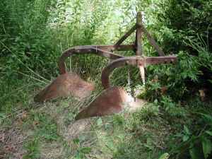

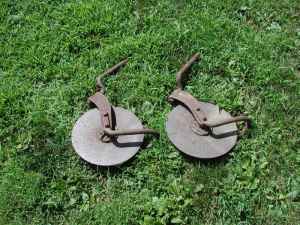

I too am looking for a decent used plow to use in reclaiming about 10 acres of former farm fields from invasive species and preparing to grow hay. The land has already been mowed. Based on this an other recent TBN threads I've been looking for a Ford 101. That plow appears elusive at least in my initial searches. I did come across a local Ferguson 12B with coulters and wonder if anyone has experience and comments on that plow's performance and availability of parts. I'd be using a 40hp tractor and the soil is mostly sandy loam with a fair number of rocks. Probably would only plow 4-5 acres per year.

SouthernX,
Farmwithjunk meant the wear parts are interchangeable with the Fords. The frame the holds them is nothing like the Fords though, and any slight angle difference will make a plow pull different. I have an old 2 bottom Ford plow that never did pull easily for me. Could be caused by a tweaked or bent frame. It has coulters and new wear parts, but still pulls very hard. My dad got tired of it so I found him a used TSC style single bottom. It has no coulter, and he doesn't even adjust it properly, but that thing rolls the sod better than the Ford. I just reworked a Ford 101 that I'm waiting to try this spring, and I expect that to be best for me. The bottom line is, some of the older plows could be messed up and a Leinbach would be better (if it fits your tractor).
