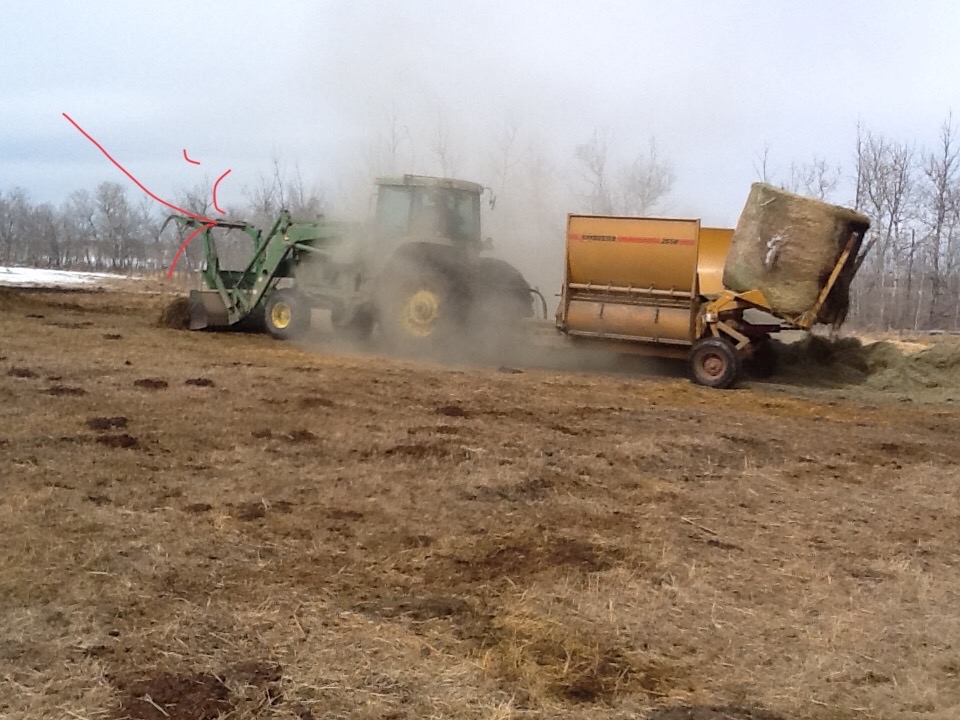

Feeding the cattle used to be done with a hay rack, pitch fork and a team of horses. Now!
