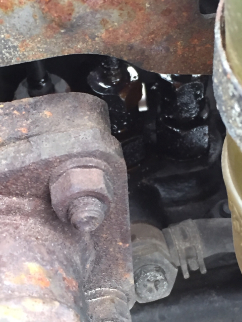

Just seen there is fuel coming out of 2 of the 3 lines coming out of the pump. They are tight any clues of the cause ? ImageUploadedByTapatalk1452714614.803268.jpg

is the sealing part deformed? i dont think this is why it would not start though?

It was low 30s. I guess it could have been doing that earlier. I have it in the garage now will be going out soon to see what is wrong with it.

That about when it died but it got probably 5 over the night

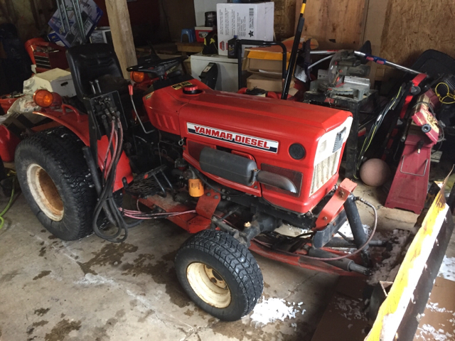

Got the Yanmar back together. Had to bleed the whole system. She fired up and went and plowed my huge driveway and it did great. I am loving this tractor.

Sure will! The fuel lines are not leaking any more either.
