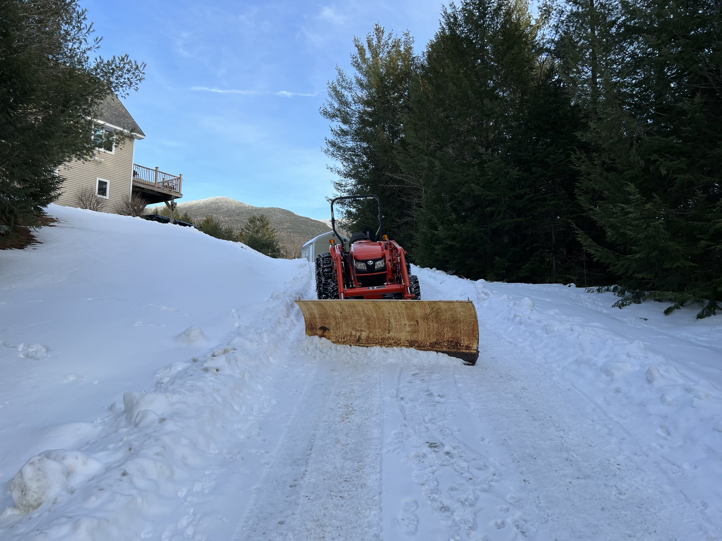

I’ve been trying to get ahold of a plow for my driveway as I’ve been using the bucket and it takes forever. I finally got one last weekend and got all the hydraulics and everything set up for this storm that the northeast was hit with the last couple of days. Anyways I took my first pass down the driveway and it worked awesome! Second pass I was pushing the snow bank at the bottom of my first hill back and the tractor disconnected from the skid steer plate and blew a hydraulic line. I guess maybe too much power mixed with the heavy wet snow? The skid steer plate is all bent up so I can’t connect the tractor back onto it. It hooked back up to the bucket just fine so I don’t think it messed anything up on the tractor.
Anyone have any similar stories? Also, I was going to try and straighten the skid steer plate and maybe weld some channel on it to beef it up and give it a little support? I was trying to get an inexpensive plow setup but it totally backfired. I guess you get what you pay for.
Picture pre storm before I bent it and my ridiculous truck/trailer setup I picked up the plow with.

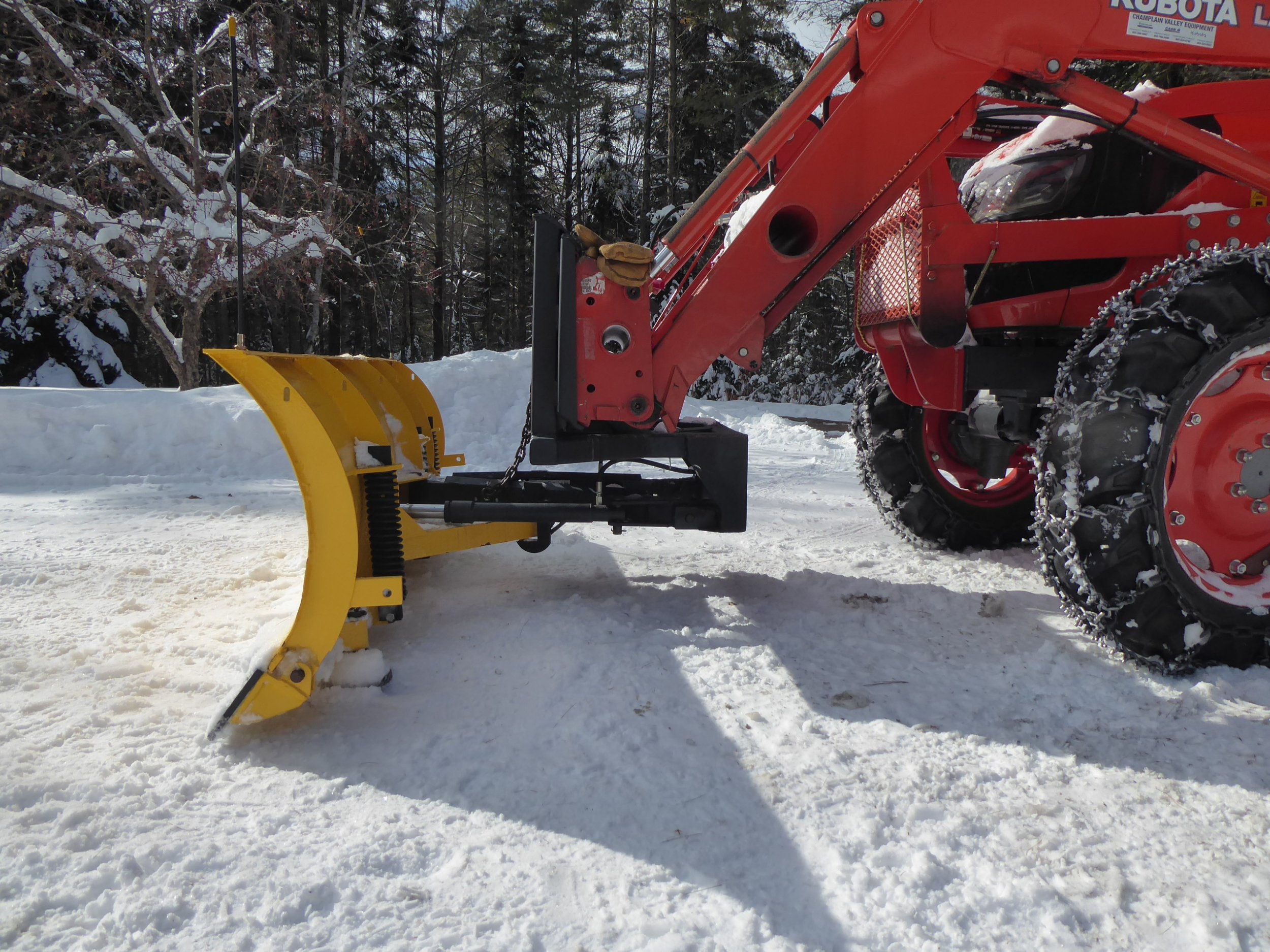

We need some pictures of what's going on with the tractor and plow during hookup. The plow looks like a home brew and some of the ssqa plates have a little sloppy fit. I'd imagine that DK35vince is right and somehow it got disconnected on one side and probably bent the other.

Looks like a truck plow not a tractor plow.
So what homebrew method did you come up with to attach to the tractor? Pictures of whats going on is needed.
As to a hydraulic hose blowing.....what hose blew, and what was the position of the plow when it blew?
Truck plows have what is known as a crossover valve, or double pilot check valve (DPCV). This is to protect the hose/cylinder on the extended side of the blade. Because if you try and push too hard......the plow becomes a big lever acting on the cylinder full of oil (just like the long handle pumping a small piston on a floor jack). If you exceed the pressure rating of the hose....it blows.

My guess is that he used a rigid top link instead of a chain and / or disabled the trip springs. Something had to give, so maybe....
I us a former Western truck plow without any problems. If I snag an edge of a rock, it trips or bounces upwards. The chain acts as a 1 way float.
I have also seen a LOT of new QA plates at local auctions that are less than 1/4" plate. When I decided to convert my JD 80 loader to QA, I went with the JD QA system with cast steel hinge brackets, then made a Rube frame from 1/4" square tube and spherical joints to marry the truck mount to this frame. Chain upper 'link'.

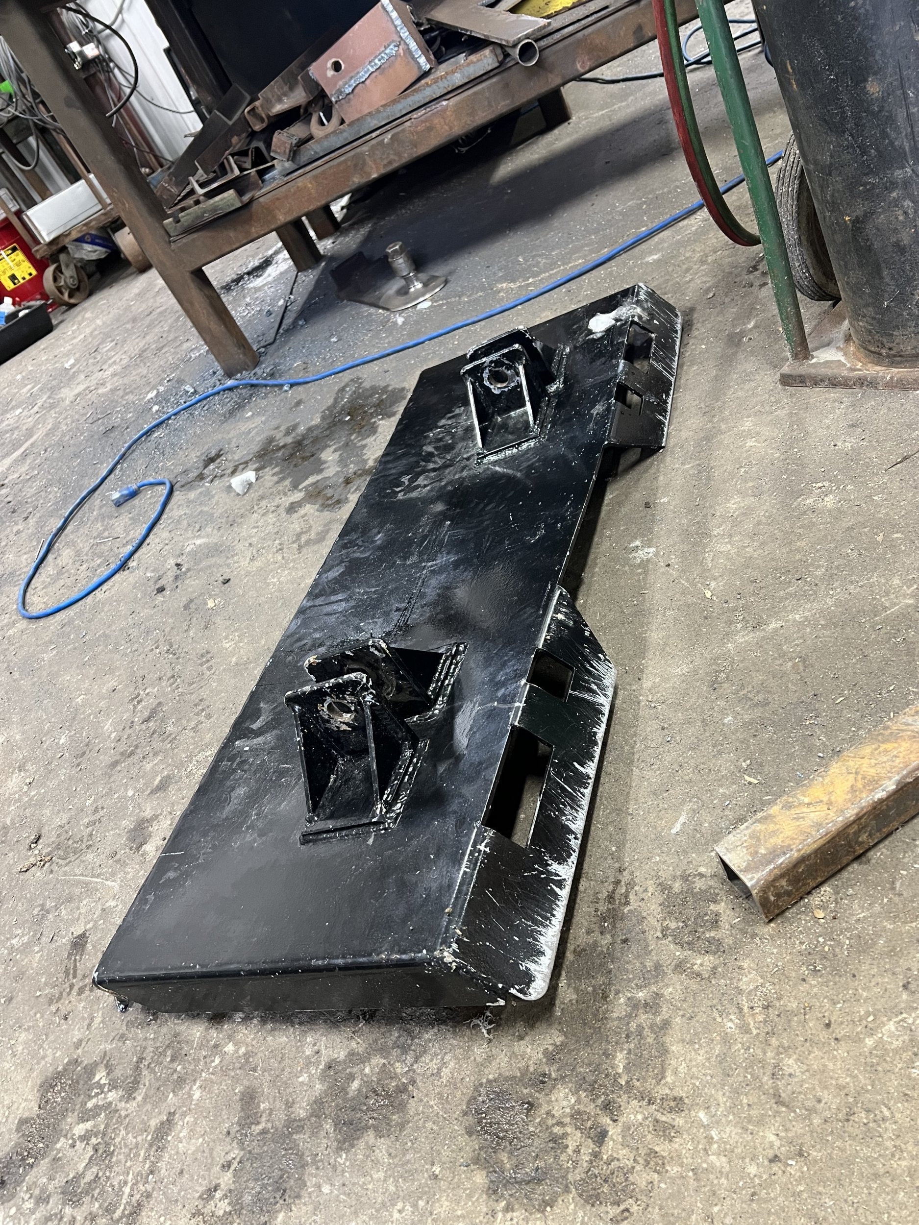

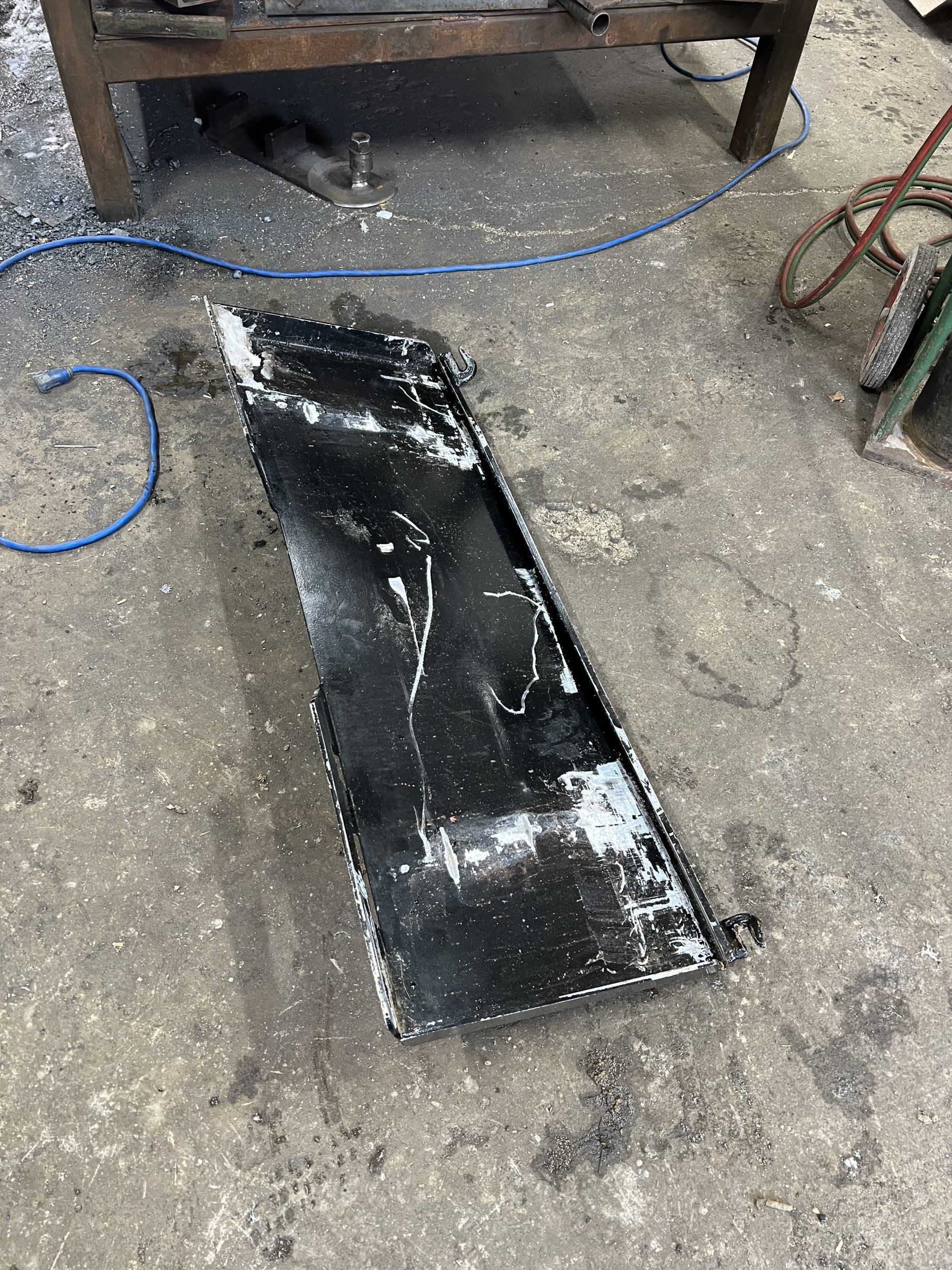

As far as the ssqa plate being bent, some pictures are worth 1k words.
   / Plowing Mishap
Here are some pictures of the plate and the plow. You can see in one of the pictures how much of a gap there is to the floor. I think what happened is there was so much pressure when I was pushing the snow bank back, that the plate gave out. It fit just fine when I first hooked it up but the plate itself is only 1/4” so it was a little too flimsy for what I was trying to do. I guess you could call it operator error as I shouldn’t have been ramming the snow bank back. It was a titan attachment quick attach plate. No top link, I was just using chains. I misspoke when I said I blew a hydraulic line, after the plate bent and the plow dropped off the tractor, a 90 I had going into a flow valve on the plow cylinder, broke off. I just took the 90 off and went straight into the cylinder so that was no problem.
