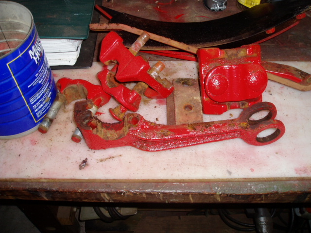

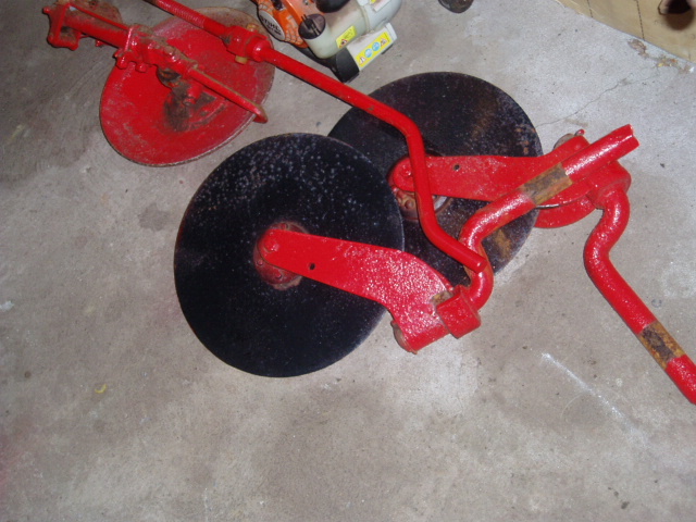

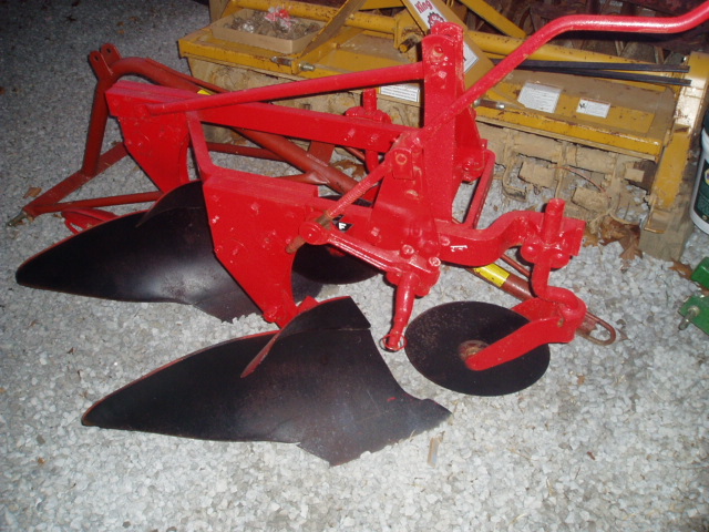

Here we go! Today is the first day of my plow rebuild. It's a worn down and worn out Massey Ferguson model #66, 2X14", saftey trip beam plow. They were built starting in the mid 1950's, and continued in production until the early 70's. Tons of them sold with 35's and 135's.
I'm going to update the thread every few days. I've stripped the plow down to an almost bare frame. Tomorrow a few more parts come off. Then the sandblaster. Primer and one good coat of red paint later, we'll put 'er back together, using all new wear parts. As I install each, I'll identify each part by name. After the plow is back together, one last shot of red paint, then new decals. Then the REAL fun starts. We'll go through the process of "set-up" and final adjustments. If we get weather like last year, the new plow might even see some dirt in mid Feb.
OK, Pic #1 is the plow as I bought it. Don't let the paint fool you. This thing is slap WORN OUT. Landslides have holes all the way through. Shins are worn so bad there's some wear on the frog. Moldboards are worn to razor edges in a couple places. I'd guess it plowed 75 or 100 acres AFTER it was worn out.
Pic #2 is the semi-stripped frame. I'm pulling the frogs tomorrow before sandblasting. (Frog is the rusty part at the end of the trip shanks. Frogs hold everything together. They're the backbone of a plow bottom.
pic # 3 and #4 are all the small parts that need hours of cleaning, painting, assembley, and adjustment.

I bought a cheap/small sandblasting outfit last summer. This will be the first time I've used this one. There's not a lot to be cleaned. A great deal of the plow will actually be replaced with new parts.
Weather guessers calling for 2 days of rain starting tomorrow. That could slow me down. Sandblasting has to take place outside.
First parts arrived today. Well, let me correct that. First BOX arrived today. Ups brought a box with one side ripped out and no "product" inside. Fortunately, Agri-Supply was sympathetic. They'll send me another part and they'll deal with Ups.
Some parts from Agri-Supply. SOme from Valu-Bilt. A few from AGCO. Bolts by way of TSC. It looks like cost to replace all wear parts will exceed $225 per bottom.

Not much to report on. Sandblasting in the rain doesn't sound fun enough to try, so that plan bit the dust. I started scraping dirt and loose paint off the frame. In less than 10 minutes, had a chunk of rust in the right eye. Wife's a nurse. I'm cured now. No plans to do any more tonight.
UPS dropped off 4 boxes of parts. Moldboards from Valu-Bilt. Shares from Agri-Supply. Bolts from a local vendor I buy from at work. Decals and coulter bearings from AGCO dealer. Still missing 2 landslides, just ordered yesterday. Valu-Bilt again.
Note the fact that "wear parts" are coming from 2 sources. Reason why, no one supplier has ALL the parts. And 14" Massey plow shares are almost a thing of he past. (Fortunately, the "frog" on a Massey plow is the same, be it 12", 14", or 16". Shares all bolt up the same. I'm cutting down a pair of 16" shares) Point is, even with a fairly popular plow like ANY Massey Ferguson 3-point plow, parts are getting "iffy".

When you go to buy shares for the Massey 14", all you'll find are what Massey called "clipped wing" shares...... A 12" share on a 14" bottom. It works apparently, but not quite to my liking. 16" shares are still easy to get. Same bolt pattern. Cut 2-1/4" off "back end" and you have a standard 14" share.
Where things get tricky is when you start trying to replace landslides. Not much available. What is available isn't quite the same as what came on the plows originally. Aftermarket companies make it "CHEAP". The original "front" landslides aren't available at all. But there's still plenty rear landslides to be had. (longer to accomodate a tail wheel) They can be cut down also.
Your model #82's are borderline, but the 880 should still have parts availability through AGCO.
On cost, all I can do is add everything and divide by 2 on this project. Looking like $280 to $300 per bottom by the time I'm done. Shipping is a healthy part of the total.
